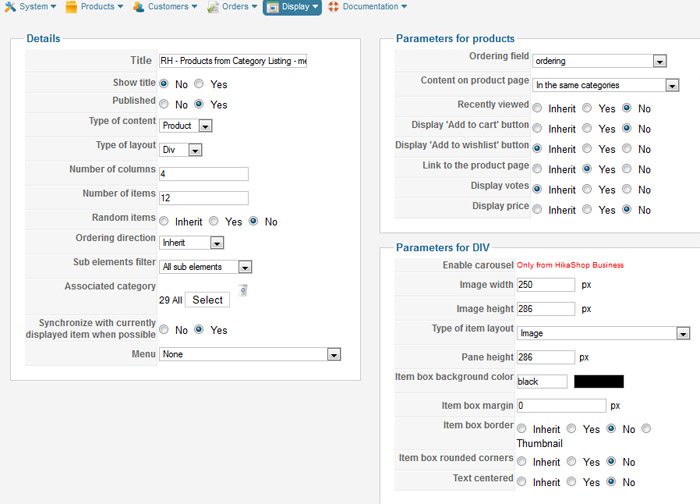

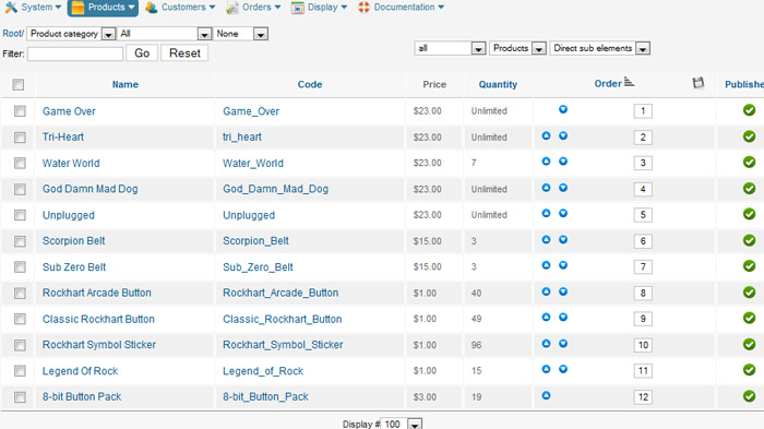

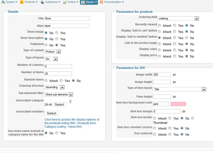

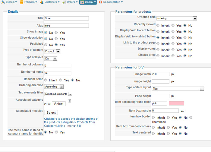

Please go in the menu Display->Content menus and edit the menu with the id 154. There, check that the ordering is correct and if that's the case, please give a screenshot of the options and a screenshot of the products listing of one of your categories on the backend.
  • Posts: 35
13 years 9 months ago #77635

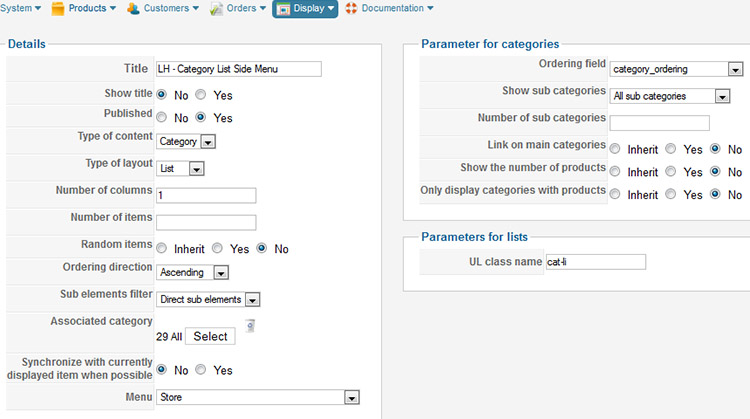

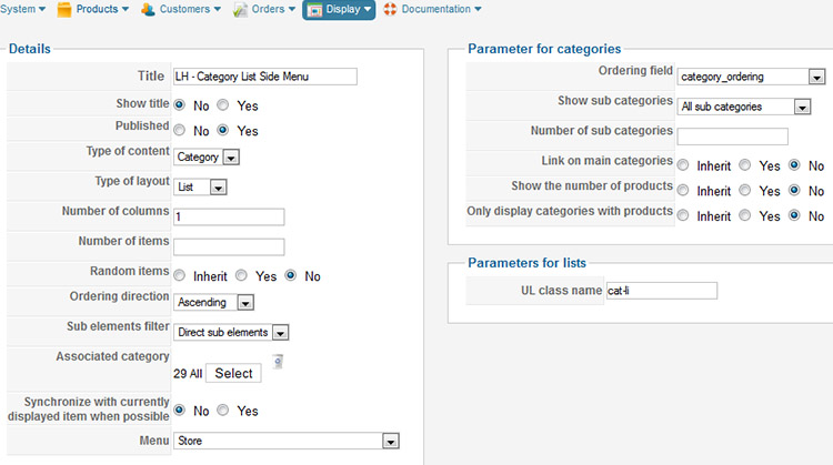

The ordering options are as you say. Here are the screenshots. I also attached the right side product module and the left side category list module (even though the category menu seems to work correctly, just not with the correct product ordering).

Is there the configuration of your module 111 in your screenshots ?
  • Posts: 35
13 years 9 months ago #77763
Yes. It is the "RH Products from Category Listing", second one down. Sorry, I renamed them in an effort to help me keep track of all the features I am trying to learn.
"LH - Category List Side Menu" is 112.
  • Posts: 26385
  • Thank you received: 4077
13 years 9 months ago #77822
Regarding the source code of your page, the module 111 is used.
You can find a div which have the id "hikashop_category_information_module_111". It means that you have a "category" module with the id 111, and this module is used by the page for displaying the product and this module contains the listing options.
  • Posts: 35
13 years 9 months ago #77832
Thank you, yes, I know this. That is what the screenshots show. However, even with the correct settings for this module, the items do not show in the order set (shown in the third screenshot). Obviously I am missing something, but cannot figure it out no matter what I change.
