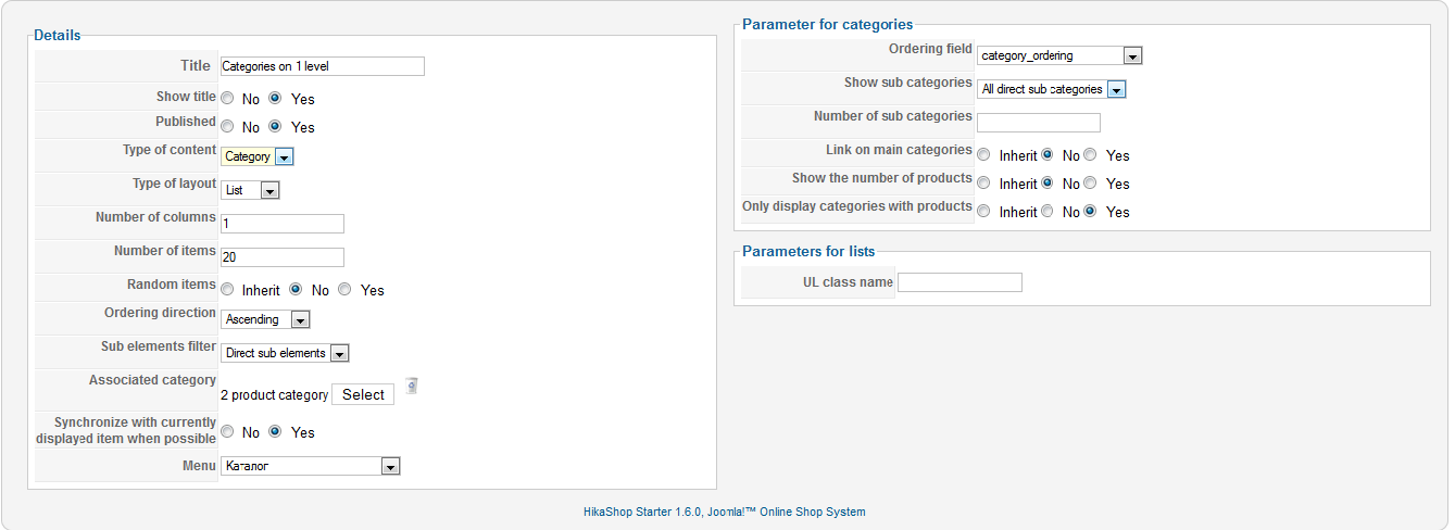

Well. Just to provide you with more information.
I have 6 categories in the main catalogue (domain.com/catalogue). And I want only this six to be displayed in the main catalogue. I created more categories (additive, not main ones, for the sake of better navigation) which are planned to be displayed only in the "categories on 1 level" module. So, when this additive categories are published they are displayed both in the module and in the catalogue. When unpublished - they are displayed neither in the catalogue nor in the module.
Here's the screenshots of the module settings.

  • Posts: 26386
  • Thank you received: 4078
13 years 9 months ago #77333
A unpublished category is hidden but it could be used by modules to display his content. But you have to select this category, not his parent.
If you don't want to display the subcategories, you have to change the option "show sub categories".
