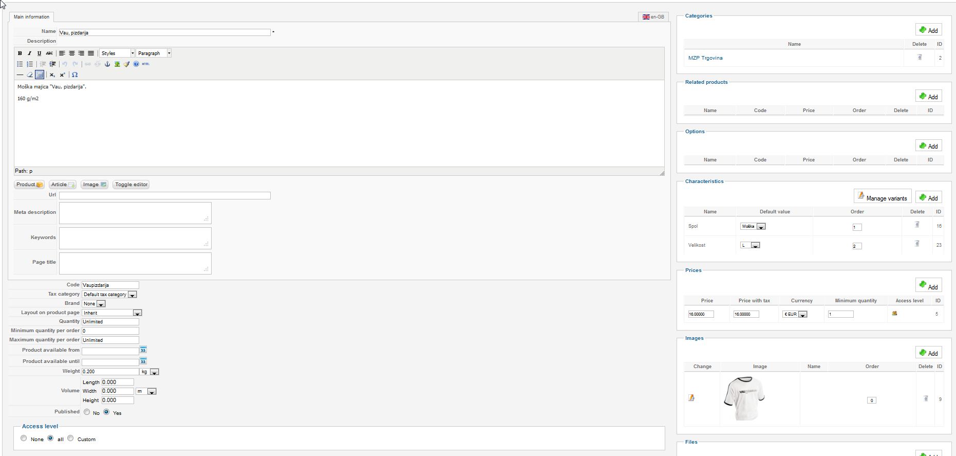

Can you post a screenshot of your manual shipping configuration ?
  • Posts: 6
13 years 9 months ago #77409
Hi Jerome,
here's the screenshot:
Click to view higher-resolution

13 years 9 months ago #77554
Your products does not have a weight.
The problem is that, your main product have one but not your variants.
HikaShop use the weight of your variants so, it took the "0.000kg" weight.
I have change the weight of several variants and it works.
