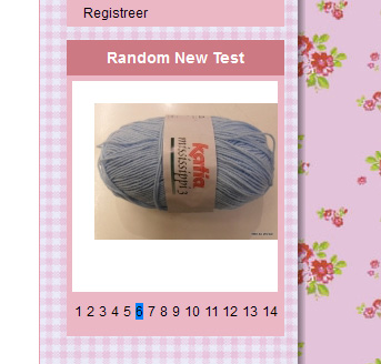

Would be great if you could develop a standard module which can be placed left, right or anywhere else showing the latest products, say added the last week or any other periode.
Or something the same for popular products.
What I mean is something like here: http://www.1968dewinkel.nl/producten
I used the content module with the caroussel effect.
But there are a few problems here:
1) content is rather messy, would be nice if only the images are scaled and cropped to a square (or other fixed dimensions). In this example a part of the product page, the white border is also shown but not needed really here. I assume that could be fixed in the product caroussel view but that will have effects on other caroussels as well.
2) the link to the product page is working but I have set up a breadcrumbs module above the product pages. In case of following the link from the caroussel the breacrumbs module is not loaded above the product page. From other links the breadcrumb module is always visible.
Last edit: 13 years 9 months ago by didero.
13 years 9 months ago #77865
For the first point the problem is maybe due to your template. On my end when I set this carousel there is no border, the images are centered.
You can certainly fix it by CSS, applying a property based on your module id. For example: .hikashop_module_123 .hikashop_product_image{ margin: auto;}
In your module setup, do you have attached a menu on this module ? If you select a menu on which the breadcrumbs is displayed, so it will be displayed after a redirection from this module.
