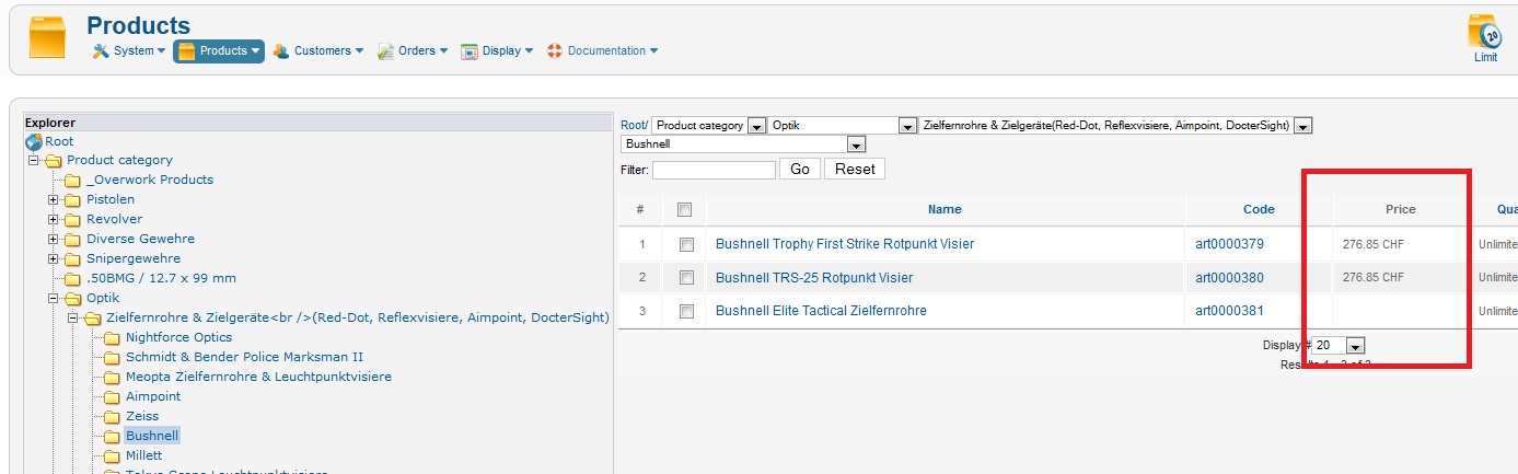

Is there a way to display price with tax in product explorer backend? Currently price w/o tax is displayed which is clunky for our need and my stuff is complaining a lot about it.
Thanks,
Karol

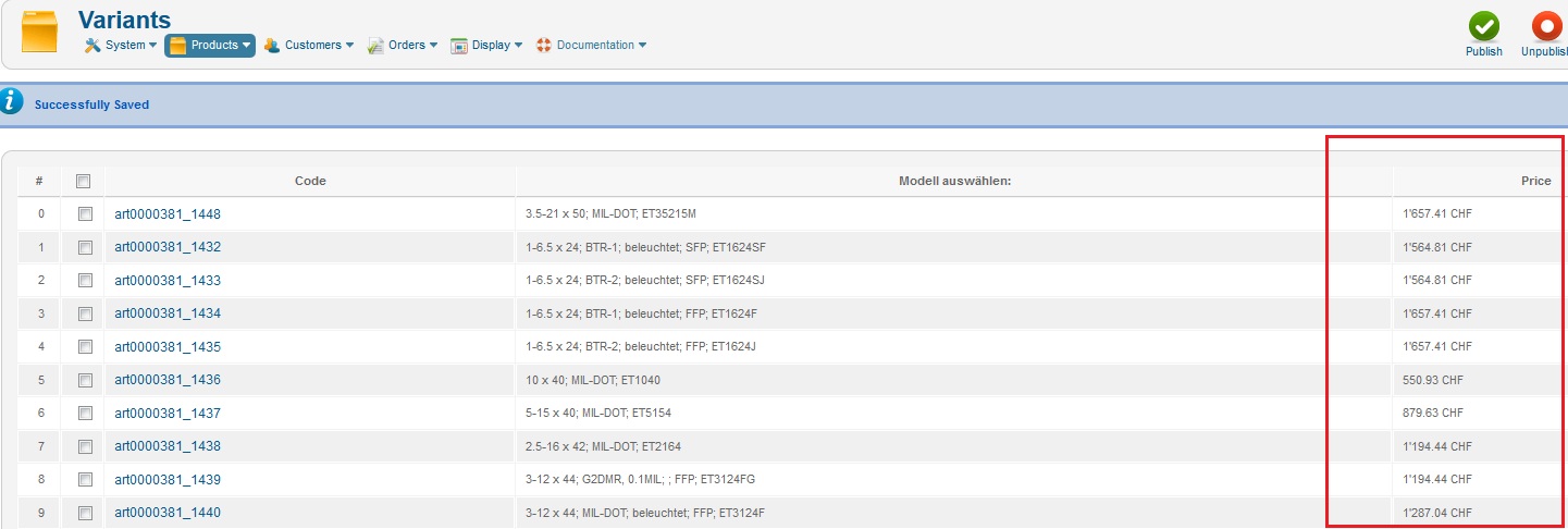

13 years 9 months ago #78952
Hello there
I replaced the following Code in the file "Back end / product / listing" from Backend:
<td>
   <?php echo $this->currencyHelper->displayPrices(@$row->prices); ?>
</td>
and just replaced this line with "888" to test, if there is a change in the backend:
<td>
   888
</td>
But it seems, that nothing happens (see Screenshot).
I don't know, where the problem may be...
I recently updated to HikaShop 2.0.0, but I don't know, if this is the problem (I don't think this is a problem).
Joomla is 2.5.8
Best regards
Mike

<?php } ?>
<?php } ?>
I have here the price replaced with 8888!
Still no change in the product overview tables in the backend!
It's the following link that it opens:
www.waffenmarti.ch/shop/administrator/in...|product|listing.php
allrounder-j1.6 is my template
Last edit: 13 years 9 months ago by mike.

Prices are not preloaded on these pages like on the product listing, so it's more complex to do.
Also, with next version of HikaShop during summer, the product edition page will be completely redone so I wouldn't recommend to do it, at least not until then.
