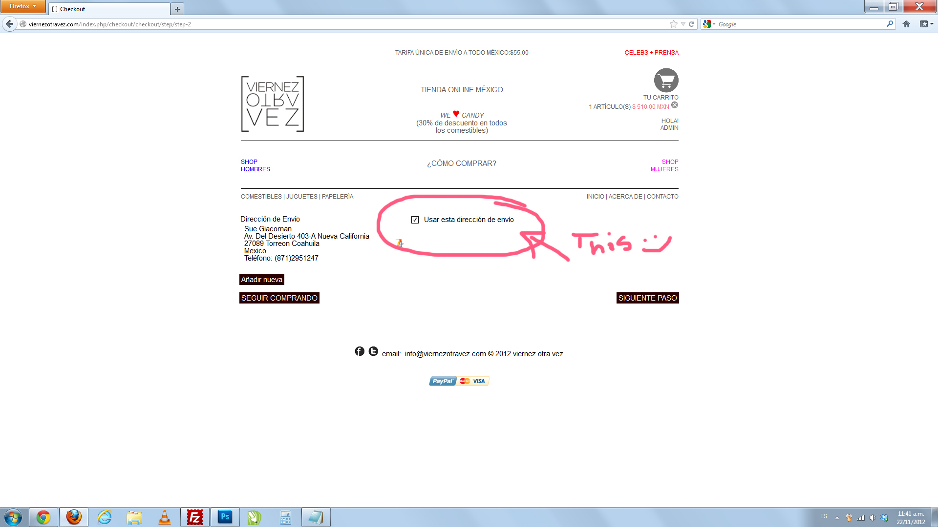

How i can remove the "invoice select box" that appear on the right side of the address checkout form?
My client said that he really dont want to offer invoices, thank you!

Invoice ?
This box is the "use billing address as shipping address".
You can hide it by modifying the view "checkout | address", removing the right part and changing the checkbox as hidden box.
Or you can add a CSS rule in order to hide the div block which have the id "hikashop_checkout_address_right_part".

Thank you! Is exactly what i need, to hide that part, i have in this moment the css file and i am looking at it, but i dont know how to write that css rule, (i dont know css code... i know, is crazy but true. I am still learning), could you help me?
  • Posts: 103
13 years 9 months ago #78252
Yupiiiiii i did it! Im sorry it was really something very simple, i feel super stupid! Anyway, i am going to put here the solution. In the css file of the frontend, search hikashop_checkout_address_right_part, and just add "display:none;", it would look like this:
.hikashop_checkout_address_right_part{
display:none;
