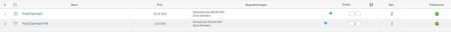

Ive searched this forum for an answer to my problem, without succes. So i hope someone can help me.
I have setup 2 manual shipping rates. But only 1 shows. I want my 2 rates like this:
1) If a custumor order for less then 500, they are charged 25 for shipping (this shows)
2) If a custumor order for more then 500 its free shipping (this dosent show)
I would guess the system should choose the right shipping by its self?
I know the image showen below is in danish, but hopefully it helps.
Lars

Hi Jerome.
See the problem is that its stays with payment of 25, even if your order is more then the 500. Instead it should be free of charge, becaurse the total amount of the order is more then 500.

Do you have enabled the option "include virtual price" in the shipping configuration ?
-No i didnt have that. But i enabked it, and now it works :-)
Thanks alot.
