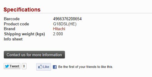

Hi, I have modified the show_block_custom_main product view to give me a table of products specifications as shown in the attached pic, however when I click on the product's Brand I get taken to a blank page. At some point I deleted the Brands Listing Module that was created when I installed Hikashop. My problem is I can't see how to recreate this module or get the brand hyperlink to correctly show all the products in that brand.
Any help would be enormously appreciated!
this is the code of my show_block_custom_main and I have set the switch "Display the manufacturer" to no (so that it does not duplicate)

  • Posts: 26384
  • Thank you received: 4077
13 years 9 months ago #78701
Brand listing is a classical category listing.
You can re-create it by making a new HikaShop category listing menu.
The main difference is the "type of content" which is "Brand" and not "Category" (in the HikaShop content menu part).
