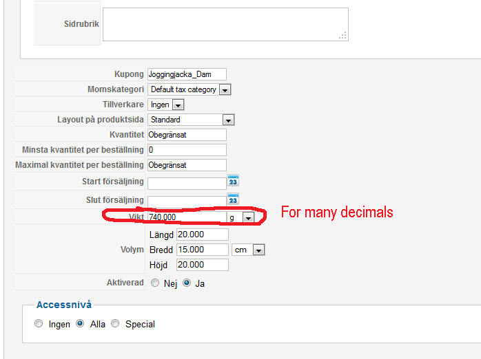

Seems as if the weight is made up of 5 digits, it works, but it will be 6 or more it will not work!
  • Posts: 25
13 years 9 months ago #79514
How on earth do you change the number of decimals in the product weight.
If you use 5 digits it works, but you use 6 or more it will not work, must surely be a solution otherwise the system inoperative, for our part!

I've tried to explain it before, will try again.
The product you put in, weighs 40g, it's ok.
Try to increase the weight to 240g or 1270g as an example and you'll see what I mean, because the shipping cost is not shown in these cases.
  • Posts: 25
13 years 9 months ago #79565
Discovered now, do I add a new product, it works, but I change the weight of existing products, it will not work.
