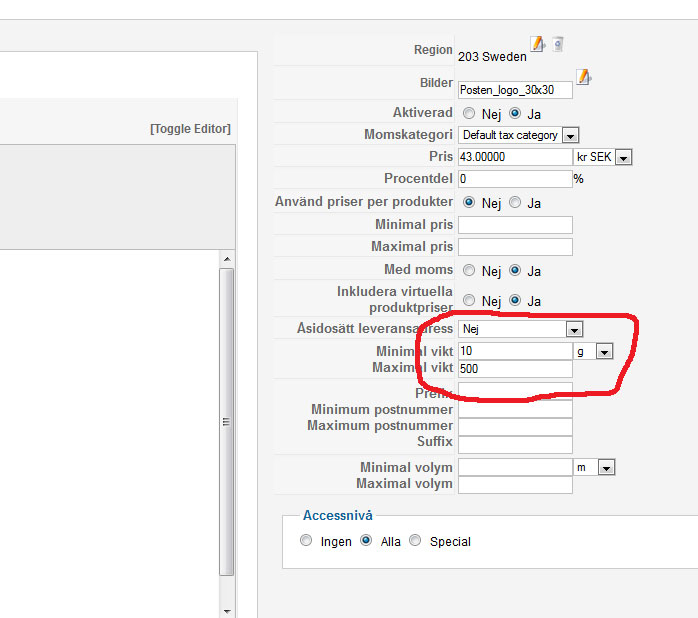

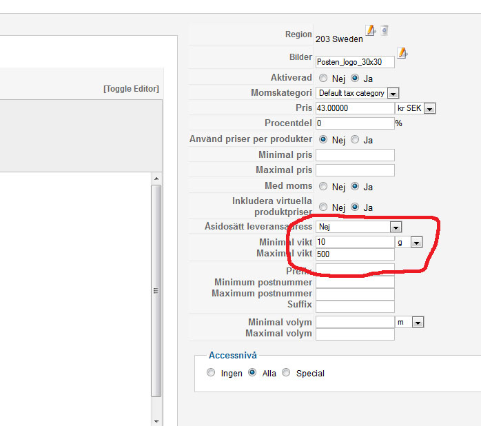

13 years 9 months ago #78864
The Manual Shipping Weight If i Understand it goes
Go to Maunual Shipping click on it and create the following shipping methods
Standard Shipping 1
Min Weight: 0.1
Max Weight: 10g
Add Price in price field
Standard Shipping 2
Min Weight: 10.1
Max Weight: 500
Standard Shipping 3
Min Weight: 500.1
Max Weight: 1000
Standard Shipping 4
Min Weight: 1000.1
Max Weight: 2000
Ensure Manual Shipping Plugin is published and ensure all methods created are published

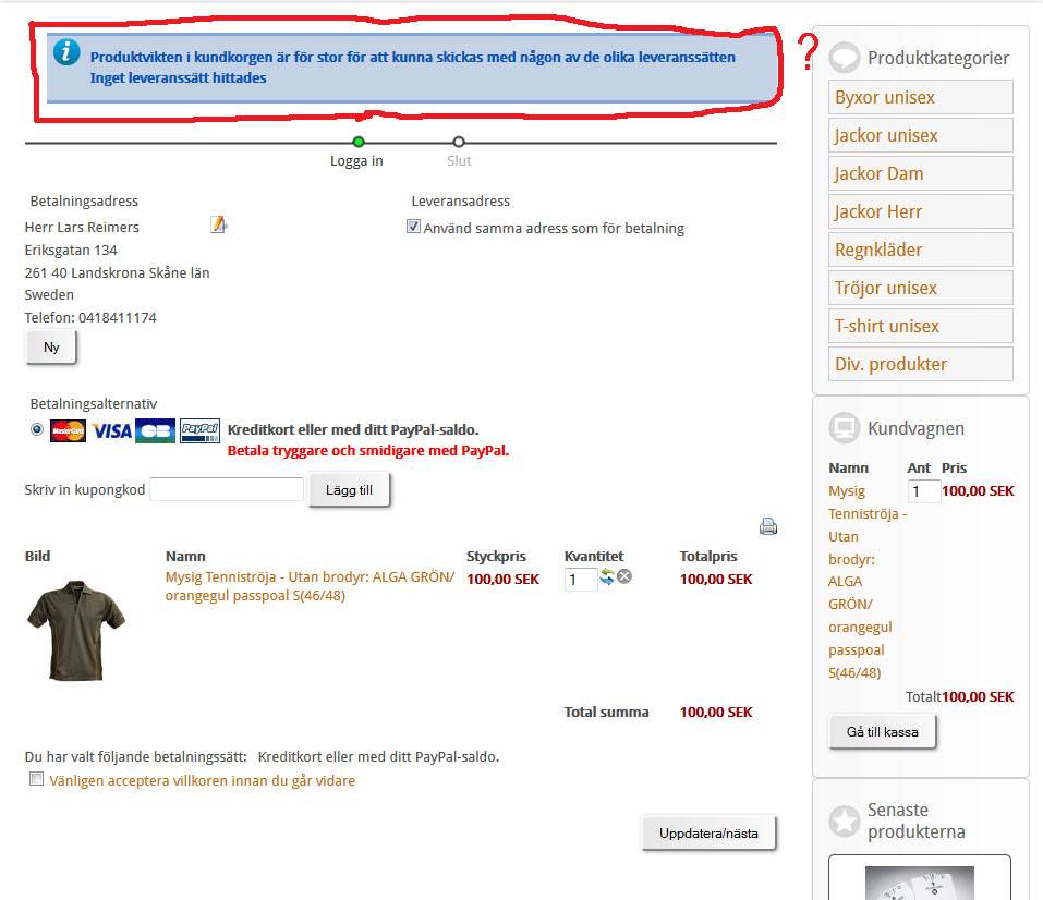

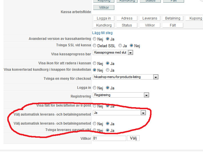

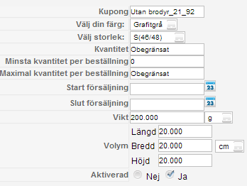

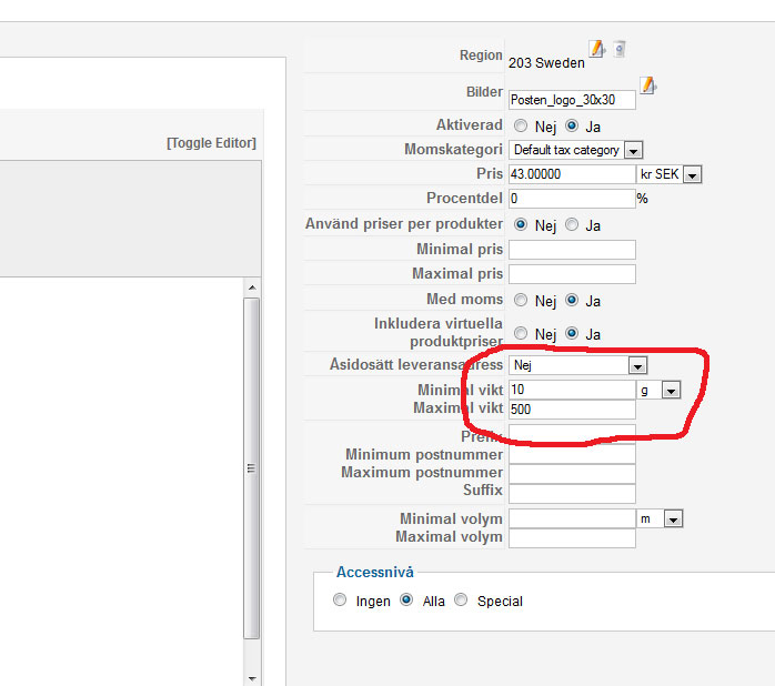

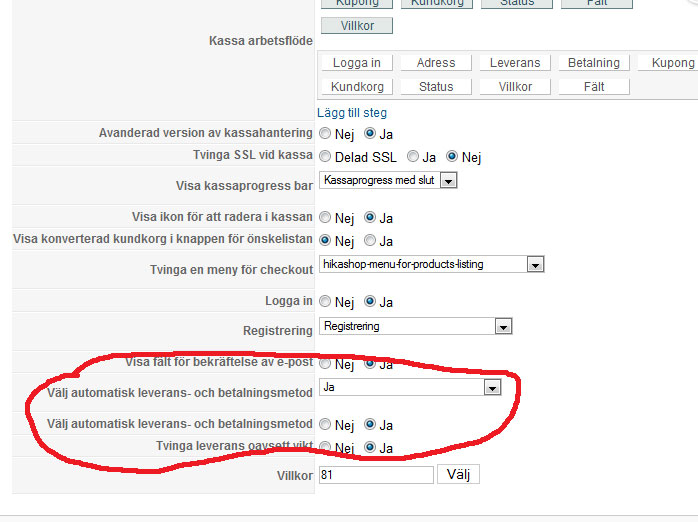

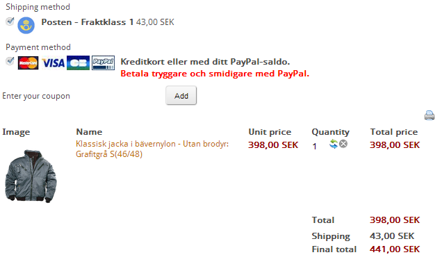

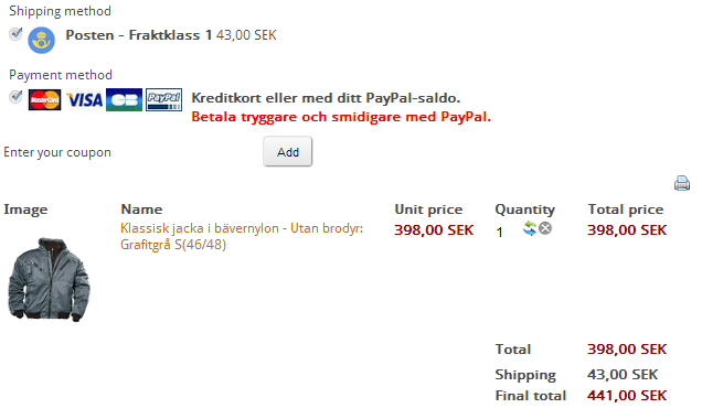

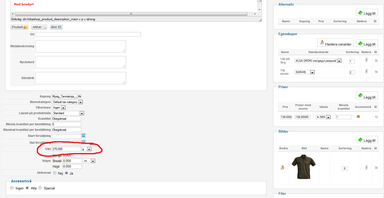

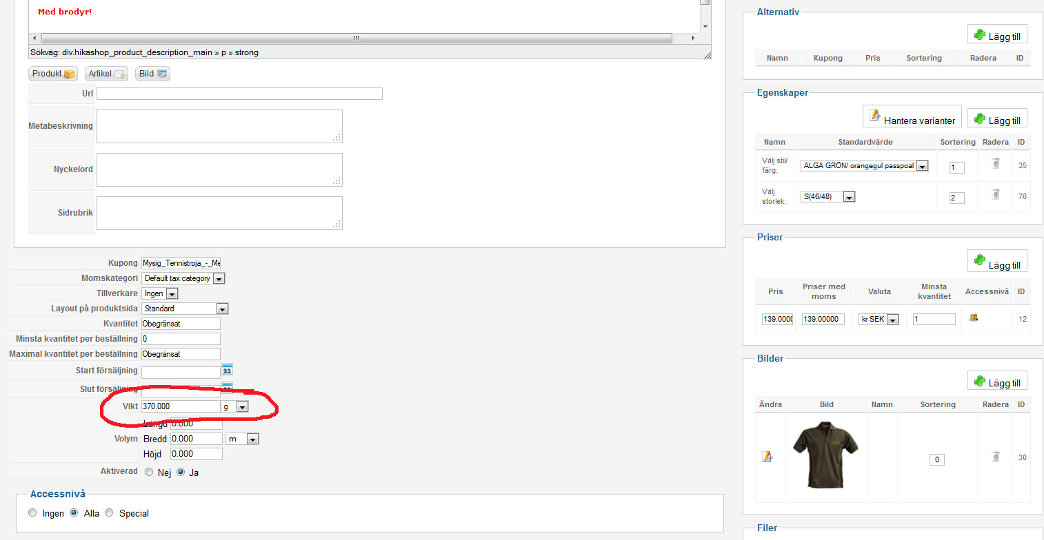

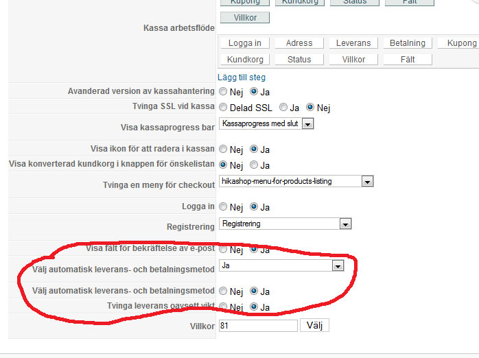

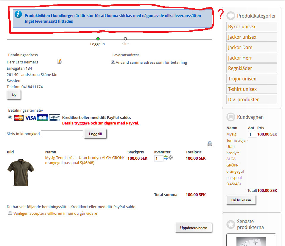

  • Posts: 25
13 years 9 months ago #79175
OK, some way I am now, but still the problem that I describe in the following screenshots.
Picture 1
"Product weight to the cart is too large to be sent by any of the various modes No delivery found"
Picture 2
"The weight configured as follows"
Picture 3
"And product weight like this"
Picture 4
"At checkout like this"
Someone who can see what is wrong?
Last edit: 13 years 9 months ago by Mallcom.

  • Posts: 81
  • Thank you received: 6
13 years 9 months ago #79216
Can you PM me the details
You have to remember when you set 1 i.e
10.01
500
and then after the next 1 must have a new amount i do +.01
So your next weight would be
500.01
lets say 1400
and then
1400.01
to lets say 1800
and then
1800.01
to lets say 2000
and so on and so on
You will notice the Minimum weight for each after the first shipping method has 0.1 you cannot have 1 method start lets say
0 - 10 g
then 10g - 20 g
It MUST be
0 - 10g
10.01 to 20g
20.01 to 40g
and so on and so on
I think this should fix your issue
Last edit: 13 years 9 months ago by foxy3433.
  • Posts: 81
13 years 9 months ago #79218
Please enter this
0-10gr = Free
10.01-500gr = 43: - SEK
500.01-1000gr = 63: - SEK
1000.01-2000gr = 93: - SEK
13 years 9 months ago #79242
The problem was coming from the fact that you didn't have set a weight and dimension to your products :
Then your shipping method should show :
  • Posts: 25
13 years 9 months ago #79260
Well in a product, I had entered the weight but not in the other products, this to test with one (1) product. However not done was to set the dimensions and volume, so you mean that you have to enter even these values​​?
Does it work then?
13 years 9 months ago #79264
Yes

  • Posts: 81
13 years 9 months ago #79448

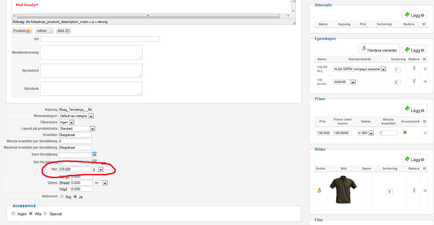

Right.....
Shipping weight is working i created a product add it to cart here
www.husbilskompisar.se/webshop/index.php...=checkout&Itemid=531
i set the weight for the product to 40g and i get the shipping cost £17, which is correct according to your weight band, i quickly changed the shipping weights to the correct formula also..
Please check Weight in Products and ensure the weight symbol is the same as you have shipping weight, plus i don't think you need the extra .000 on product weights as your shipping method does not have those extra decimal and .000
So you Product Joggingjacka Dam (Med brodyr)
Priced: 298
Weight: 740.00
i changed the weight to : 740 removing the .000 and the shipping cost shows on checkout
Add this product to your cart via this link: www.husbilskompisar.se/webshop/index.php...kout=1&product_id=25
Also can you chnage your password to another for your own security... Thank you
  • Posts: 25
13 years 9 months ago #79449
How on earth are you doing, when I enter 740 then automatically save it generated 740,000 can not get rid of these zeros.
