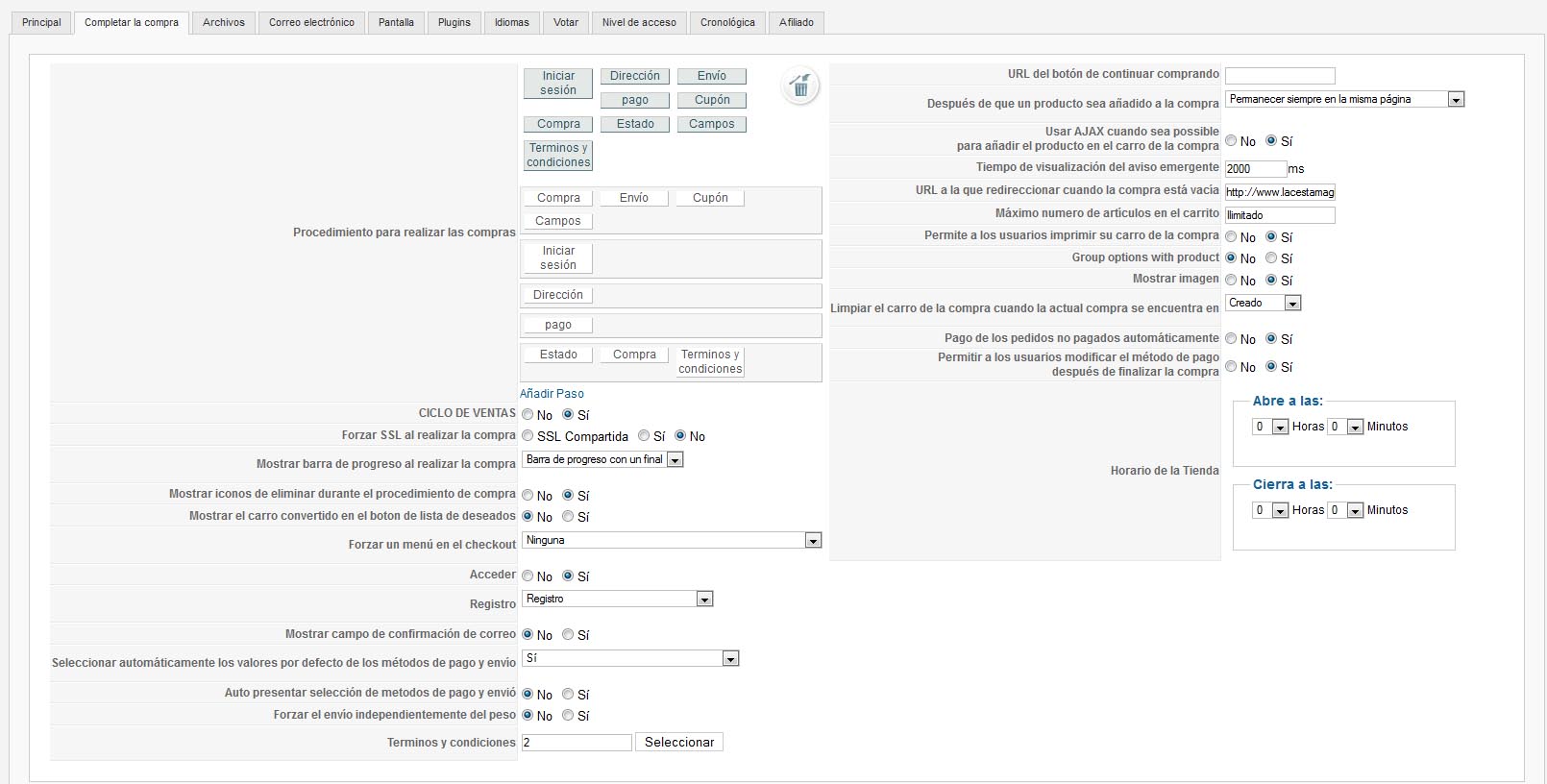

Ok, Can you show me a screenshot of your checkout workflow ("Hikashop->System->Configuration->Checkout") ?
  • Posts: 441
  • Thank you received: 24
13 years 9 months ago #79045
here you are
13 years 9 months ago #79053
Can you test it with "direccion" and "envio" in the same step ?
