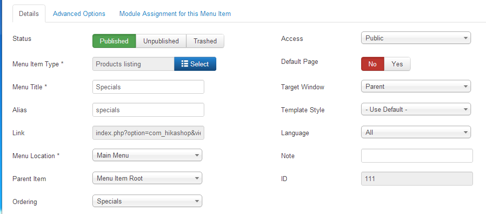

  • Posts: 22
13 years 9 months ago #79373

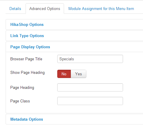

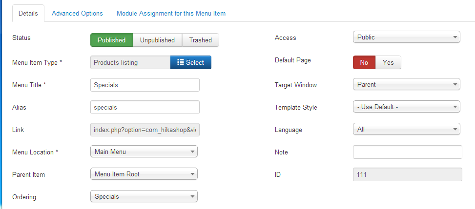

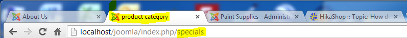

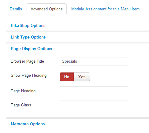

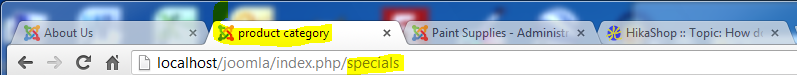

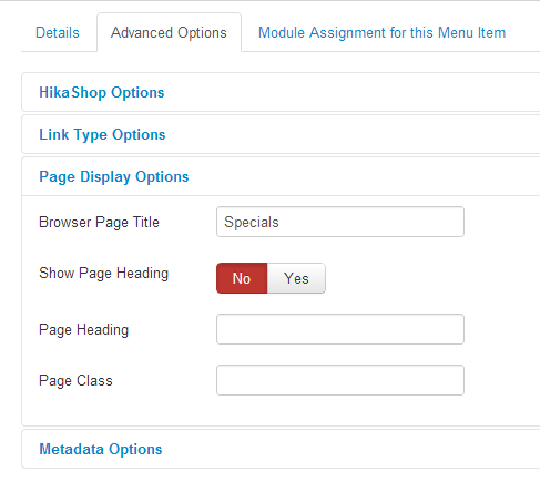

Here is a image of the problem
The address says Specials but as you can see the tab says product category
and these are the settings I am using in Joomla
13 years 9 months ago #79427
I think that I have found the solution, in HikaShop > Configuration > Display, enable the option "Use menu name instead of category name for the title".
This option is too present in you menus parameters in HikaShop > Display > Content menus.
  • Posts: 22
13 years 9 months ago #79540
That worked perfectly thank you :)
