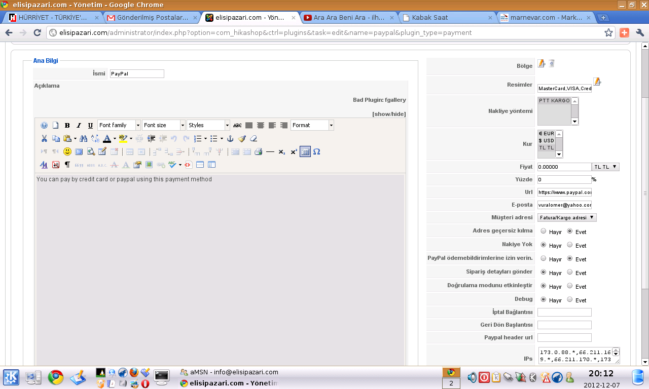

  • Posts: 182
13 years 9 months ago #80910
my paypal settings like this
  • Posts: 26384
  • Thank you received: 4077
13 years 9 months ago #80911
There is only the currency "TL" selected.
Please select all currencies (or none) in the currency list (using Ctrl or Alt key to add/remove a selection).

  • Posts: 182

  • Posts: 182
13 years 8 months ago #84929
ok now i did as TRY and showing PAYPAL payment section
