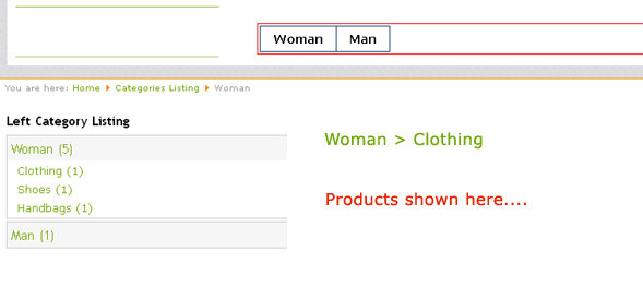

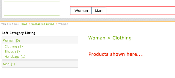

13 years 8 months ago #83489
If this doesn't clarify it then I will provide a link.
So, I'm using the "Categories on 2 levels" module. When I click on a category, I would like the category header to appear at the top of the page above the sub-categories.
Also, when I click on a sub-category I would like the sub-category header to appear above the products. Please see attached pic as an example.
I would like to be able to do this no matter what module I am using.
Thank in advance!!

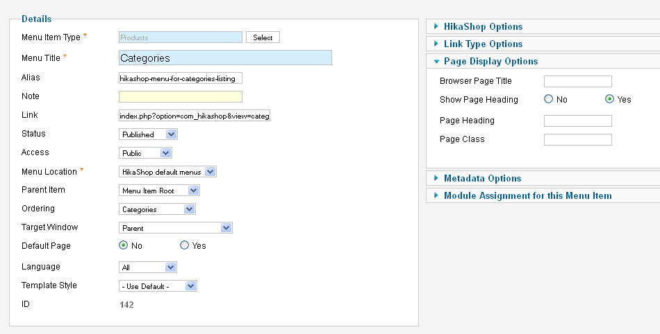

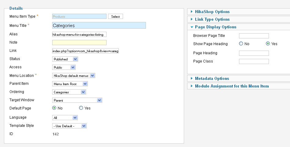

  • Posts: 966
  • Thank you received: 11
13 years 6 months ago #93363
When I turn on the heading all it says is "Categories" on all the pages. I wanted the heading for the page that the user is viewing to show. So, if I'm viewing "Women > Clothing" then the title would display as "Women > Clothing" or even just "Women" would be fine.
I'm not sure how else to explain this or maybe it's just me not getting it :( but I've tried everything that was suggested.
If it's not possible then I understand - but I just don't understand what I could be missing?
Please see attached where I made the change you suggested.
Thanks!!

  • Posts: 86112
  • Thank you received: 14210
13 years 6 months ago #93483
Ok. That's normal. Go in the HikaShop options of that menu and toggle the option "Use menu name instead of category name for the title" and the title will change based on the category you are in instead of displaying always the menu title.
