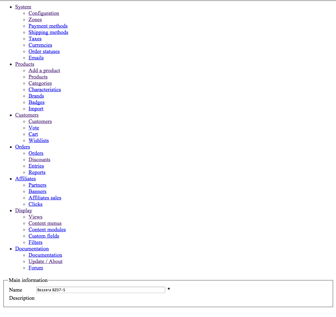

We have upgraded to Joomla 2.5.8 and Hikashop 2 business edition.

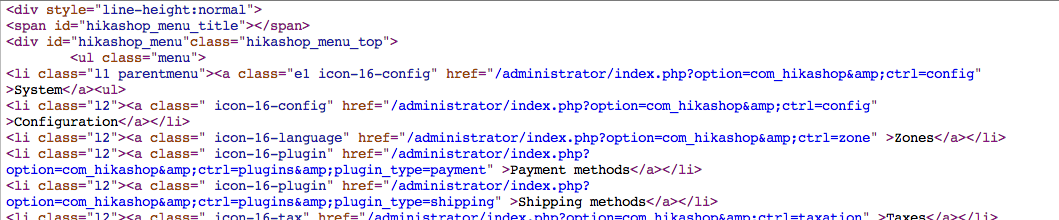

All seems to be working well. However in the back-end we cannot edit or add products. If we try this we receive an html fragment, as though routing has not succeeded.
So, this url will produce some html, but no header, footer and hikashop product editor :
administrator/index.php?option=com_hikashop&ctrl=product&task=edit&cid[]=199
Can you please suggest what we should be looking for ? This was working in Joomla 2.5.4 / Hikashop 1.6

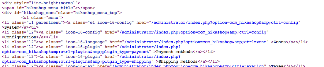

Some debugging gave :
Fatal error: Call to undefined method stdClass::onDisplay() in /libraries/joomla/html/editor.php
For others, it may server to echo out the plugin being assigned here e.g.
echo '<p>problem plugin : '.$plugin->name.'</p>';
