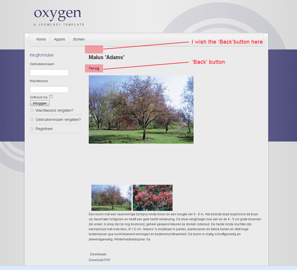

To place an 'Go Back' link to easily navigate back to the product listing, I've pasted the code below into 'display ==> view ==> Product / show_default.php'(this is from a older topic).
<a onclick="window.history.back(); return false;" href="#" >
<span class="icon-32-back" title="<?php echo JText::_('HIKA_BACK'); ?>">
</span>
</a>
Now this link is placed under the 'Title', see picture. I would like this link above the 'Title', is this possible?
Thanks in advance for a response.
Regards. Flow

I think that you should just put the code of your "go back" link in the "hikashop_product_top_part" div, so just after this line for exemple :
<div id="hikashop_product_top_part" class="hikashop_product_top_part">
Hope this will help you.

Hi Mohamed,
Thanks for your response. Where do I find the "hikashop_product_top_part"?
Regards, Flow
13 years 9 months ago #79944
You'll find it through the show_default file of the product view of your front-end template.
Then, you should just put the code of your "go back" link after the line :
