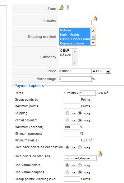

  • Posts: 130
13 years 8 months ago #84244
See my replies:
a) Without such reference, it's very difficult to discern / audit points spent. In my case points = in store credit so it's quite important to know on what / how it was spent.
b) Exactly. And it's not working. I.e. I have 1000 points, buy something for 500 and shipping cost 120. In the end shipping cost is not paid by points. (you'll see my configuration below)
c) This was on my test environment and I was / am on 2.0 there for some quite time (I can provide you with credentials if needed via PM). The configuration is:
Last edit: 13 years 8 months ago by karolko.
  • Posts: 26384
  • Thank you received: 4077
13 years 8 months ago #84558
Some options are not compatibles between them.
"Shipping" is not compatible with "Virtual coupons" because the coupon could not affect the shipping price.
Which payment plugin do you use with AlphaUserPoints when the final price is zero ?

  • Posts: 26384
13 years 7 months ago #86727
"Why not" why ?
The virtual coupons are not compatible with the shipping price. That's a current limitation of the system.
If there are not compatible it means that it could not work...
You can remove the "virtual coupons" option if you want a good compatibility with the shipping price.
