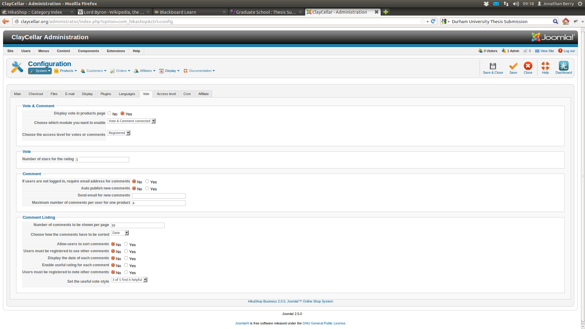

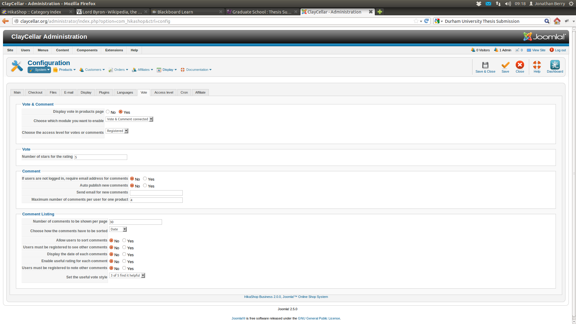

13 years 9 months ago #81108
Can you please do a screenshot of the Vote tab of the configuration so that we can see all your vote related settings ?
  • Posts: 76
13 years 9 months ago #81180
Ok, it's attached.
Thanks so much for your help.
Jonathan
13 years 9 months ago #81185
You vote configuration seems to be correct.
Do you have the latest version of HikaShop ?
Can you give us a screenshot of you problem ?

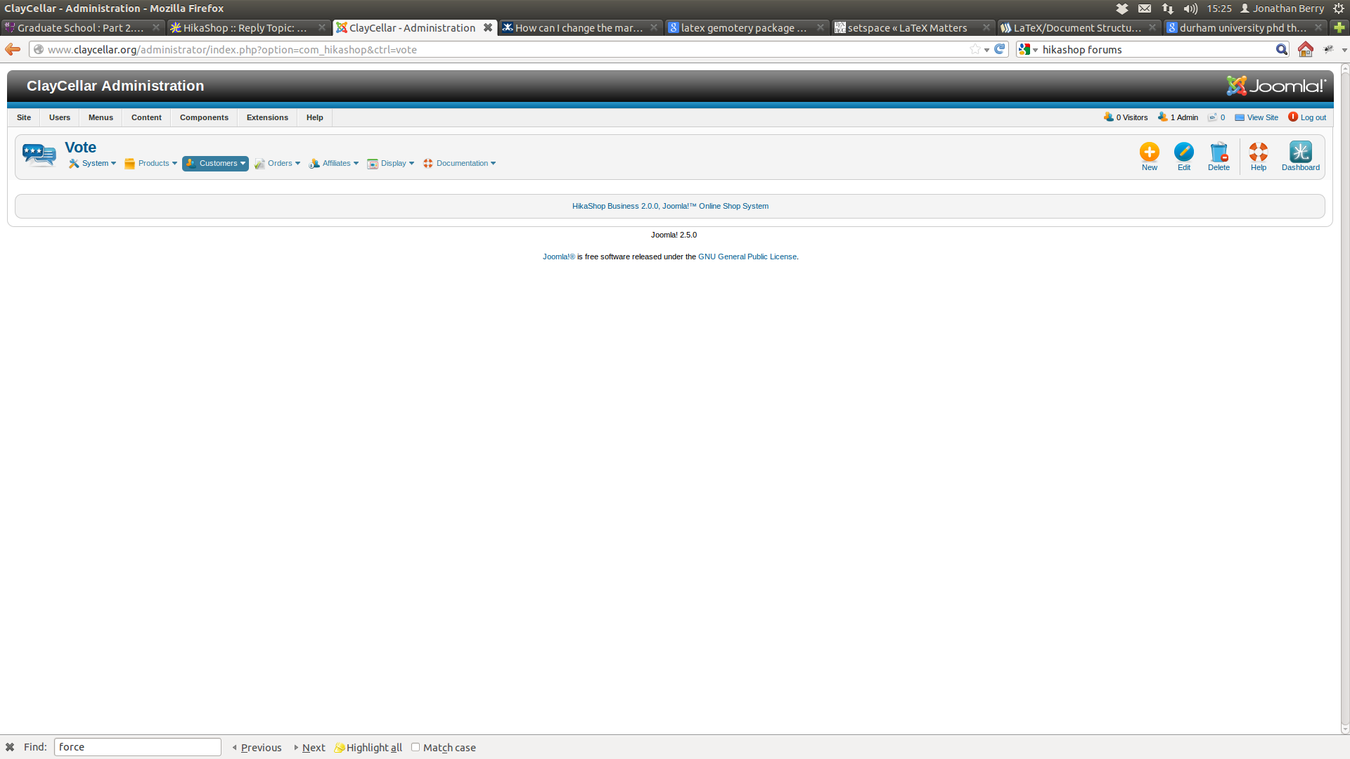

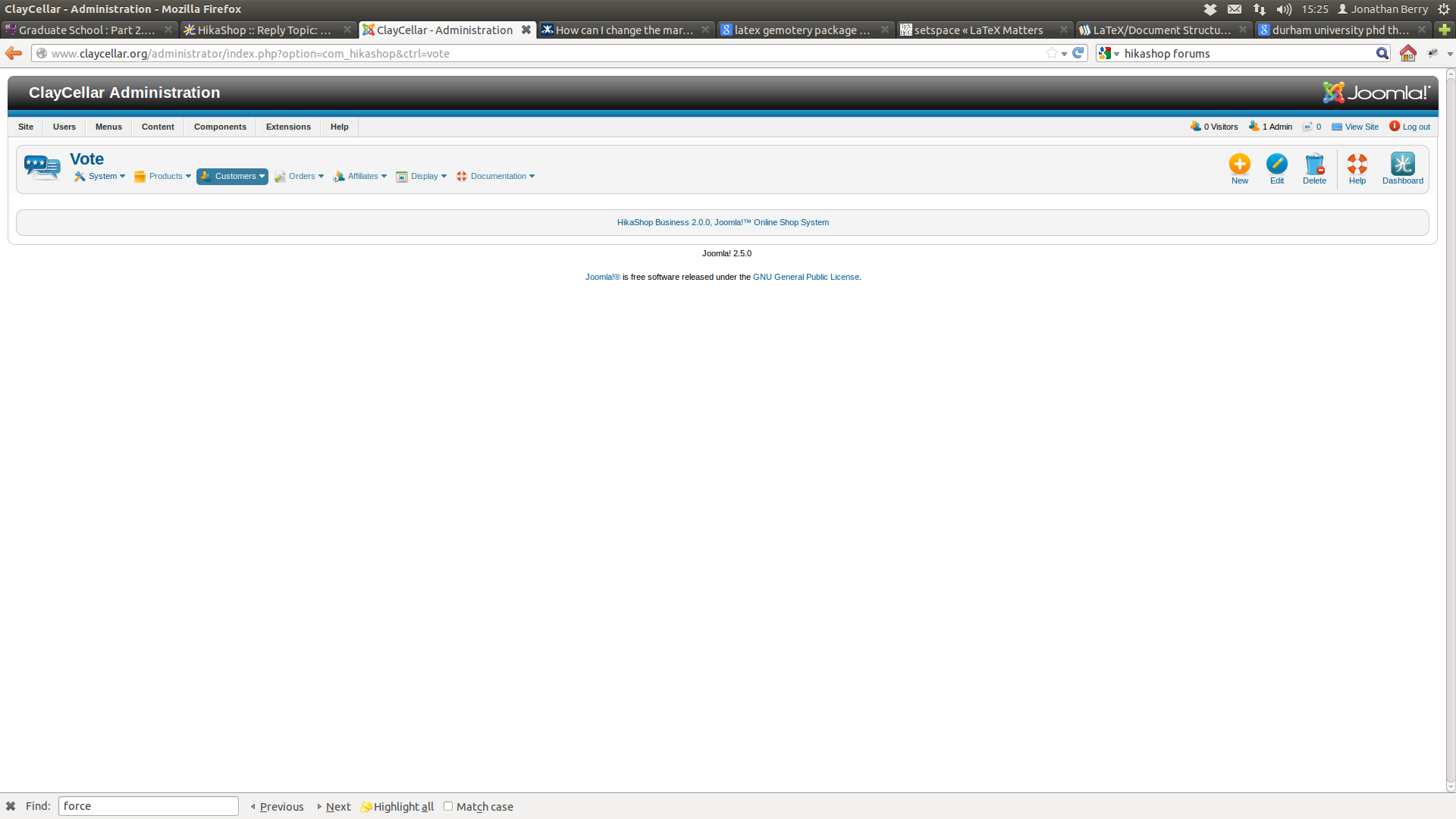

  • Posts: 76
13 years 9 months ago #81251
Oh, I see, sorry! With you...
The screen shot is attached.
Jonathan
13 years 9 months ago #81322
No problem :) Can you enable the Joomla Debug mode and give us the error returned (if an error is returned). Else can you give us a backend access, and a FTP access ?
