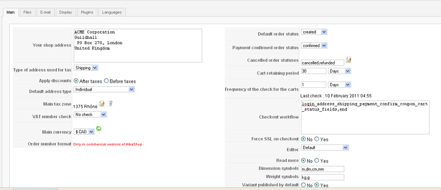

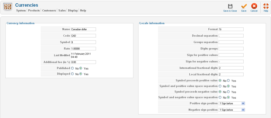

1. I set my symbol to $ in currencies but it does not show on the front-end. No symbol is showing on the front-end.

1. No symbol ? The symbol $ is already set in the dollars currency in hikashop. You should not have to set it but just publish that currency. Did you publish that currency in the menu System->Currencies ? Could you make a screenshot of that listing ? Also, did you set your main currency in the configuration ? Could you make a screenshot of your front end where you don't see the $ ?

15 years 7 months ago #7727
I've attached screen shots regarding the symbol.
  • Posts: 966
  • Thank you received: 11
15 years 7 months ago #7728
2nd image...

  • Posts: 86183
15 years 7 months ago #7729
You just need to replace the %i by %n in the format option. That's explained in the doc available via the help button
