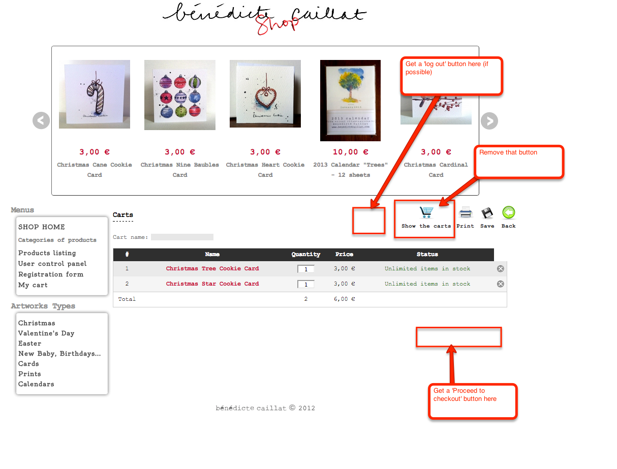

Hi all,
I'd like to know how to change that view of the cart (named 'Display Cart' in HikaShop if I'm correct):
www.benedictecaillat.com/my-cart
(also available in the attached screenshot).
1) Have the 'Proceed to checkout' button available on that view (which I think should be there by default, but may be I'm missing something here)
2) Remove the 'Show the carts' button (I have disable the 'Multi carts' so it really shouldn't be here in my opinion
3) Get a 'Logout' button available (if not here, at least somewhere in the shop).
The most important being the n°1.
Many thanks for your help in advance,
Salutations,
D.

13 years 8 months ago #82011
For the Proceed to checkout, you can try to add the folowing code:
<?php
$cartClass = hikashop_get('helper.cart');
$this->url_itemid = $Itemid;
echo $cartClass->displayButton(JText::_('PROCEED_TO_CHECKOUT'),'to_checkout',$this->params,hikashop_completeLink('checkout'.$this->url_itemid),'window.top.location=\''.hikashop_completeLink('checkout'.$this->url_itemid).'\';return false;','id="hikashop_add_to_cart_checkout_button"'); ?>
And remove the code:
				<td>
					<?php
						if($cart_type == 'cart'){
							<a href="<?php echo hikashop_completeLink('cart&task=showcarts&cart_type='.$cart_type.$Itemid); ?>">
								<span class="icon-32-show_cart" title="<?php echo JText::_('DISPLAY_THE_CARTS'); ?>">
								</span>
							</a>
					<?php
						}elseif($userCurrent == $this->cartVal->user_id){
								<span class="icon-32-show_wishlist" title="<?php echo JText::_('DISPLAY_THE_WISHLISTS'); ?>">
								</span>
							</a>
					<?php
				</td>

13 years 8 months ago #83190
Hey Xavier,
Many thanks again for your answers / solutions. :)
(the only thing: it was the 'showcart' and not the 'showcartS' that has to be modified).
Everything looks the way I want on this screen now.
Thanks again for all advices / instructions.
