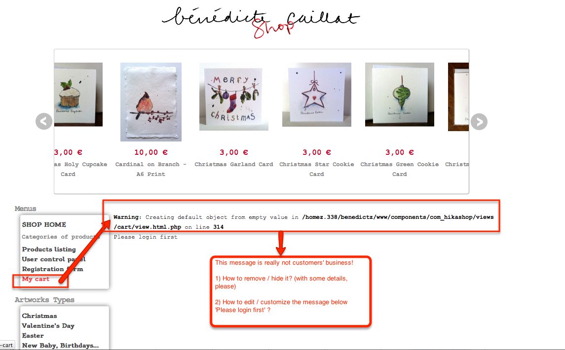

Hi again,
Moving forward to my first HikaShop online shop :) ...
However, I'm having an issue with a system's message (see it live or in the screenshot attached) that are really not something I want the customers of this site to see.
It really looks like a bug, or something going wrong, and then it tends to remove confidence to move forward. :S
If you go on this site:
www.benedictecaillat.com/shop-home
...and clic on 'My Cart' without any product in there, the following message is then displayed:
'Warning: Creating default object from empty value in /homez.338/benedictz/www/components/com_hikashop/views/cart/view.html.php on line 314
Please login first'
1) Hide tech message
I want to hide all the 'technical part of the message (that is 'Warning: Creating default object from empty value in /homez.338/benedictz/www/components/com_hikashop/views/cart/view.html.php on line 314'). This is of utmost importance to me and the users of the website.
Please be kind enough to give me quite some details on how to do it (ex: if there's an edition in the PHP files in the 'Views' part, tell me which one as I don't know PHP at all).
2) Edit the look of the normal message
I want to be able to edit the view of the 'Please login', like center it , making it bold... In the CSS? Where?
It is slightly less a concern though.
3) Inconsistency in workflow
There is, on top of the mentioned issues / request, an inconsistency: if the cart is empty, I get the above mentioned message ('Please login'), BUT if the cart gets at least one item, then I can see it, and no more request to login... It is weird, not consistant, and makes me wonder what's going on... What do you think? What is wrong? What to do?
Many thanks in advance for you help,
Best to all,
D

  • Posts: 26384
  • Thank you received: 4077
13 years 8 months ago #81962
Please edit the file "components/com_hikashop/views/cart/view.html.php and change the code around line 314
else
   $user->id = 0;
By:
else {
   if(empty($user)) $user = new stdClass();
   $user->id = 0;
This modification would be include in the next HikaShop package.
HikaShop use a lot of "classname" on his HTML elements in order to help you to make some CSS customization.
www.hikashop.com/en/support/documentation/faq.html#css
If you want to add html content, you have to know that you can override all HikaShop views. In the backend, you can go into "Display > Views".
You would find all views and you would be able to edit a specific view for a specific template.
What page did you try to open to have the "please login first" message ?
We need to know the url in order to know the action you try to do.
