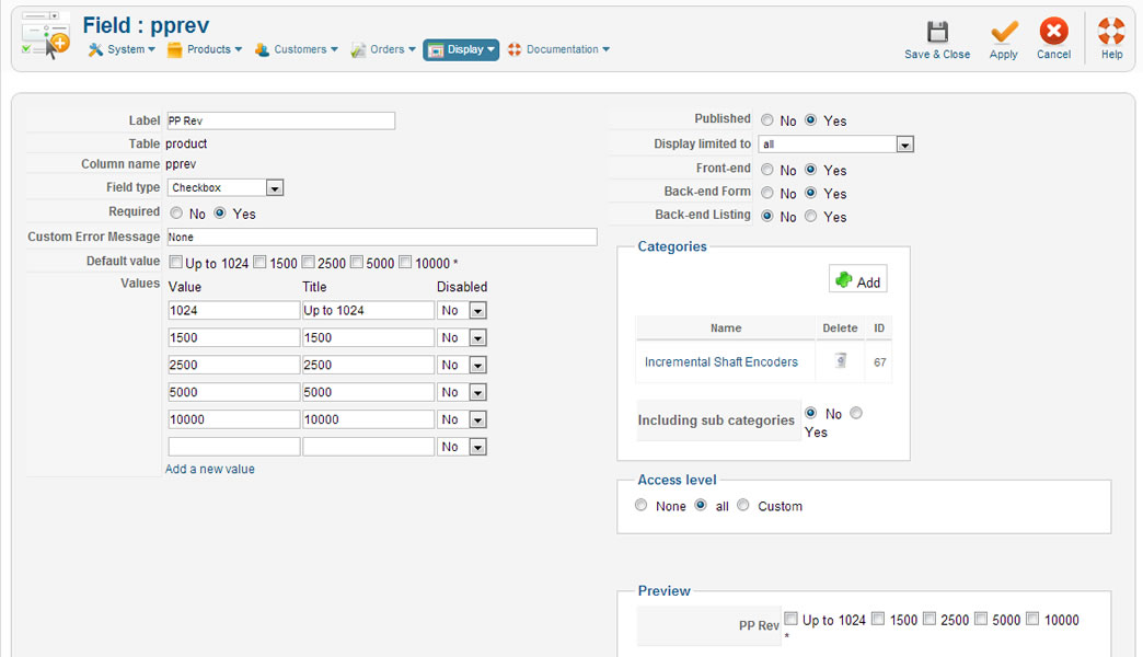

You should change your custom field to a multi select or checkbox custom field and instead of selecting the max RPM, you should select the "valid" RPMs for the product. Then, your filter on that custom field would behave the way you want.

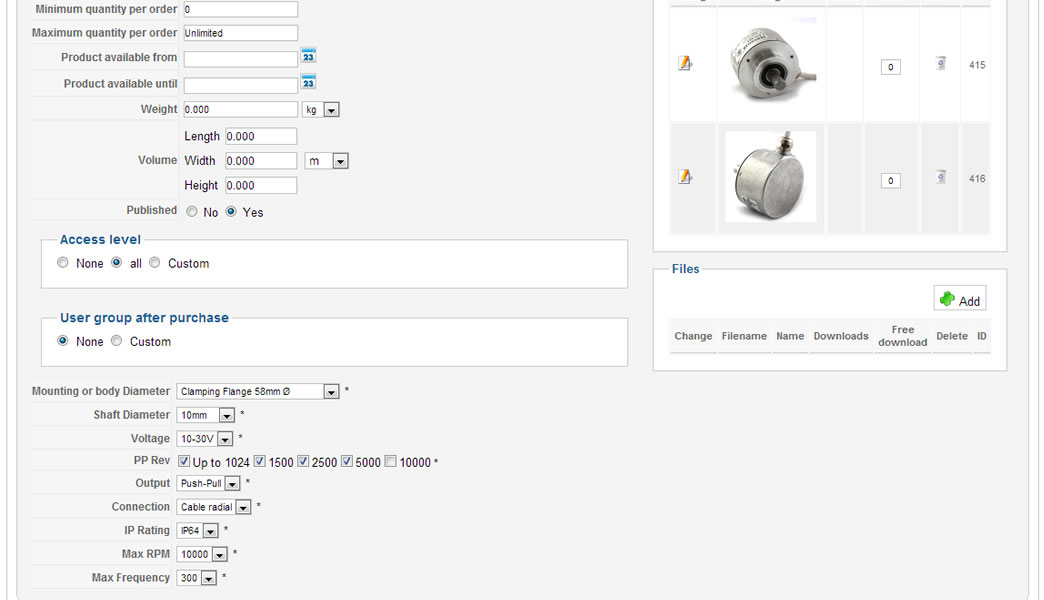

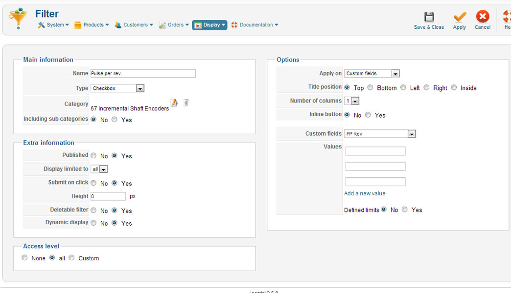

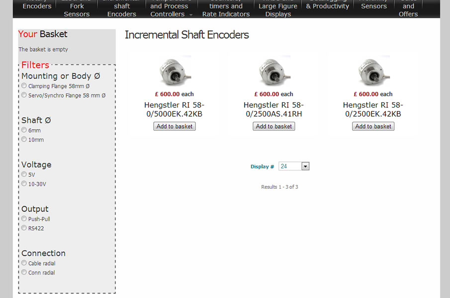

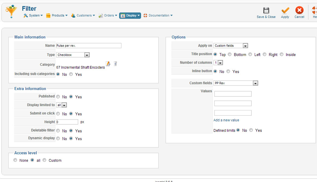

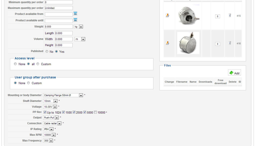

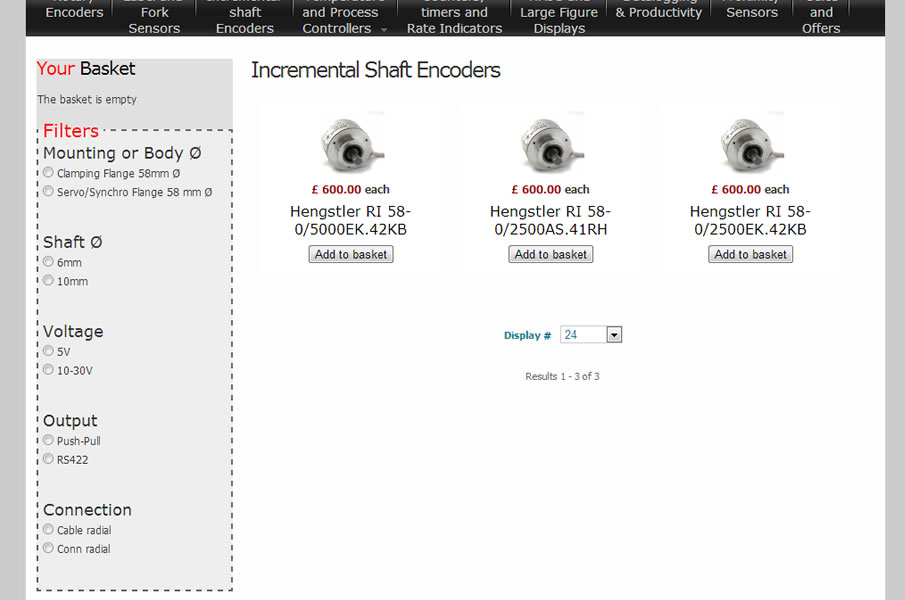

Thanks Nicolas. I've set up the custom field and filter as you suggest, but the filter is not appearing on the category listing and I can't understand why. I've done screengrabs of all the setup pages and the category listing page - can you have a quick look and see if I've done anything wrong?
Many thanks! All the best - Leo

I don't see anything wrong in them. Maybe the "dynamic filter" option should be turned off ? Maybe it comes from the category restrictions of your filter/custom field ?

I've solved it!
In the Filter module, under Basic Options, I hadn't selected the filters I wanted to be displayed. Whoops!
