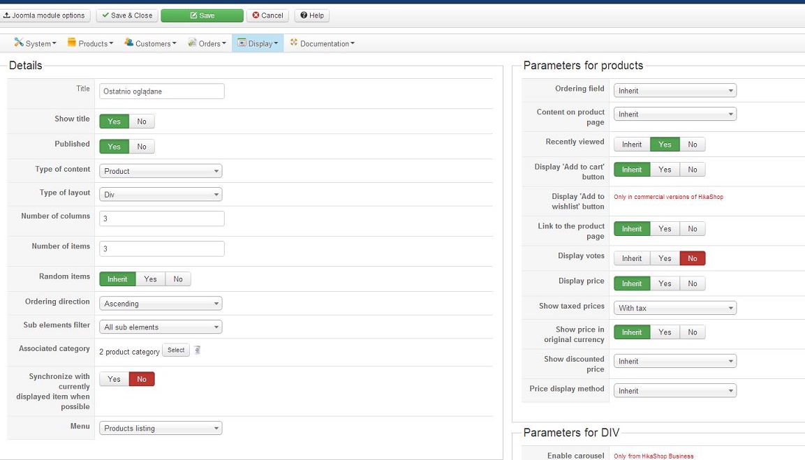

I have a problem with "Recently Viewed" module. This module displays properly, but it shows only the first 3 products displayed in the session. The rest of the "watching" products are not visible. Just after watching the first 3 items, the next are no longer visible. I have chosen in the settings module that is designed to show only 3 products, but for some reason it does not work properly. Please tell me what I'm doing wrong?
These are my settings for the "Recently Viewed" module
and the address of the page: www.dziuchnogrod.pl
To see recently viewed items, you must select one of the categories (Kategorie) on the left side.

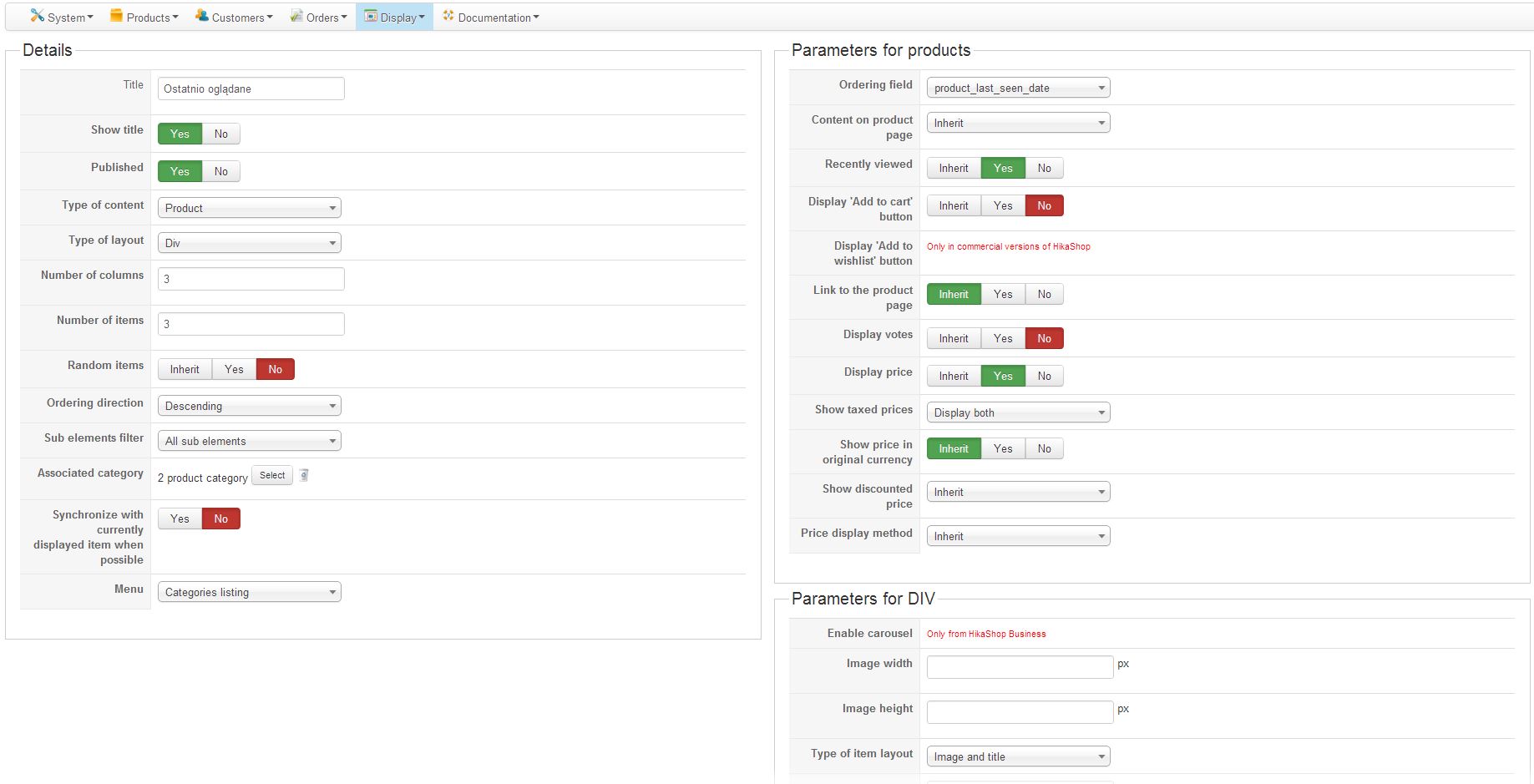

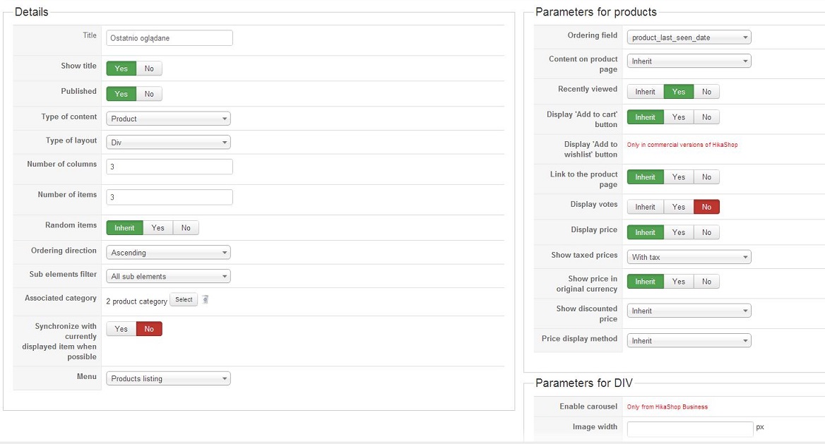

I changed the option "ordering field" to "product_last_seen_date" and of course I save the changes, but it still does not work properly.
My current settings

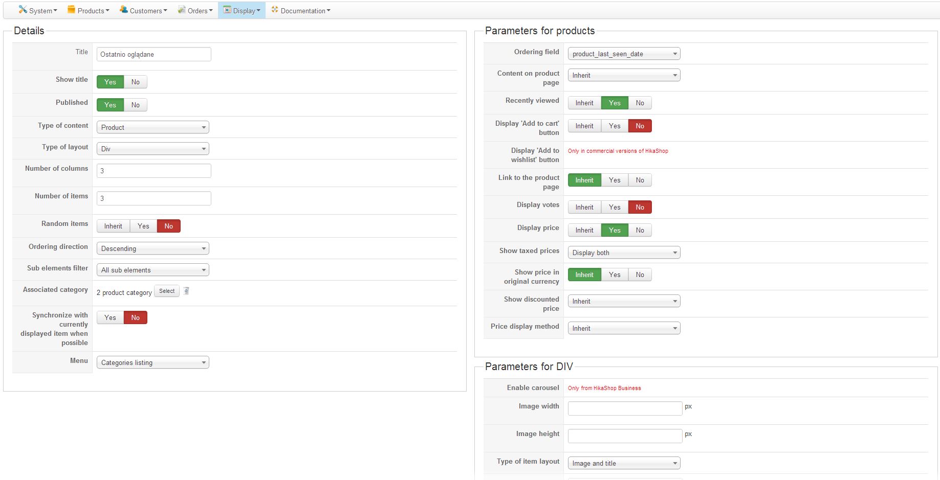

  • Posts: 11
13 years 7 months ago #85295
I thank you for your response Nicolas,

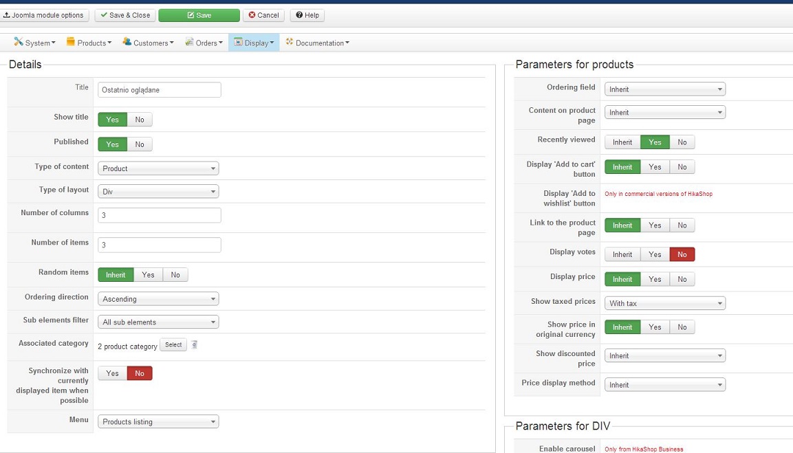

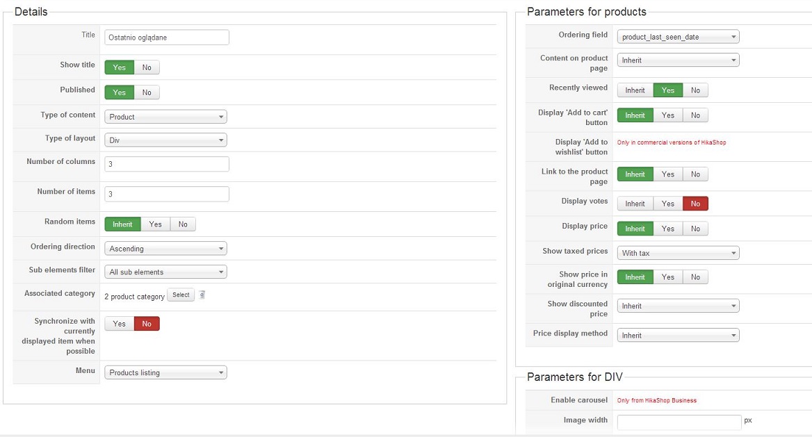

I checked it, but it still does not work properly. :(
I attach a screenshot of my current settings.
  • Posts: 86105
  • Thank you received: 14206
13 years 7 months ago #85398
Ok, thank you for sticking with us. We found the problem. As a temporary fix, you can change the code:
$a = hikashop_table('product').' AS b';
				$pageInfo->filter->order->value ='';
to:
				$pageInfo->filter->order->value ='b.product_last_seen_date';
				$pageInfo->filter->order->dir = 'DESC';
in the file components/com_hikashop/views/product/view.html.php
We'll have a more complex fix in next release in order to have a definitive working solution.

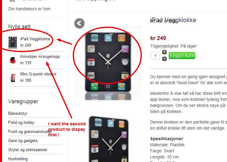

  • Posts: 344
12 years 9 months ago #133153

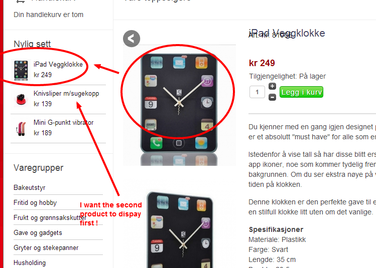

Joomla 2.5.15
Hikashop Business latest version
The Hikashop content module with Recently view works perfect.
But there is one thing.
When I click on a product the Recently view module displays the current product first.
But I don't want the module to display the current product, I want it to display the second product first, which in reality is the product that was recently viewed.
Any solution how to fix this ?
Please see attached picture to see what I mean.
12 years 9 months ago #133154
The module is displayed after the page. So the product that you are currently seeing has just been see by the user. So it is logical for the module (which is displayed just after) to be set as the last seen product, because it really is.
So, basically, it's not really possible except if you exclude the current product from the list. At this moment the display will be logical all the time, it will display the recently viewed products except the product that the user is viewing currently.
It requires some PHP/Development skills to do such kind of modification.
