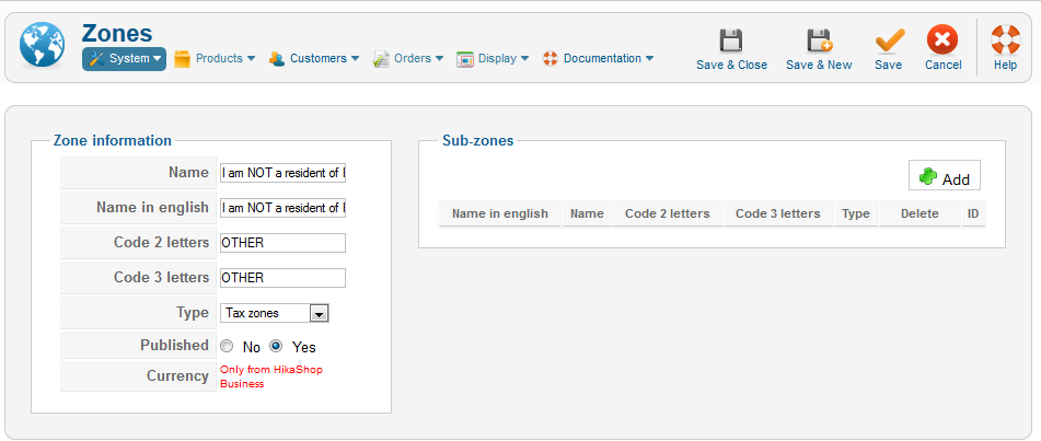

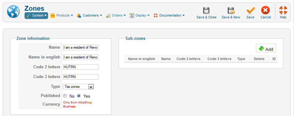

It would seem like a custom zone field in the Address table should fix that. I created a new Tax Zone, with two entries - "I live within XXXX county", and "I do NOT live in XXXX county".

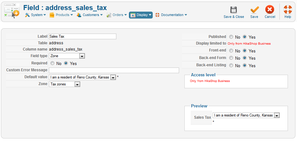

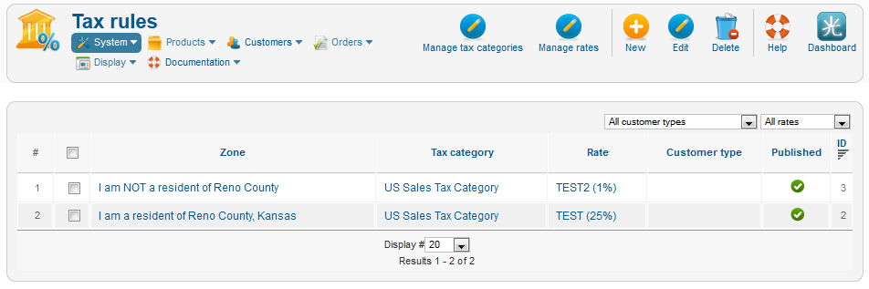

Like I've said, I added the zone to the address table, and that shows up in the Address section, but I cannot figure out how to make the Tax rules observe this.

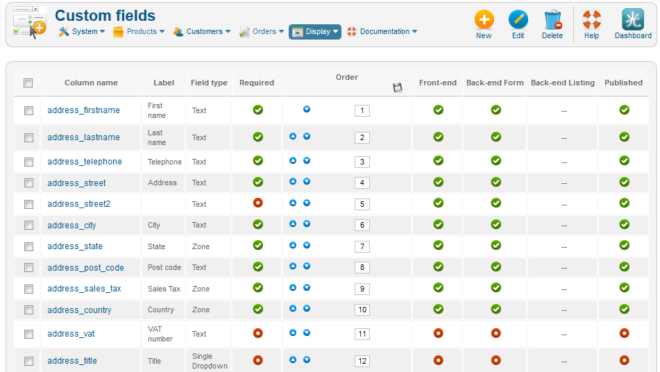

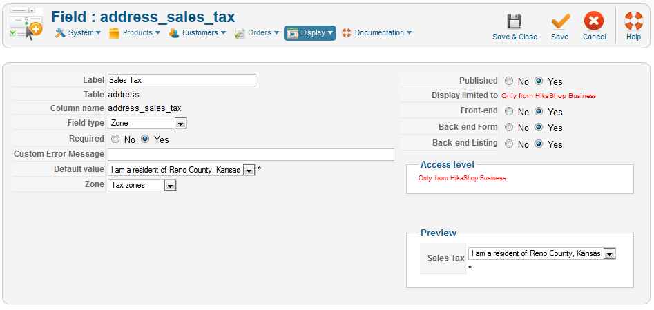

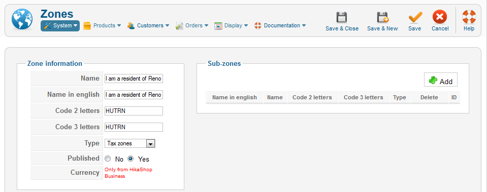

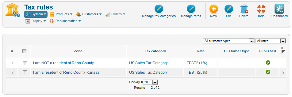

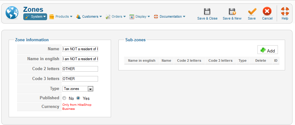

13 years 8 months ago #83199
I'm uploading screen shots of my current config if that helps.

The tax zones are used with the tax system.
You can create a tax zone in order to define the different zones for taxes.. A tax zone.
The customer have an address, with a country and a state. Depending to his address, HikaShop would retrieve the compatible tax zones and would get his current tax rate.
So, a tax zone allow you to create a special zone, with countries and states, which would have the same tax rate.

So what you're saying is that there's no (direct) way of having the end-user select which tax zone they're in (in County or out-of-County) and apply the tax accordingly?
13 years 8 months ago #83542
He is just saying that your taxe rate will be aplied regarding your customer address wich will be in a taxe zone.
So the end-user will choose it undirectly by giving his address.
