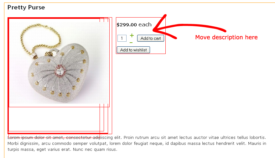

May I please ask for some help with the code below. I tried moving it where I think it should go but it doesn't seem to work correctly, not sure what I'm doing wrong.
What I'm trying to do is to move the description directly below the price, as per the attached screen shot. Can someone please help with this?
This is on the product details page which I think is: product / show_default.php
Thanks in advance.
content of the file show_default removed by a moderator

Don't worry about the "show_default.php" content, we already have it :)
Just searching "description" in the file and you would see the block:
	<div id="hikashop_product_description_main" class="hikashop_product_description_main">
		<?php
		echo JHTML::_('content.prepare',preg_replace('#<hr *id="system-readmore" */>#i','',$this->element->product_description));
	</div>
Which display the product description.
You can move this block into another HTML block.
The current HikaShop CSS display the "hikashop_product_bottom_part" below the "hikashop_product_left_part / hikashop_product_right_part" parts.
So, you can move the block at the bottom of the "hikashop_product_right_part" or you can modify the CSS in order to display the bottom part like the right part (using "float" rules, removing "clear" rules).
