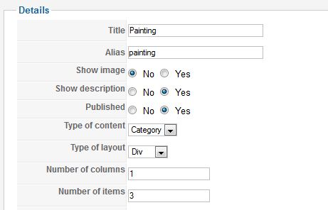

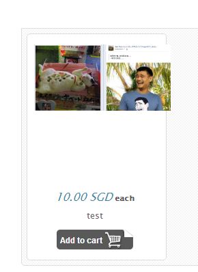

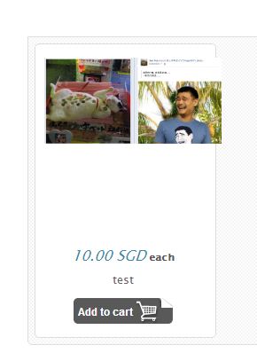

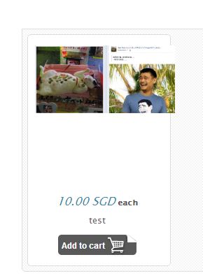

hi,
i having problem with my display on categories-product display.
please see attach picture.
i set my picture size to 300 x 300
it will exit the bolder and the bolder height is long.
i know need to edit css, hope someone can tech me how
thank you
Joe

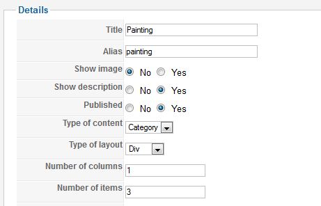

Hi Joe,
Did you tried to reduce the "Number of columns" option of your product listing ? ("Hikashop->Display->Content menu->'Your Product listing'").

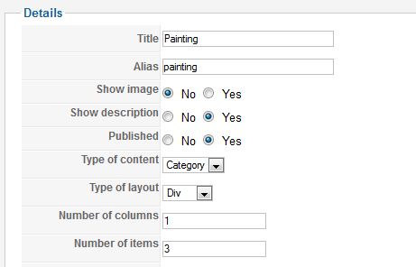

hi,

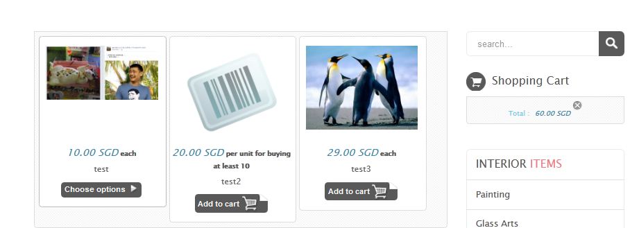

i had set
Number of columns to 1
number of item to 1
but it still display 3 item on the same row.

13 years 8 months ago #84545
When you click on that link, you will arrive in the associated module options. In these options set the number of columns to 1.

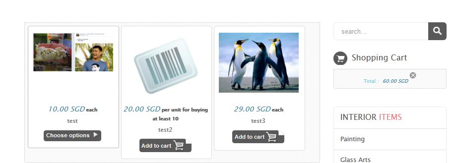

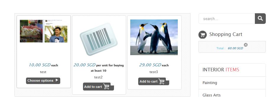

13 years 8 months ago #84724
hi,
as my setting is 1 but it still show 3.
from my attach picture you know what i mean.
thank you
joe
13 years 8 months ago #84805
Yes I know what you mean, but I think that you are not editing the good module.
Try to edit them one by one and see the result, but the module should be the menu associated module.

13 years 8 months ago #84989
Yes you can pm me the backend informations to see what is wrong.
13 years 8 months ago #85020
As I told, the associated module to the menu "Painting" had the option "Number of column" set to 3 instead of 1. (Associated products listing for category listing menu 245)

13 years 7 months ago #85257
You should not change the associated module but simply change the number of columns of that associated module.
It's on that page of the backend:
www.website.com/dtp/administrator/index....odules&task=edit&cid []=133
for the painting menu. And you need to do the same for the other menus's associated modules.

13 years 7 months ago #85382
The associated modules display the products inside the categories, so it's in the associated modules that you have to change the number of columns and not in the menu options directly.
Menu categories listing = number of columns to display categories
Associated module = number of columns to display products of the categories.
You must not remove the associated modules, but edit their settings.
I just tried to change the number of columns for the display of the products inside "decorating" menu, and it's working fine. Changed from 3 to 1 in the associated module.
