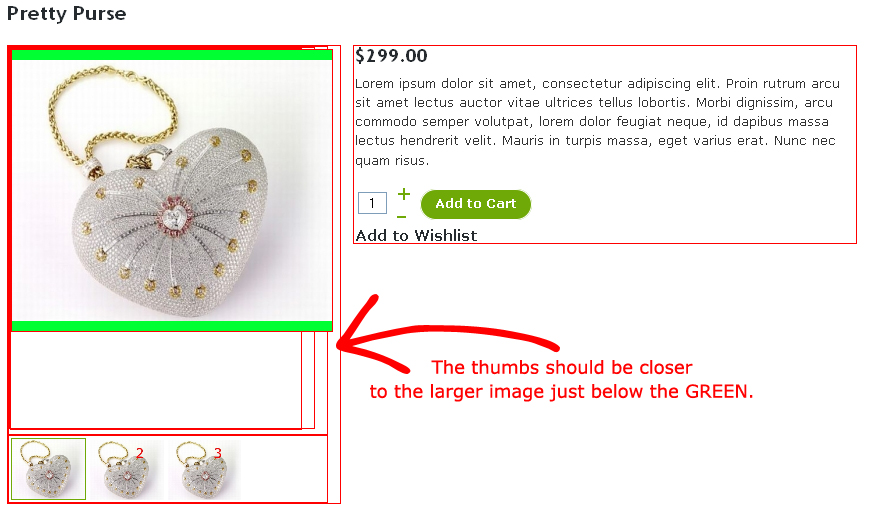

There is a lot of spacing after the main image and before the thumbs, as per the attached image. If I remove the height from the "Product page image height" it defaults to the Thumbnail height and the spacing is reduced, and it looks better, but it also reduces the size of the main image which I don't want.
The height is 360px but the divs around the image seems to add 20px. The DIVs are hikashop_product_main_image and hikashop_image_main_thumb_div.
So, how I reduce the height of those 2 divs please?

I see the html code:
<div class="hikashop_product_main_image_thumb" id="hikashop_image_main_thumb_div" style="height:380px;">
which means that you have specified a maximum height for thumbnails.
You can set "0" to the thumbnail height in order to not have such height restriction or you can edit the view "product | show_block_img" and replace the line:
<div class="hikashop_product_main_image_thumb" id="hikashop_image_main_thumb_div<?php echo $variant_name;?>" <?php echo $style;?> >
By:
<div class="hikashop_product_main_image_thumb" id="hikashop_image_main_thumb_div<?php echo $variant_name;?>">
