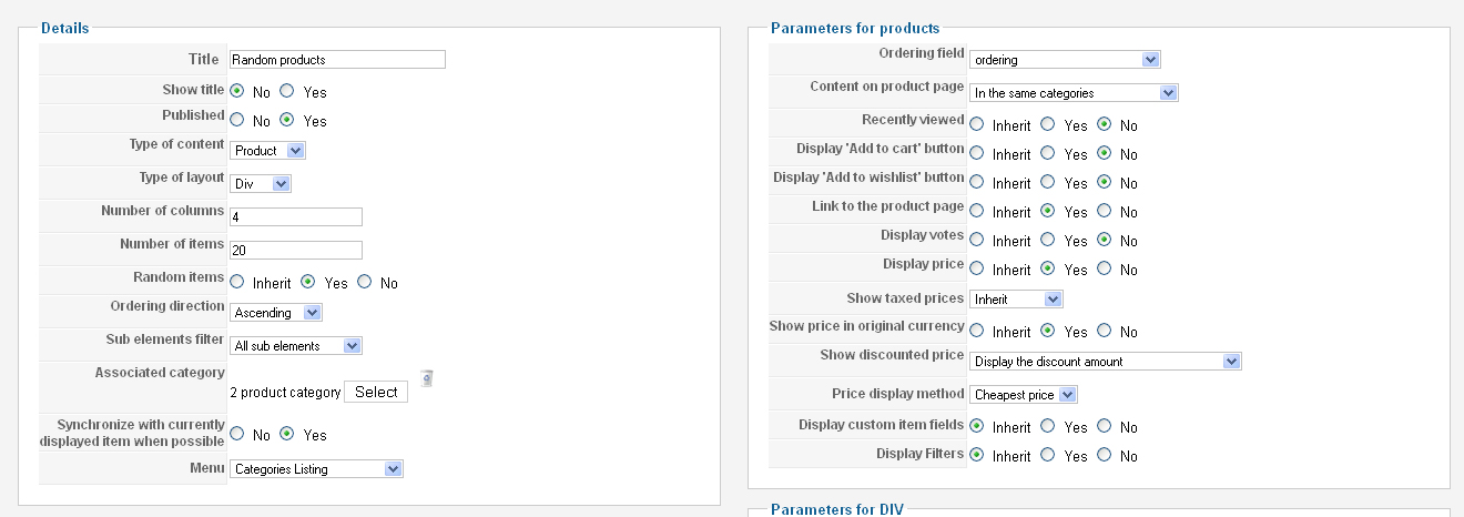

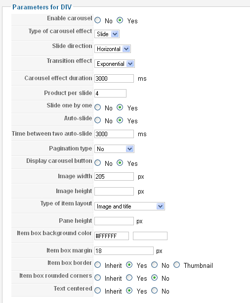

I'm trying to create the same slide similar to the one at the top of this page:
demo.hikashop.com/index.php?option=com_c...5&Itemid=103&lang=en
What I would like is one row displaying 4 random products at a time. Then when you click on the "next" button it shows the next 4 random products, etc...
I have attached what I have so far, what do I need to change because I've made a lot of changes but I'm not getting what I need.
Thanks in advance!!

13 years 8 months ago #83505
Your configuration seems to be good, so can you show me what results you are having ?

13 years 8 months ago #84180
I changed it to "Random Product = NO" but see no difference.
I don't think this should be too hard to set-up so I'm clearly missing something obvious or it's not working as it should.
All I want is one row displaying 4 random products at a time. Then when you click on the "next" button it shows the next 4 random products, etc...
Thanks!!
  • Posts: 26384
  • Thank you received: 4077
13 years 8 months ago #84205
Could use add a CSS rule for
.hikashop_main_carousel_div ul li {
padding: 0px !important;
background: none !important;
margin: 0px !important; /* <= add this rule */
It would fix the problem of two lines in your website.
Because there is a 1px margin, the second "li" can't be displayed at the right of the first one, so it is displayed below and that generate this display problem.

  • Posts: 2334
  • Thank you received: 403
13 years 8 months ago #84918
It should be better with
.hikashop_main_carousel_div > ul > li {
So the margin override would be just applied on the main "li", not on the sub elements which should have some margins.
