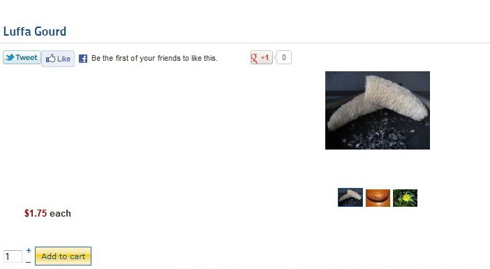

  • Posts: 47

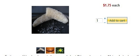

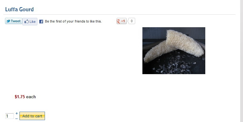

13 years 7 months ago #86071
I have realized that there is a display issue with the product image that appears to happen once the product title is clicked. Image shifts to right and the price and number of products are now on the lower left corner (attached). Why do you think this is happening? Right now, in the product information page, default is selected for the layout on product page parameter. I also tried inherit, reversed, and tabular and then switched back to default but I can't recover the product page to the initial condition. I want the product image to be left-aligned while the product price and number of the product stay on the right.
  • Posts: 86112
  • Thank you received: 14210
13 years 7 months ago #86100
It indeed comes from the "layout on product page" option. Note that this option is at several places:
- on the product edition page. That the option with the most important priority. If you set "default" here for your products, it will display with the default layout, not matter what.
- on the category edition page. If you set the option on the product as inherit, the product layout will use the category's "layout on product page" option.
- in the Display tab of the configuration which is the last setting used if both the product and its ctegories are set to "inherit".

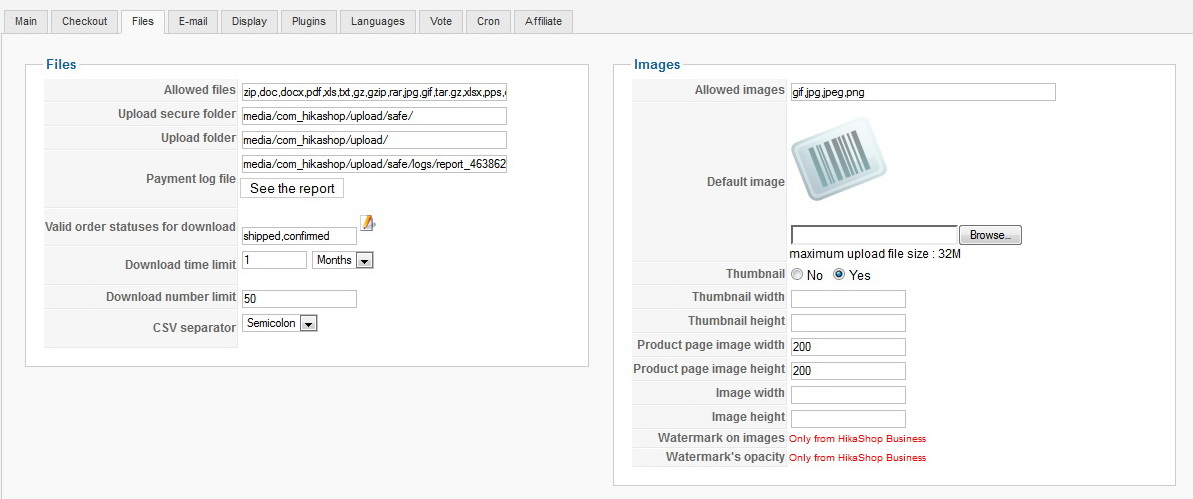

  • Posts: 47

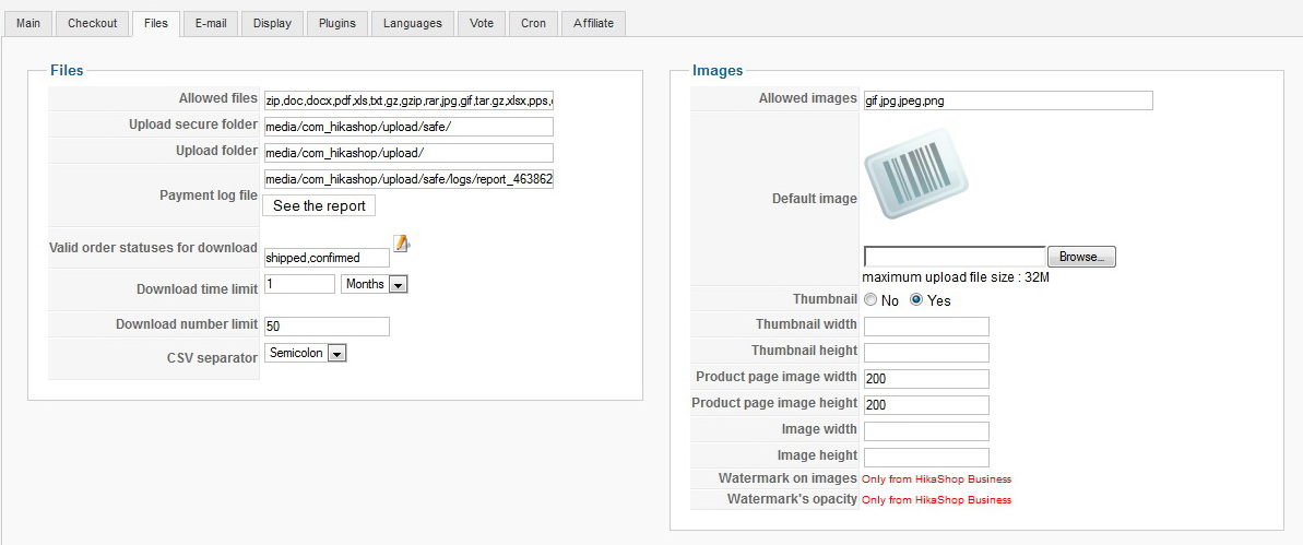

13 years 7 months ago #86182
Nicolas,
I think the issue I am having here is related to the image width and height defined in Configuration--->Files. True dimensions of the image I have is 640x480. Dimensions I set in the Files tab for "product page image width and height" is 200x200 (attached). So when the customer clicks on the product title, he/she will display an image no larger than 200x200 but when he/she clicks on the image, the image will enlarge to its original size, that is 640x480, in the pop-up window.
My questions:
1) The image I have has rectangular dimensions. Should the dimensions I define for the "product page image width and height" be rectangular, too?
2) What other parameters (thumbnail dimensions, image dimensions etc.) should I define and how? If I need to modify any settings outside Configuration--->File tab, what settings need to be modified?
I am using the Essential version 2.0.0.
  • Posts: 86112
13 years 7 months ago #86348
1. Not necessarily. You can if you want. HikaShop will resize the images but will keep the proportions so even if you set a width and a height of a square in the configuration, HikaShop will produce a rectangular thumbnail that fits in that square if the original image is a rectangle.
2. You should not need to change any other dimension option outside that screen, unless you want different image sizes for different listings and in that case, you should edit the hikashop options of your module/menu and set the width/height there for that listing.

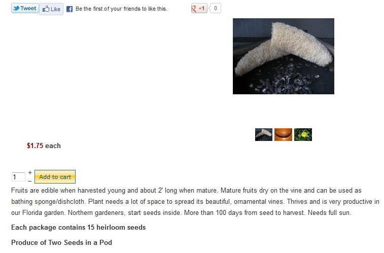

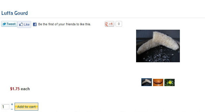

13 years 7 months ago #86465
OK, initially when I click on the menu and then on the item link, everything looks OK; however, once I add the item to the cart and go back to the menu and click again on the product title, product page looks like in the attachment. Is this a bug?
Last edit: 13 years 7 months ago by chancethegardener.
  • Posts: 86112
13 years 7 months ago #86521
It's possible to reach that display depending on how you configured the options.
I don't see any bug on that screenshot.
And I don't know how your product pages look at other places of your website, so I can't say much about it.
Can you give a link to both product pages so that we can see the difference ?

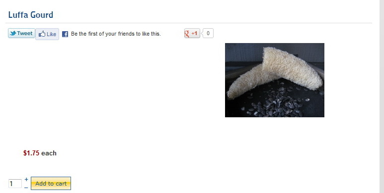

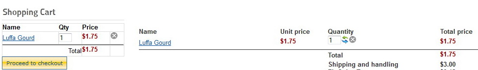

  • Posts: 47
13 years 6 months ago #91037

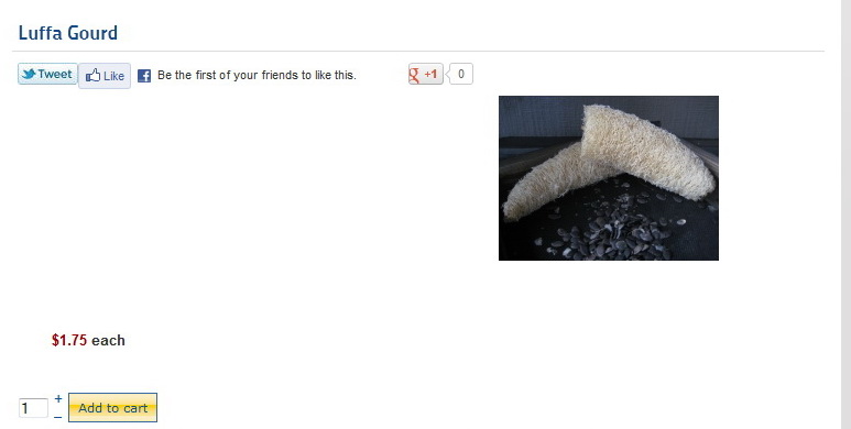

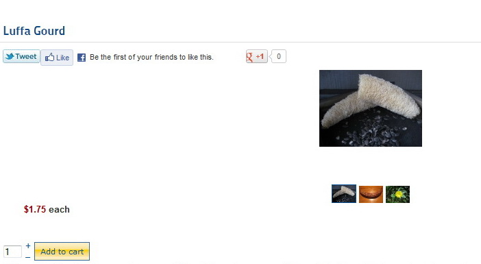

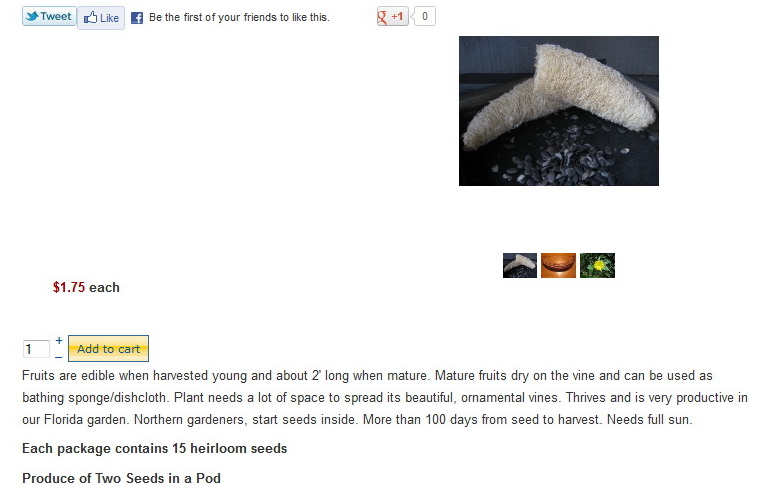

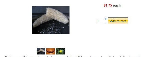

Hi Nicolas, I wanted to revisit this issue as nothing changed. I have attached three images.
Image 1: Shopping cart is empty and I click a product link to display it. Everything looks normal.

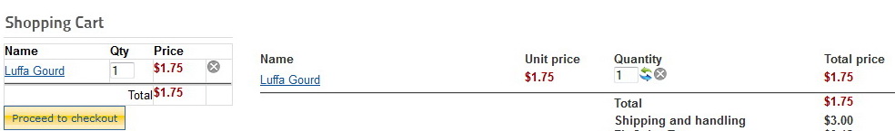

Image 2: I click Add to Cart button. Product is added to the cart and the status of the cart is displayed.

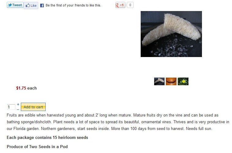

Image 3: If I immediately go back to the product page by clicking on the product link, then I see that the product images are right-aligned and the Add to Cart button is now left-aligned. If I close the web browser and visit the webpage again, everything looks fine. What's going on?
You can test it at www.twoseedsinapod.com
I am currently using HikaShop Essential version 2.1.0
  • Posts: 86112
13 years 6 months ago #91090
It's sounds like it's just a CSS issue.
Add the CSS code below on your website and that should resolve the problem:
.hikashop_social_fb{ height: 10px; }
