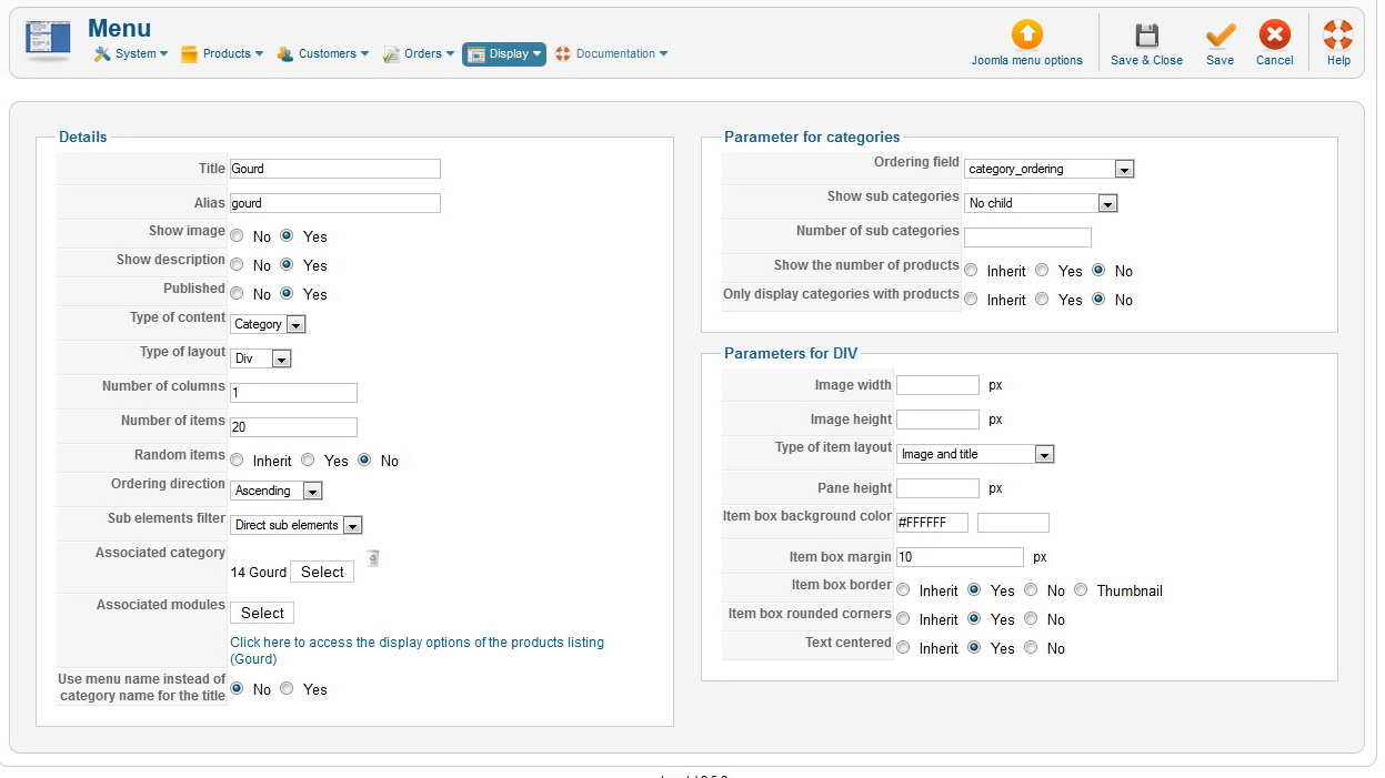

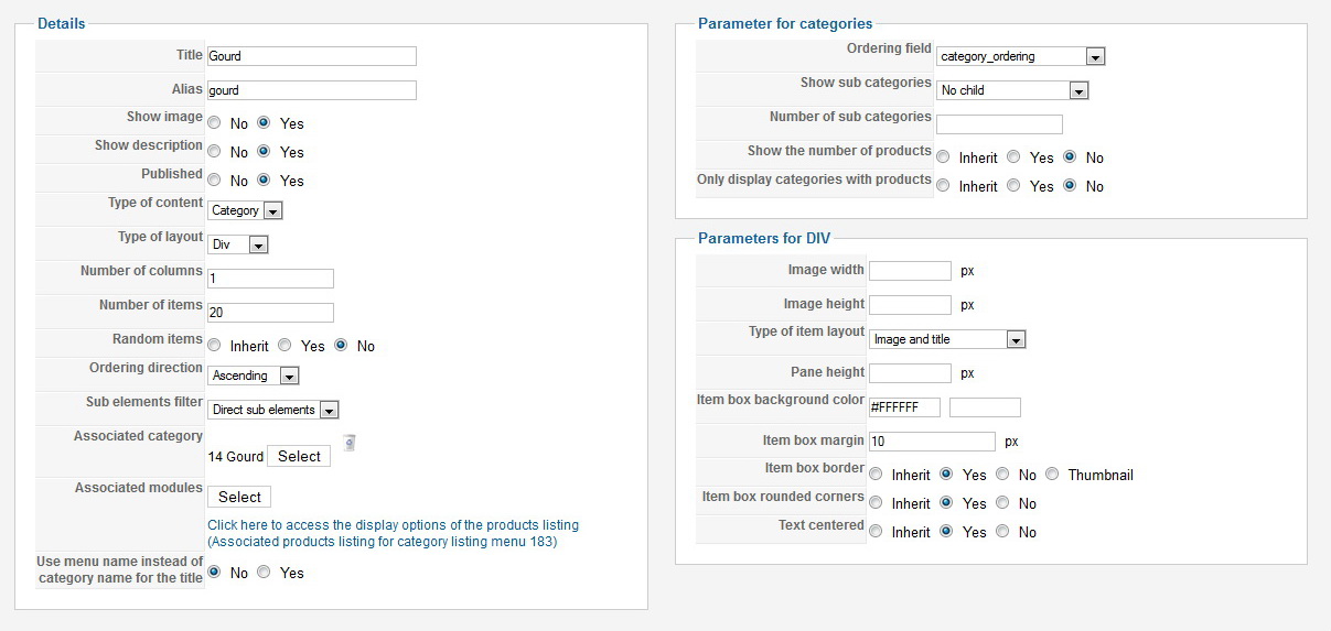

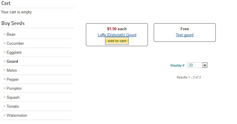

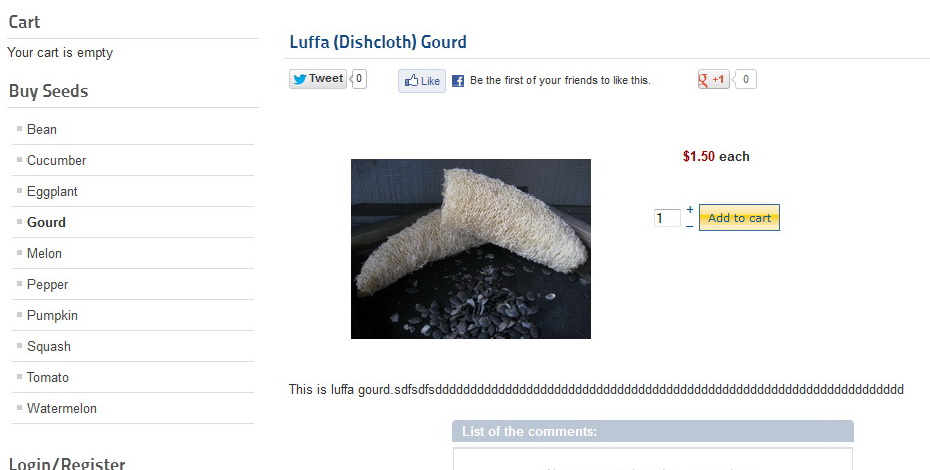

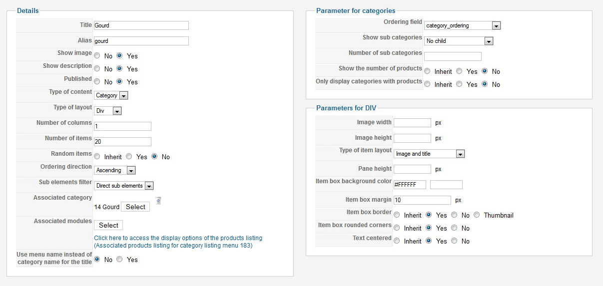

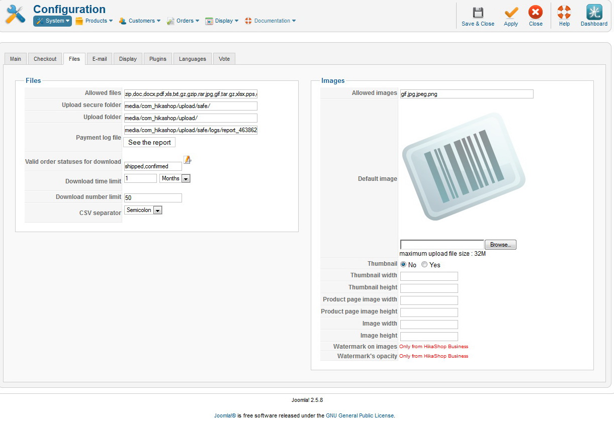

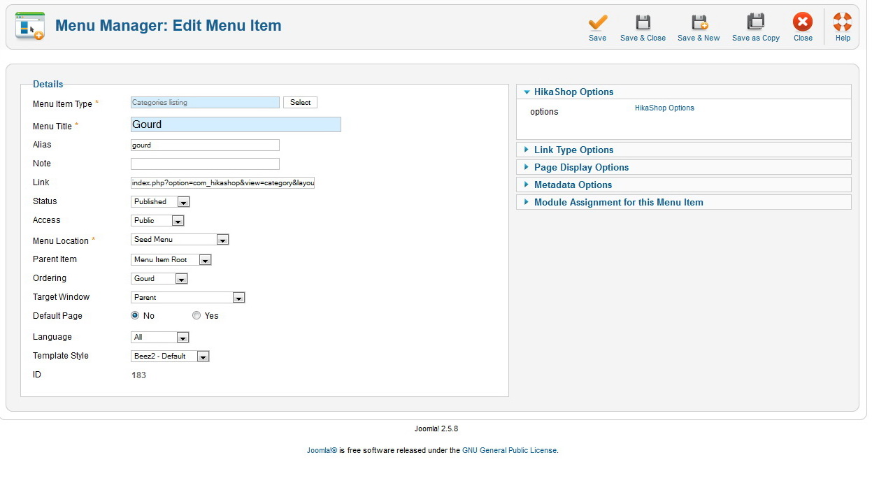

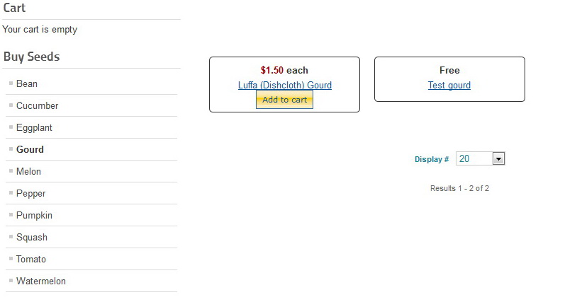

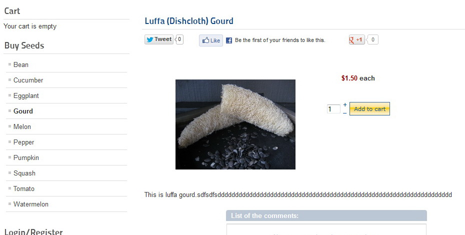

Hi, I am currently using HikaShop version 2.0.0. I have assigned category listings to each menu that is displayed on the left side of the page (Attachment1). Along with product title, I would also like to display product images in the product boxes when clicked on a menu; however, I can't get it to work. On the other hand, when I click on the product title, the image can be displayed (Attachment2). Attachment3 shows the back-end settings I am using. Could you please help me to fix this?

Your category listing use a product listing module associated.
This module has to be configured in order to display product images.
Please click on the "select" button in order to check which module is used for the product listing and edit the parameters of this module.

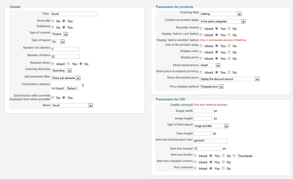

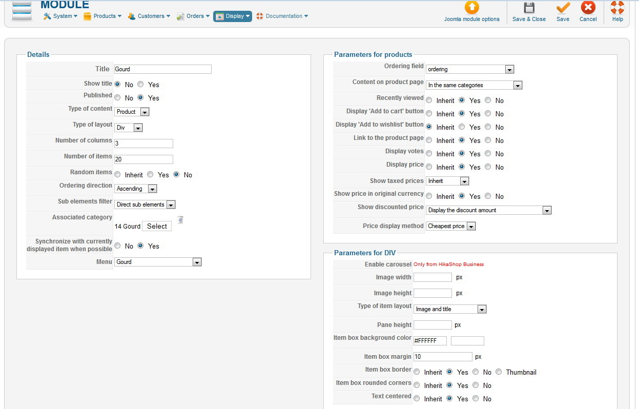

  • Posts: 47
13 years 8 months ago #84281

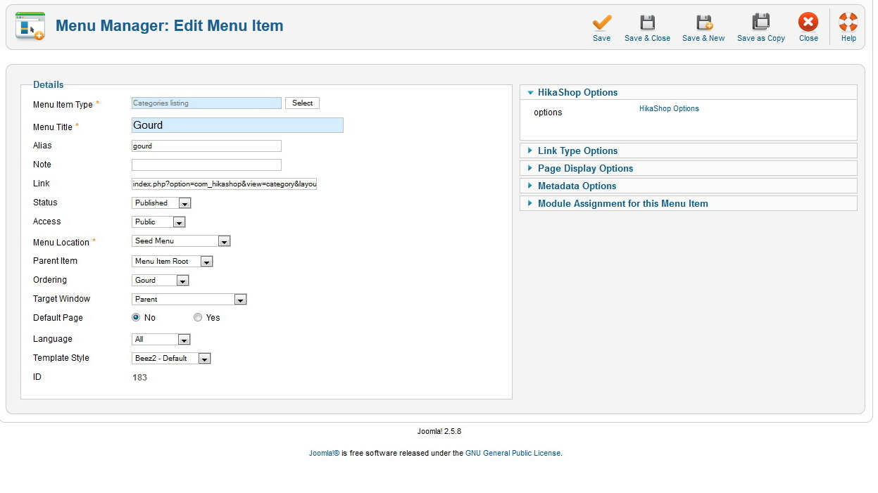

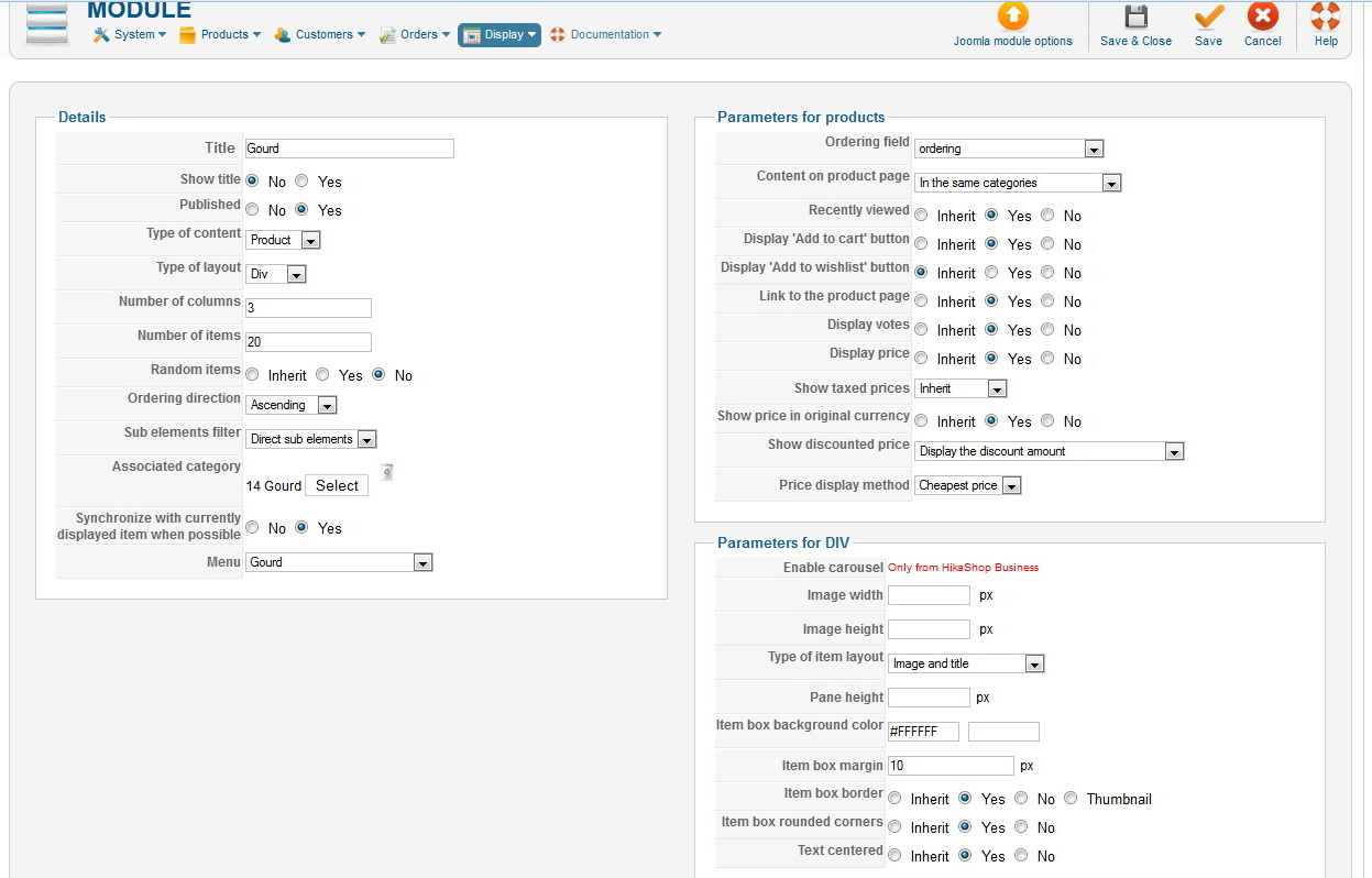

Hi, thanks for your response. I have attached the screenshot for the associated product module. I have played with the image width and height parameters but it didn't impose a change. Module is published, associated category is selected, corresponding menu is also selected.

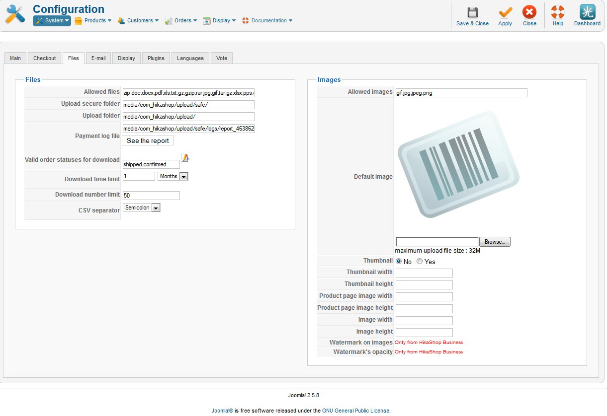

Do you have edited the view "product / listing_img_title" ? You have maybe removed the image part of this view.

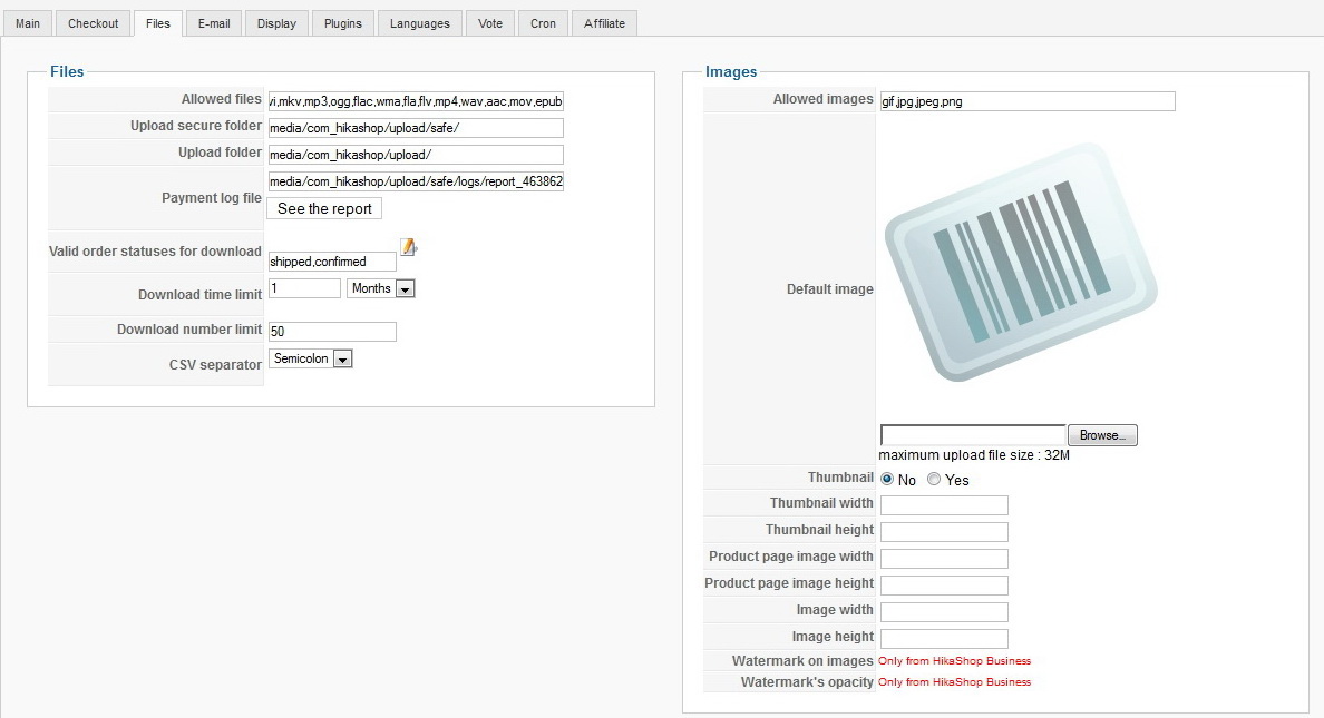

Can you give us a screenshot of your images configuration ? (hikashop > configuration > files)

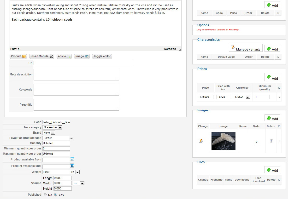

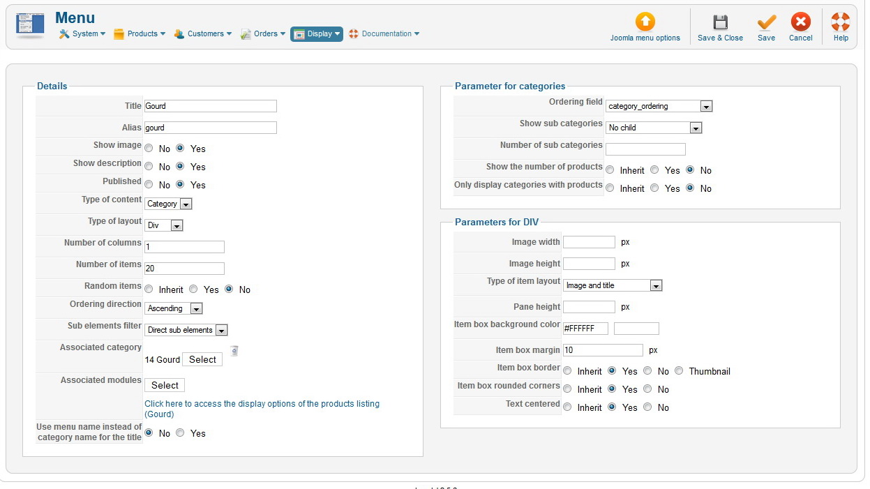

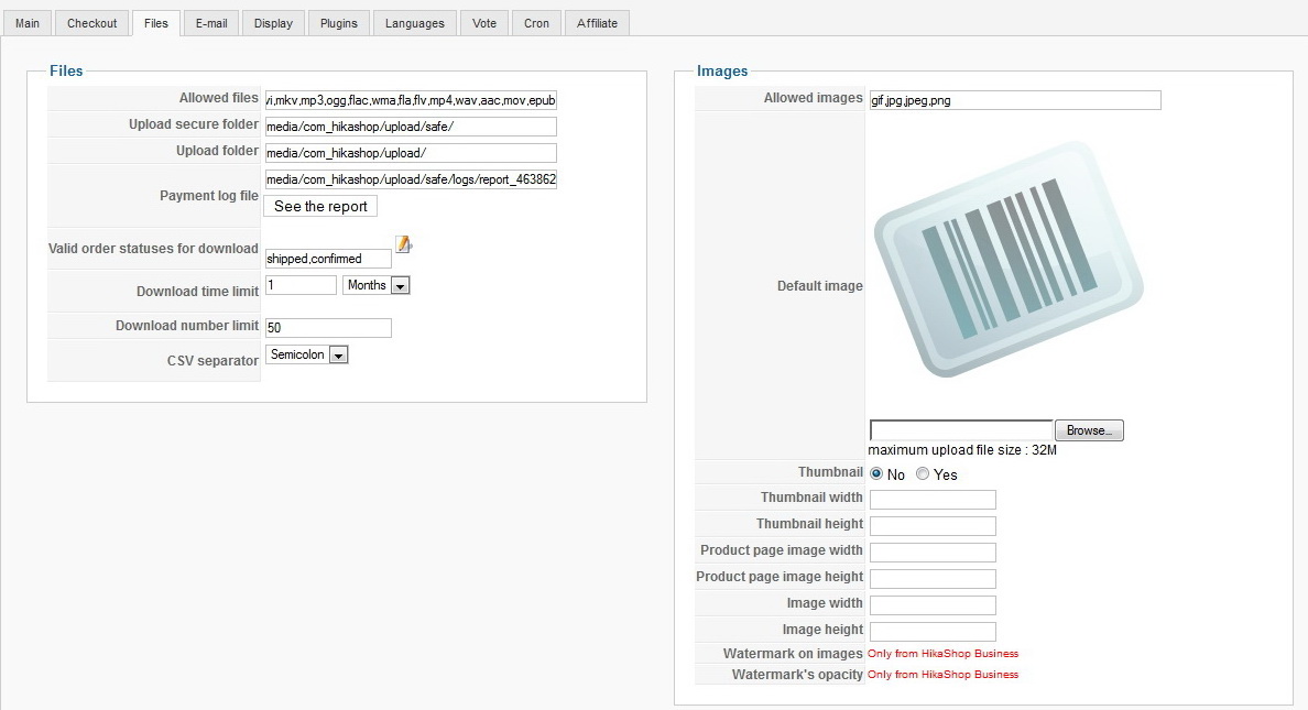

I have added the product image through the "Images" tab (Attachment5). I haven't inserted any images to the product article. Also, I haven't uploaded any images to any Hikashop folder. In Media Manager I don't see any Hikashop folders, either. Hikashop>Configuration>files screenshot is attached (Attachment6).

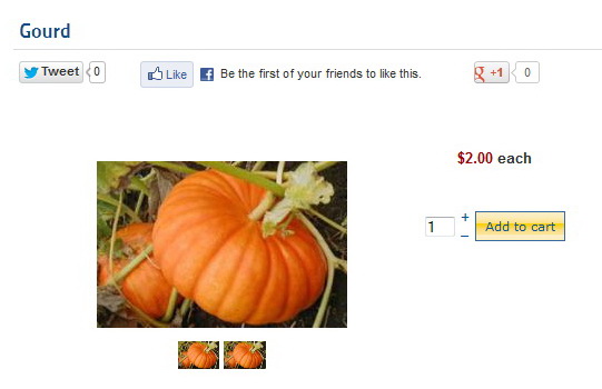

  • Posts: 47
13 years 7 months ago #85364

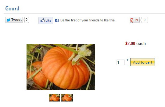

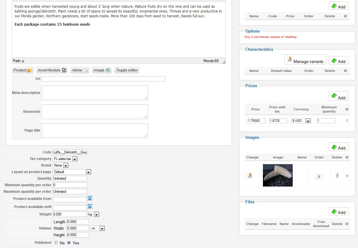

I removed the image and deleted the category. I recreated the category and added the image again. Still cannot display the image. Also, now when I go into the product's page, the image is shifted to the right and product price and # of products are shifted to the left (see attachment).

I upload the product image using the Add button in the Images tab located in the product page. I don't insert any images to the Main Information document. Are there widthxheight limits for the images (i.e. do I need to reduce resolution)?

13 years 7 months ago #85677
Hi Jerome,
Now I checked the Files tab and attached it. It looks like in the back-end everything seems to be the same as you indicated.
Also, I have checked the permissions of the com_hikashop/upload folder, and they are all checked (Read/Write/Execute).
  • Posts: 86112
  • Thank you received: 14210
13 years 7 months ago #85735
I've read all that thread and I think that everyone got confused on a simple thing.
Actually, the reason you don't see the thumbnails on the listing of products is because you changed the "item box layout" option to "title" instead of "image and title" in your products listing module.
The screenshot of the options that you have shown us is the listing of categories menu to which the products listing module is attached. It only affect the categories listing display, not the products listing display.
So on the option page www.hikashop.com/media/kunena/attachments/12567/Attachment3.jpg , you need to click on the associated modules link on the left bottom and that will display the options of the products listing module. There, you can change the layout option in order to display the images.

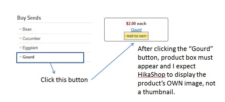

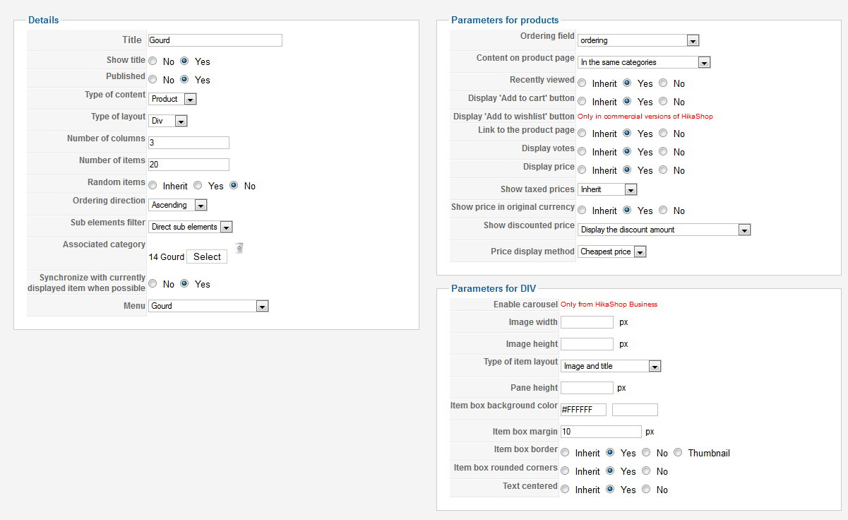

  • Posts: 47
13 years 7 months ago #85845
I am going to walk you through what I have. I do NOT want to see a thumbnail in my product box. I want to see the true image of the product when the customer clicks on a menu. I summarized what I want to do in Step1 and Step2 (attached). Also, I took screenshots of back-end settings (attachments Menu, HikaShop Options, Module). It actually is very simple and I believe could be fixed in 10 secs.
- Are my images supposed to be equal to or smaller than a certain resolution?
- Is there a problem with the module assignment? Instead of assigning a product listing module to my category listing, should I use another module?
- Anything else?

13 years 7 months ago #86030
Hi there,
If I get it, I guess the answer is, as said Xavier, to specify a product image width and height in the global parametre (System>Configuration>Files).
Try to reupload your images after this and tell us if it does the job. Don't forget to leave the module's and menu's dimensions empty if you want the global parameters to be applyed.

Are you talking about the "Product page image width and height" or "Image width and height"? Also should the dimensions that I need to define in the global parameters bigger than the actual image sizes or should they be identical?
