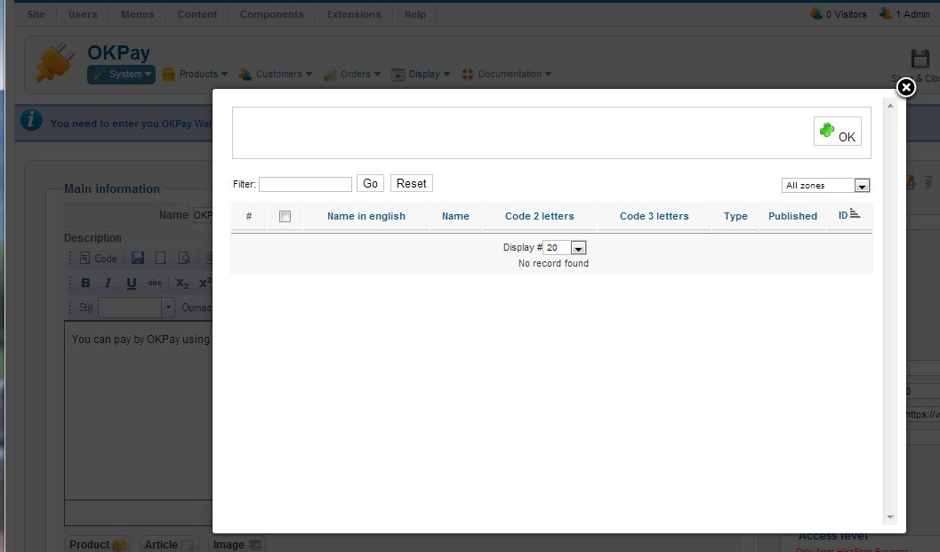

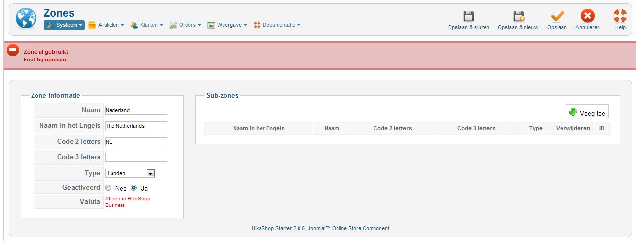

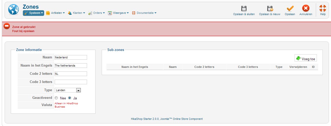

I'm new with Hikeshop and I have a question about zones.
I do not see any zones in hikashop, but when I try to make a new zone I got the answer that there is a zones?
Can anybody help me with this problem?
I attached a screenshot (but it is in Dutch)
Thanks, Gerard
13 years 8 months ago #84038
Hi Gerard,
That's because the "Nederland" zone already exists, You can see it through "Hikashop->System->Zone" (you'll just have to search for "NL" )
Hope this will help you.
  • Posts: 106

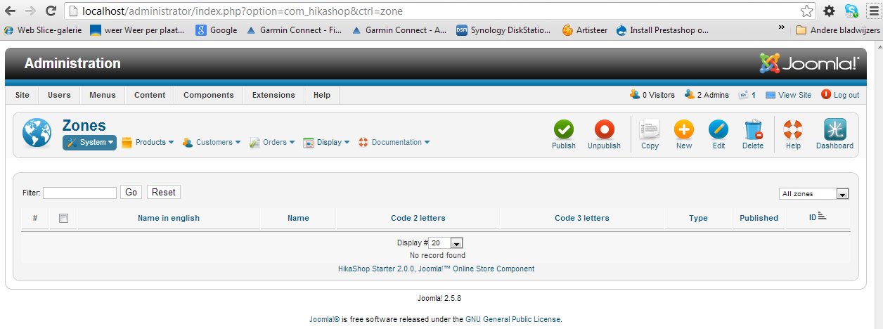

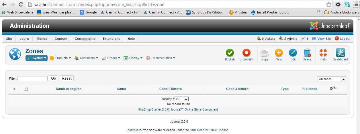

13 years 8 months ago #84048
I can not find any zones, see attachment )-:
Mybe there is a general problem?
See also #83897
Thanks for your fast responds!
I test it with Chrome, firefox and explorer all with the same problem )-:
Also I have a problem: I do not see any zones in hikashop, but when I try to make a new zone I got the answer that there is a zones? (#83647)
Mybe there is a relation between them, mybe the is a database problem???
Thanks for your help, Gerard

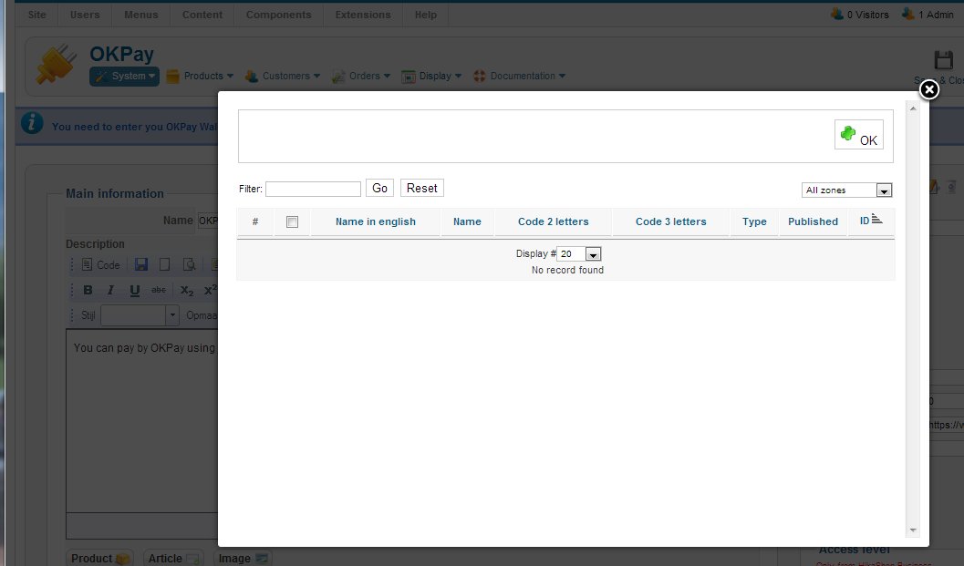

13 years 8 months ago #84059
And do you have some zones when you are using the "Zone" Option of your payment method for example ?
  • Posts: 106
13 years 8 months ago #84088
NO :S

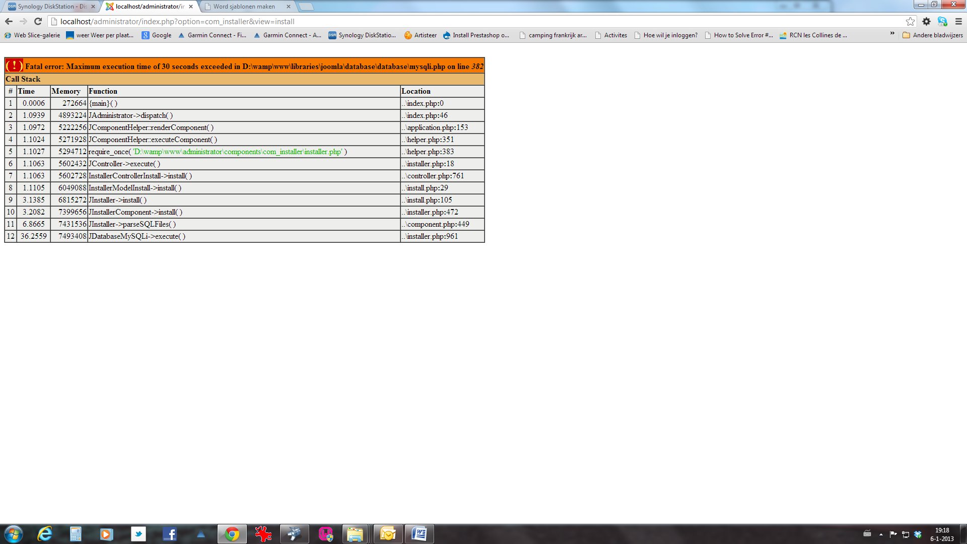

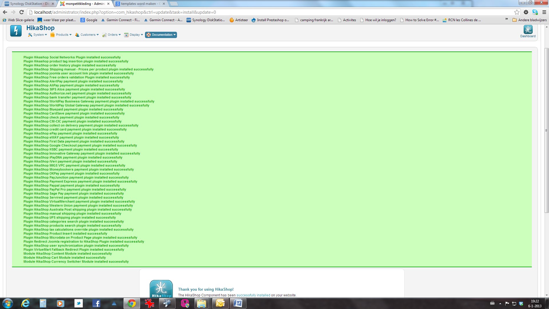

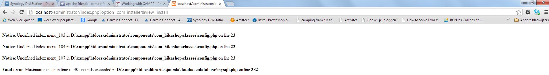

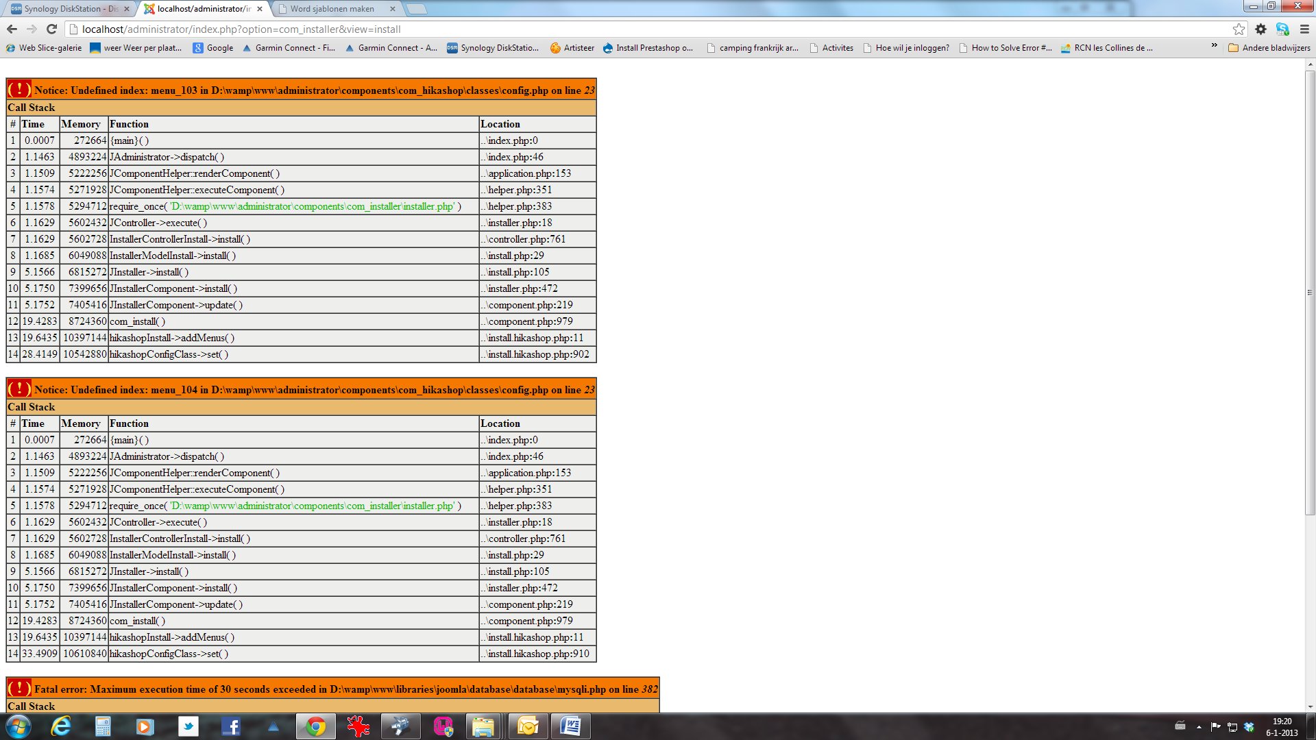

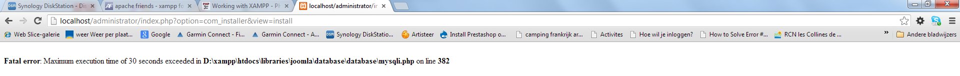

13 years 8 months ago #84264

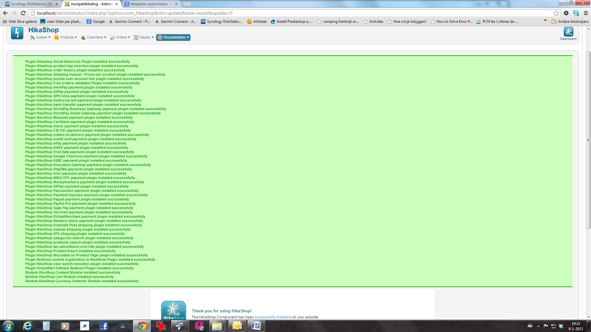

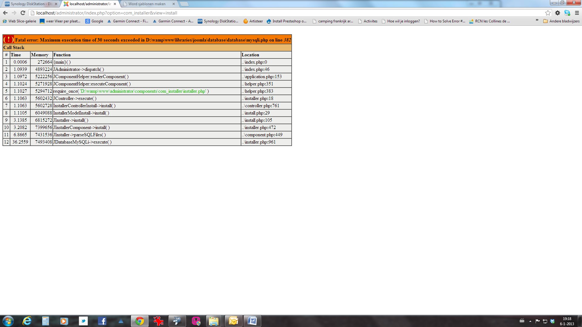

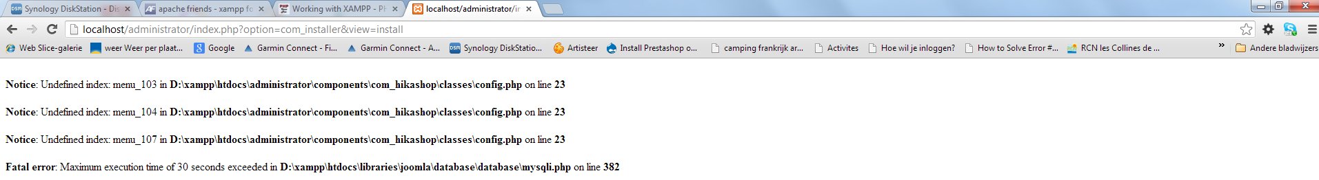

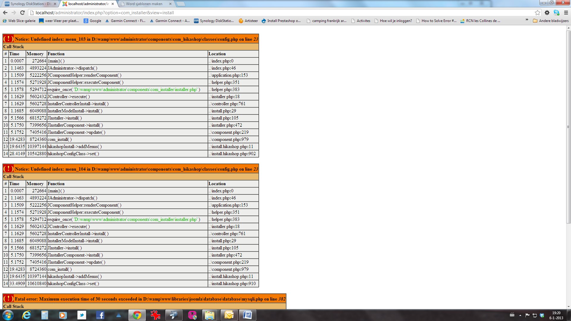

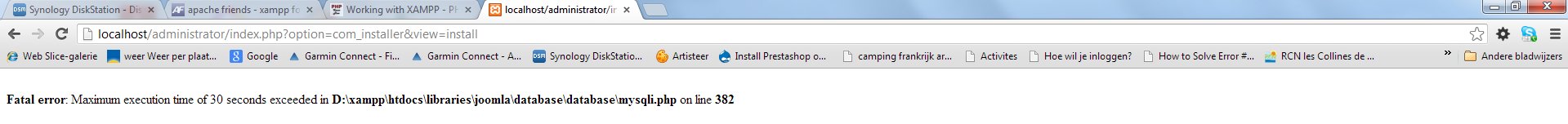

I install joomla and hikashop on a WAMP server.
When I install Hikashop on Joomla I get some errors (see attachments)
The first time I get out of time error.
After a refresh I get more errors
After a new refresh I get the green screen that hikashop install went OK, but I don't have hikashop menu in the components menu?
After a new installation of hikashop in the extention manager I have the hikashop menu.
BUT no zones and also other problems!
I also test this with XAMPP, but the same problems?
So my be this is the problem what I have and that I have different "small" problems.
I hope you can help me.
Thanks, Gerard
13 years 8 months ago #84403
I think that all your problems are related on the max execution time.
Try to edit your WAMP configuration to add more times for the max execution time limit.
This should be in the php.ini file.
The following user(s) said Thank You: gerardtb
  • Posts: 106
13 years 8 months ago #84429
Thanks, this is the solution!
I set the time in the php.ini file to 120 sec. and the installation was perfect.
Now I have all the zones and also no prolems with characteristics :)
Best regards, Gerard
