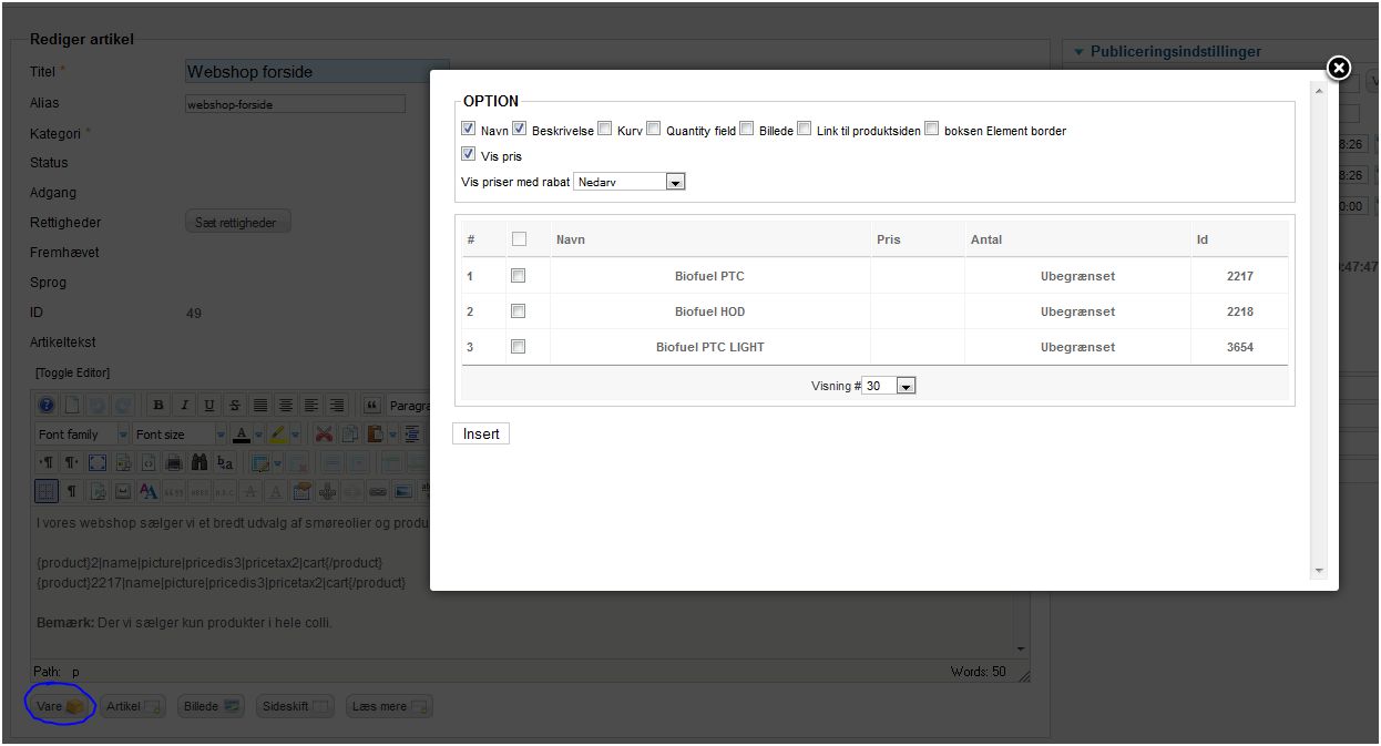

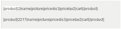

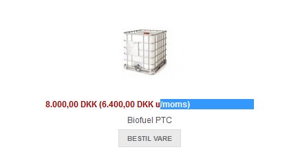

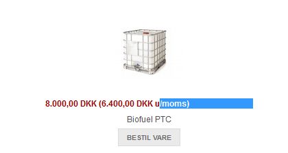

I would like on my shop front do an article with a few products shown.
In addition, I have previously successfully used me to put products into tags, so will I in this game.
But it does not work, I only get the two previous products up on the screen and when I inform the ID so nothing happens.
The two images show my article in jce editor and how the page looks.
I also have links to the two sides, as I mentioned:
bestoil.dk/index.php/webshop-forside
bestoil.dk/index.php/produkter/biofuel-fyringsolie

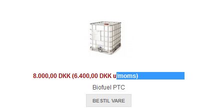

In the picture from the front, I have marked something in blue. is there any idea why there is so much space after the last)? This text is not centered
I'm using firebug, forumsearch, dokumentation and then I ask.. It's so easy ;)

13 years 8 months ago #83874
Your Products TAG plugin seems to be working fine when you are using the good product ID.
1. The product price part is actually centered.
2. Regarding the spaces I think that you should check you translation file through "Hikashop->System->Configuration->Language->'Your translation file'", and see how you have set the "PER_UNIT" translation word.
Last edit: 13 years 8 months ago by Mohamed Thelji.

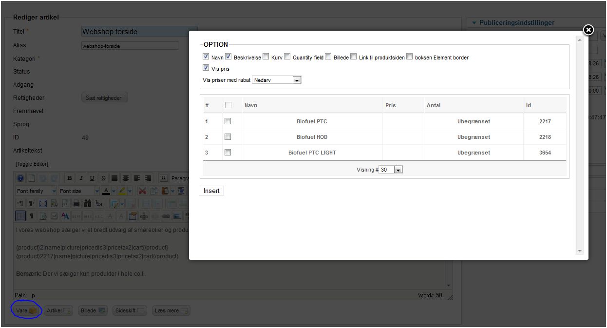

As you can see in my first thread its ID 2, but the system will only show 2217,2218 & 3654
I add a screenshot - it's what I see when I insert a product, there have to be more than 20 pages..

13 years 8 months ago #84583
I just checked your products and the problem come from that the products are restricted to some customer groups, so it's not in the list of products to add in an article.
You have to edit the previous given code and remove the part "AND product_access=\'all\' "
