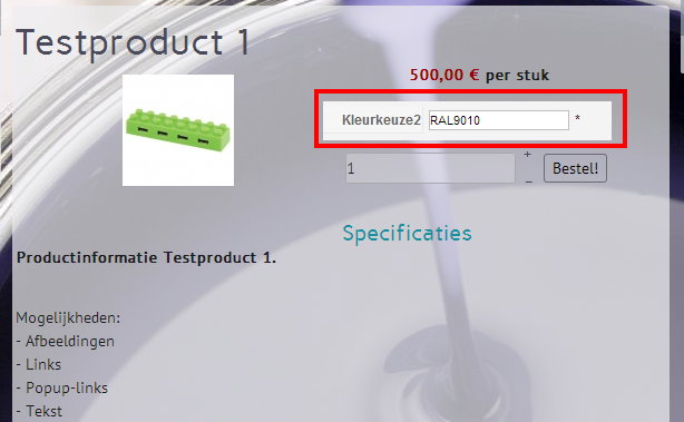

13 years 8 months ago #83892
Hi Jerome,
I thought as much, the problem is that I tried most of the options already. It's easy to add information to the productpage but I would like to add an input field.
In the ideal situation it would look something like this:
The red box is what I would like to add. The customer needs to fill in a paintnumber (eg RAL9010) and then hit 'Bestel' (Put in cart).
If the box is left empty the customer can't order.
The information in the box needs to be in the order confirmation, the invoice and the shopping cart checkout.
Is it possible?

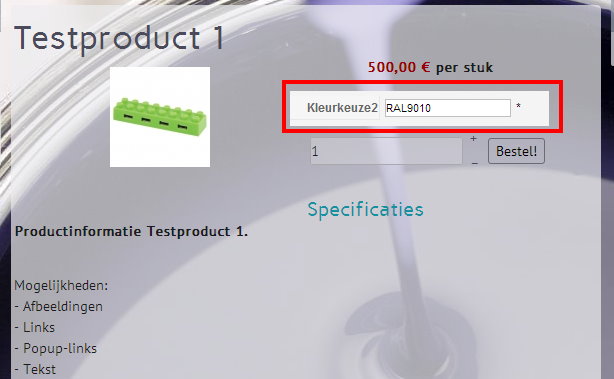

  • Posts: 154
  • Thank you received: 10
13 years 8 months ago #84613
Thanks for your reply,
It works great! It is indeed an option for the business edition and after some fiddling with it I got it to work.
You are (as always) the best!
Proud of my website www.hetcomputerwinkeltje.nl
Currently just running catalog mode, but hope to go live soon again :)

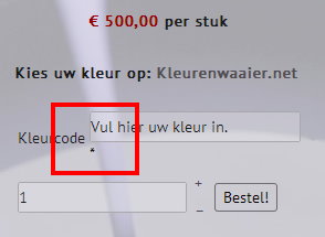

  • Posts: 154
13 years 8 months ago #84621
One tiny little thing, How can I get rid of that nasty asterix?
I need the field to be required, but the asterix is set on the next line :(
Like this:
What do I need to edit to get rid of it? :D
13 years 8 months ago #84684
You can change it by css, use for example firebug to find the class to edit.
