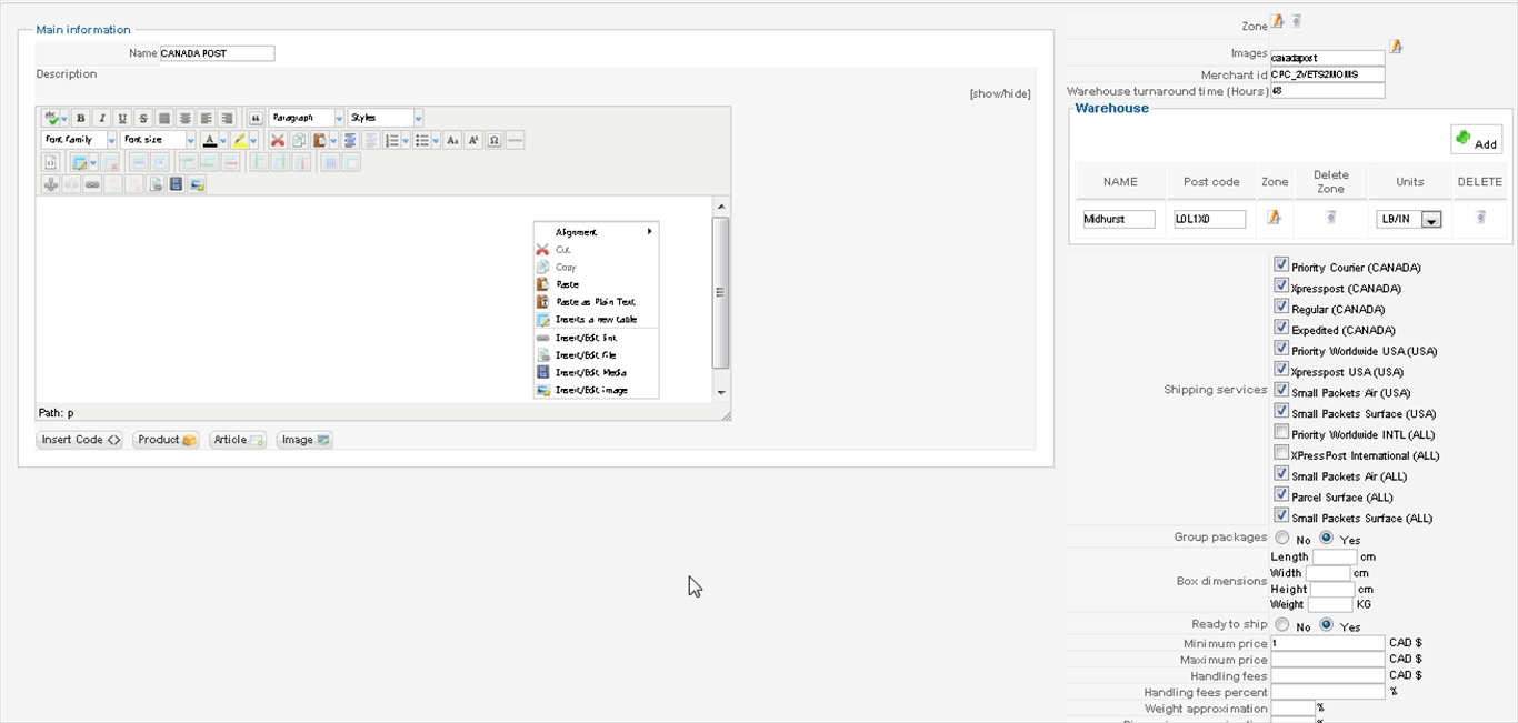

Could you give us a screenshot of your shipping method configuration ?
Are you restricted the shipping to a zone ?

13 years 8 months ago #84564
No, there is not restriction on zone, and there is only 1 address for warehouse and selected all options from Canada Post.

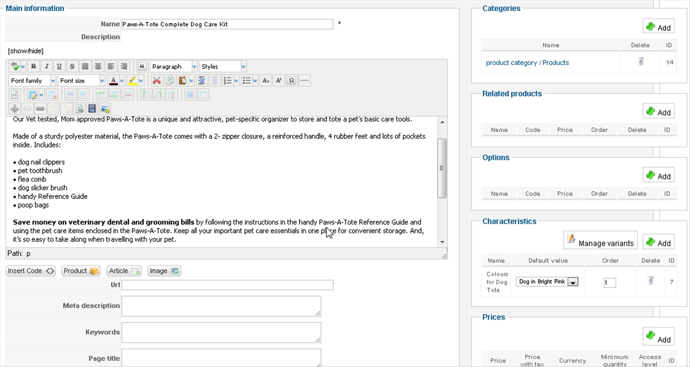

No, the product called "tote and bottle" and the "dog tote" are set up exactly the same (same tax category, dimensions etc) and only the "tote and bottle" calculates shipping. None of the other products calculate shipping either.

Could you post a screenshot of your shipping method configuration, and a product configuration ?

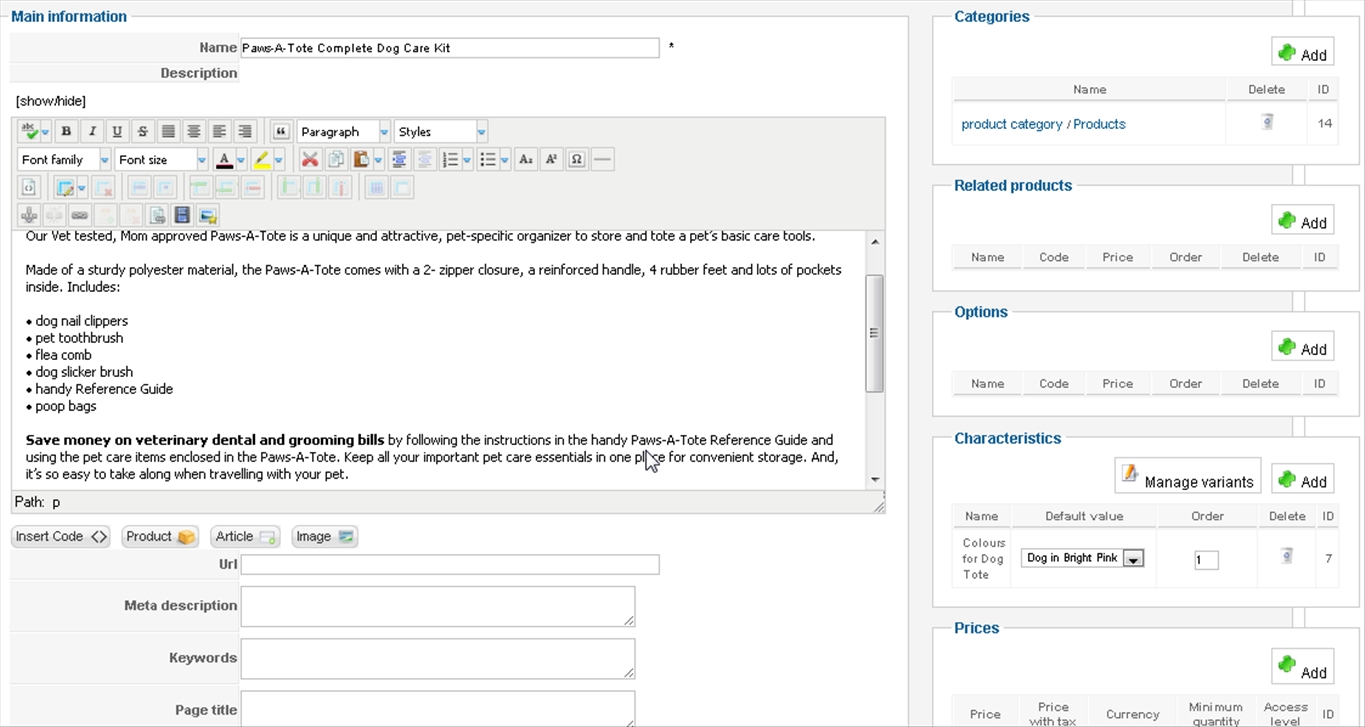

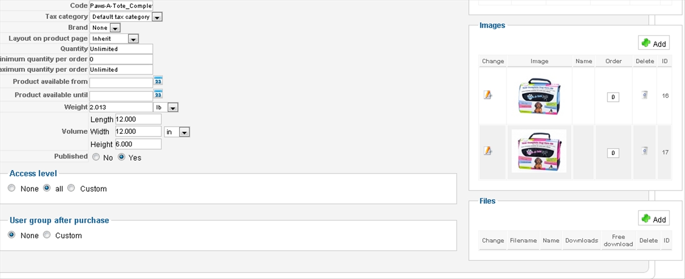

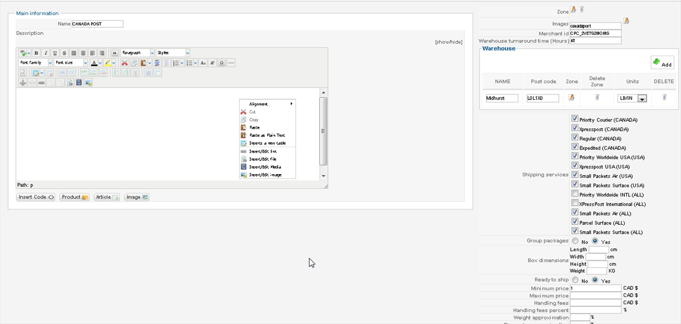

13 years 8 months ago #85087
Here's the shipping methods and a product that shipping isn't calculating on.

I think that it's actually a but in HikaShop where the weight and dimensions of the main product is not transmitted to the variants of the product. That has been fixed on our end and will be in next version of HikaShop. If you add them to the variants, that should work fine. Here is the method:
Go to the Product
Click on Manage Variant - Under Characteristics
Click on a Variant/Characteristics
Input the weight for the Characteristics and save
If it indeed comes from that, you can replace the file administrator/components/com_hikashop/classes/cart.php with the one in the archive below and that should fix the problem
