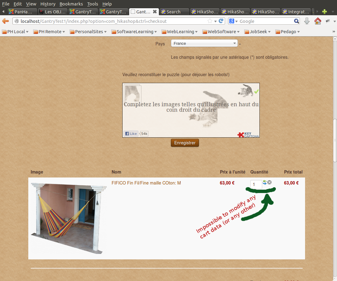

  • Posts: 24
13 years 5 months ago #98020
Hello Hika team,
I would like the keycaptcha to be used ONLY to validate user registration in the checkout process while still being able to modify shipping, payment and cart data.
However, wherever it is positionned, the keycaptcha requires that ALL data for ALL checkout steps be correctly entered before it allows you proceed/modify data.
The information in the posts above addresses the positioning the keycaptcha within the form -- which is already a positive point.
This is the code pertaining to Hikashop in the keycaptcha.php with the $captcha_before line modified to position the keycaptcha.

  • Posts: 86112
  • Thank you received: 14210
13 years 5 months ago #98262
You say it is impossible but you still didn't say what happens. Do you get an error message ? Which one ?
I would guess that you might have a problem when all the views are on one step and that it would work fine on several steps but you're actually saying the opposite. Is that right ? I don't see why keycaptcha would be triggered on the other steps of the checkout even though it is not displayed and that there is no other code related to HikaShop in keycaptcha unless I'm missing something about the keycaptcha plugin.
  • Posts: 24
13 years 5 months ago #98303
Hello Nicolas,
Thanks for looking into this.
It is a nagging problem and I do not seem to be able to explain it clearly.
Here's another try :
In fact, prior to entering correct user registration and resolving the keycaptcha, NOTHING can be changed within the checkout whether it is on one or several pages : it is IMPOSSIBLE to change any of the cart, shipping, payment options.
  • If it is a one-page checkout that includes the registration form and you fill it up correctly and resolve the keycaptcha, only THEN can you access and modify the rest of the data.
  • If checkout is on several pages (and I wish to have my registration form on the second page, with the cart on the first page), it is impossible to move on to the next page as it requests the keycaptcha to be resolved (see error message below). And since this one is on the 2nd page...
The error message is "Error - The solution of task you submitted was incorrect. Please read the instruction and try again."
Which reflects the "expect the keycaptcha to be solved" situation.
I am conducting several tests with previous versions to try pin point the problem but feel slightly out of my competency zone! I am keen on getting this to work as I had security issues through brute force password hacking with my site.
Stephan
  • Posts: 86112
13 years 5 months ago #98450
Ok, I checked the code of the keycaptcha plugin more in depth and I think that there is a bug on the line:
( (isset( $d ) && ($d != '') && ($this->params->get('KC_Register')=='Yes') )) )
it should actually be:
( (JRequest::getString('login_view_action','')=='register' && ($this->params->get('KC_Register')=='Yes') )) )
Try to change that in the keycaptcha.php file of the plugin and that should help.
Whether it works or not, I would recommend you to contact keycaptcha about that as that code is not correct as it will exact the captcha check as long as the registration form was displayed on the checkout page where you did the action, regardless of the action you did.
With my code, I'm making sure that the check only happens when the user clicks on the register button.
