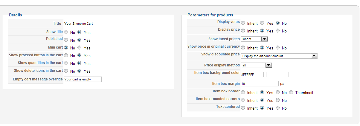

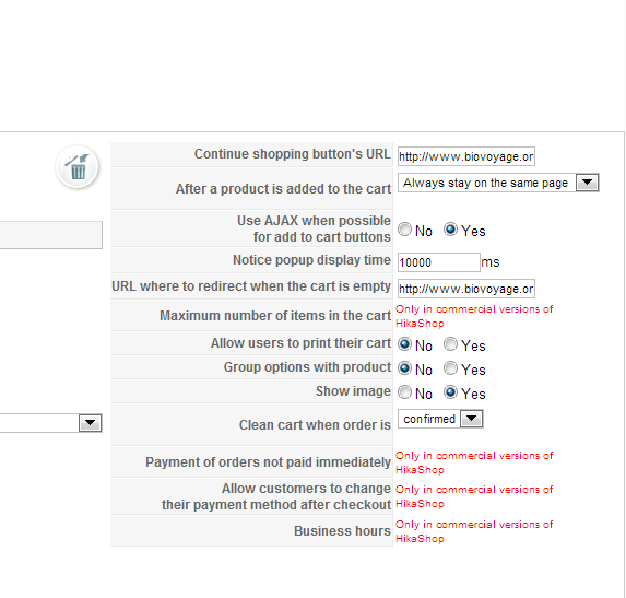

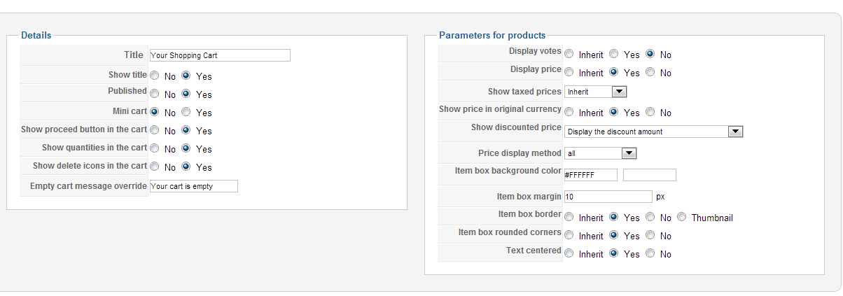

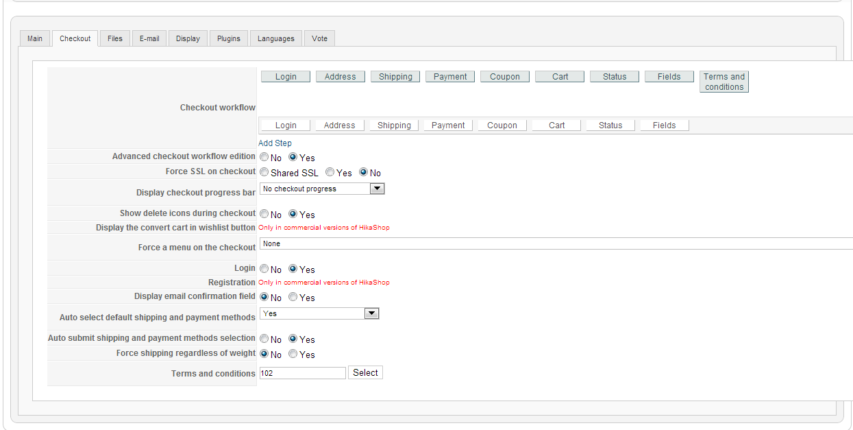

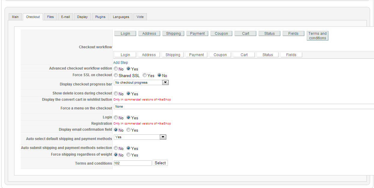

Can you give us screenshots of your module configuration and your checkout configuration please ?
  • Posts: 14
13 years 8 months ago #84937
Xavier wrote: Can you give us screenshots of your module configuration and your checkout configuration please ?

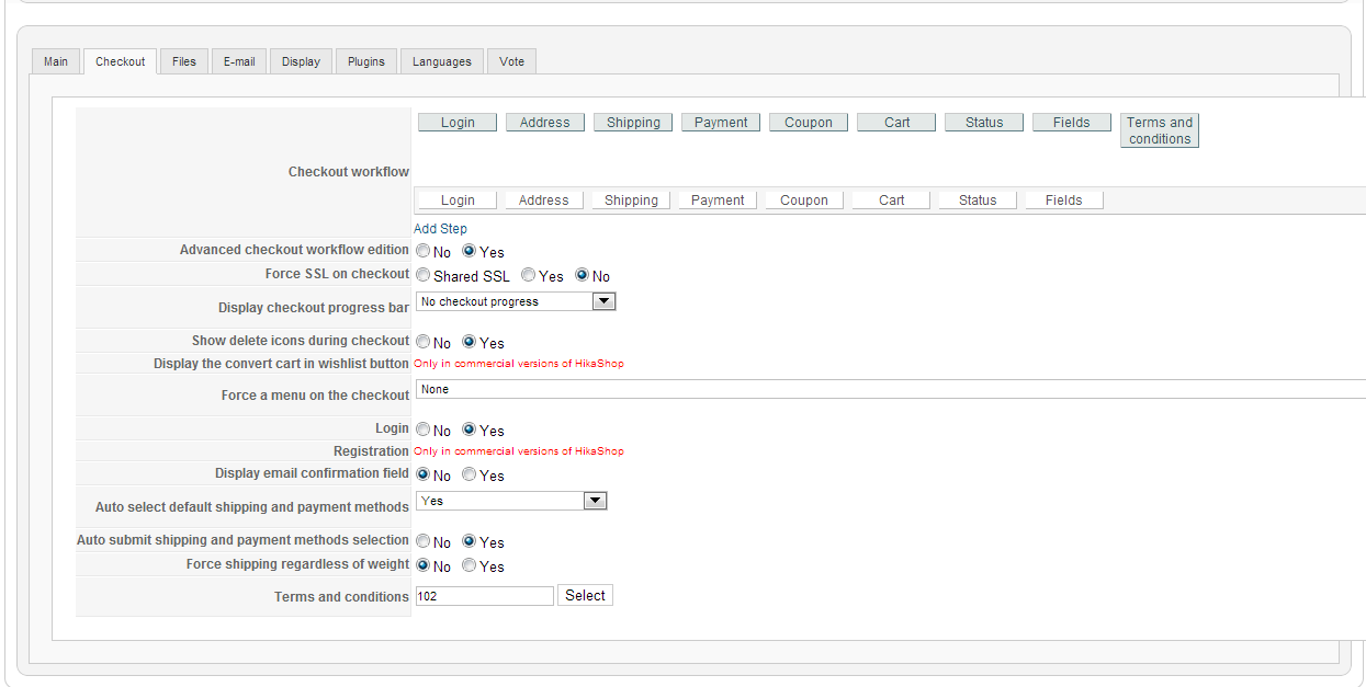

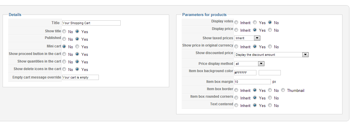

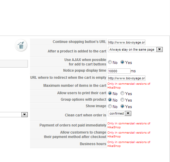

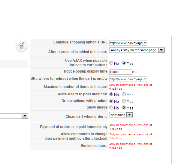

No problem, thank you for your time, Xavier, below are some screenshots, for some reasons, my checkout configuration panel push really far to the right, so I have to take 2 screenshots for the checkout configuration, for "URL where to redirect when the cart is empty", I am using the link for the main store page, thank you very much.

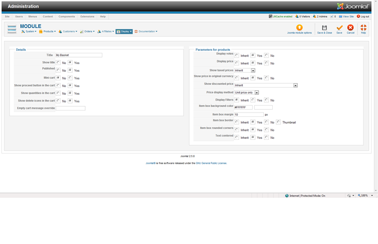

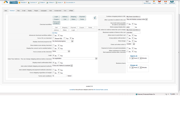

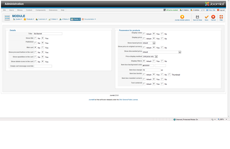

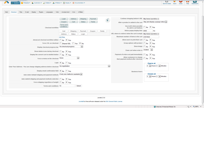

@BasketBox: Could you give us a screenshot of you checkout configuration and the cart module parameters ?
  • Posts: 69

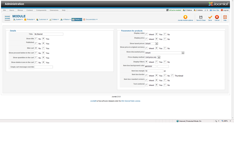

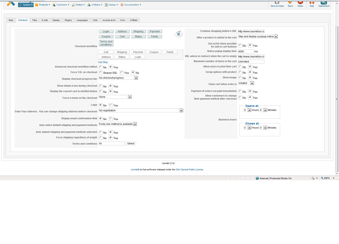

13 years 7 months ago #85799
Attached is the cart module and checkout screenshots. You can also test this at BasketBox.com to see the behavior of the cart module when deleting a product and add to cart from a product page.

13 years 7 months ago #86315
The problem come from your JRoot, a url with "www" is returned, or the base url given by Joomla is without the "www", so the line:
if(strpos($url,HIKASHOP_LIVE)===false && preg_match('#^https?://.*#',$url)) return false;
return false, and don't redirect.
Try to see where the "www" are added to the url, and don't add them.
To find the previous line, go in the file "components/com_hikashop/controllers/product" in the function "updatecart".
  • Posts: 69
13 years 7 months ago #86411
The www is used by our site for SEO purposes. What can we do to use www and return the cart to the correct page? Should this code be changed?
Update:
It's fixed. We noticed in the configuration.php file we had the live site as basketbox.com and we added www to this with the SEO redirect enforced.
Last edit: 13 years 7 months ago by BasketBox.
