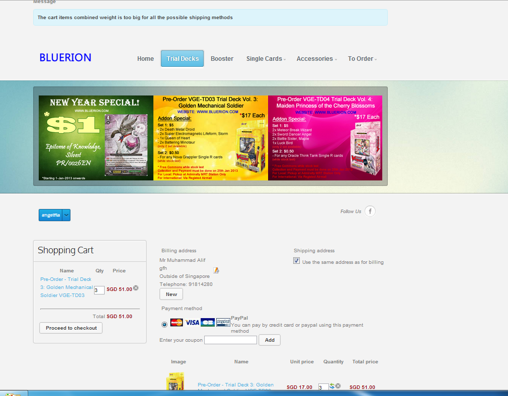

The cart items combined weight is too big for all
  • Posts: 29

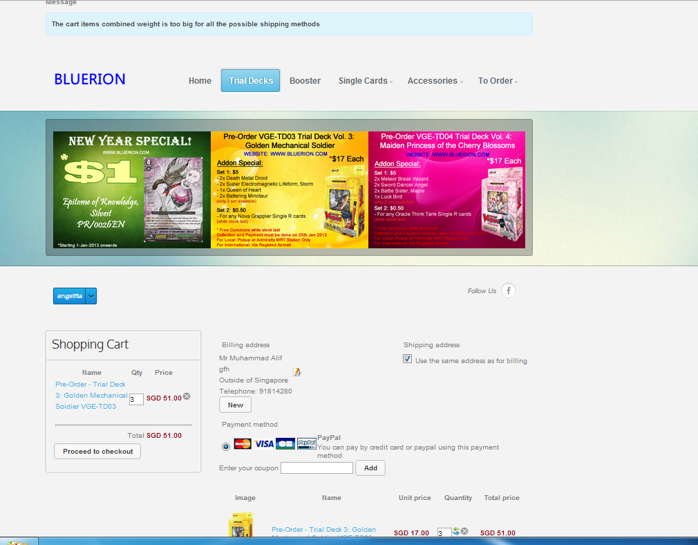

13 years 8 months ago #85090
Manual Shipping between 101g-150g does not display in checkout
Website: www.azurerion.com/test

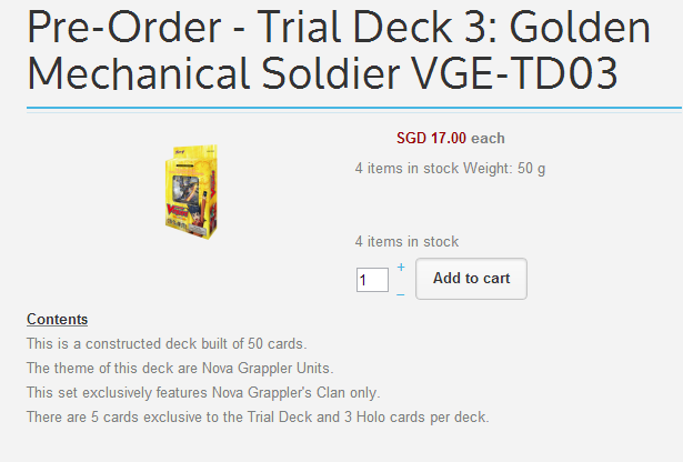

Product tested on:
Pre-Order - Trial Deck 3: Golden Mechanical Soldier
50g each
  • Posts: 86113
  • Thank you received: 14210
13 years 7 months ago #85221
It works fine as far as I can see. On your checkout screenshot, you have 3 products. Each weight 50g so the total is 150g. Your shipping method has restrictions of minimum 51g and maximum 100g, so it's normal that you get that error. I just tried on your website and with only 2 products (100g) the shipping method displays.
As far as I can see, everything is fine.

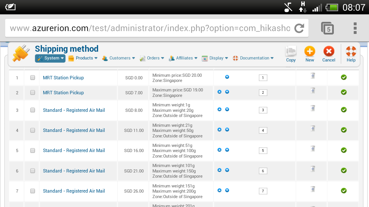

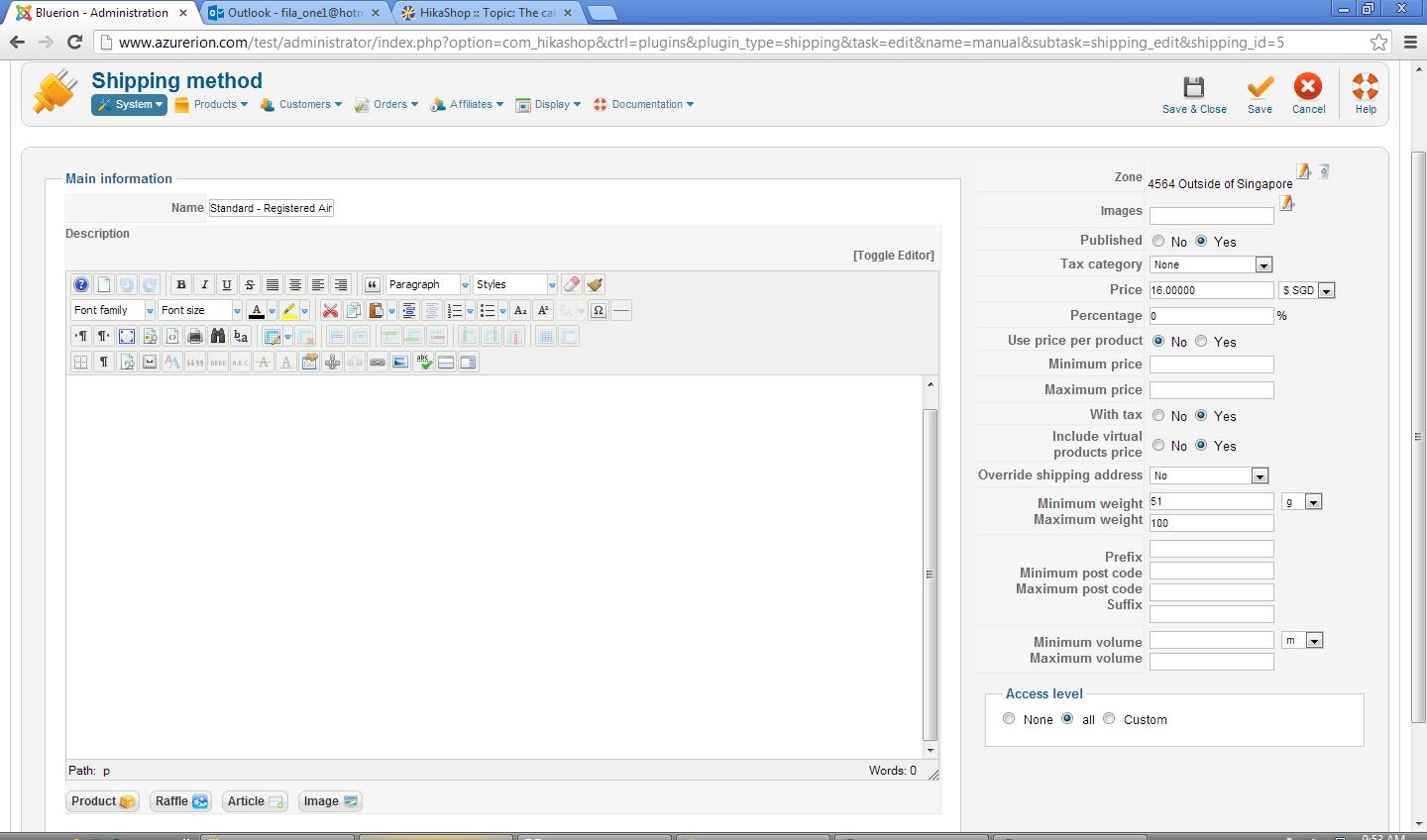

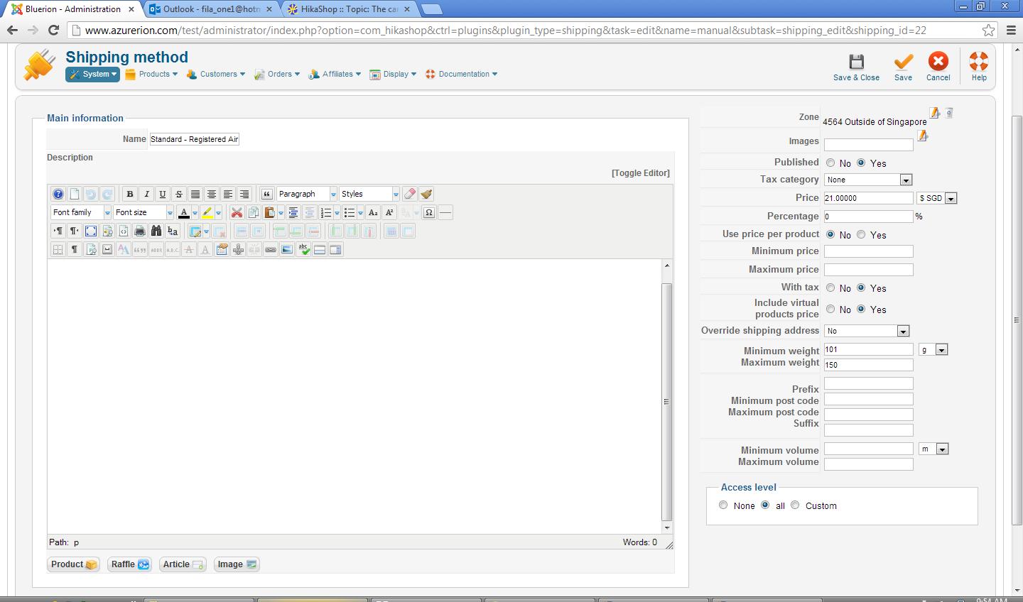

13 years 7 months ago #85469

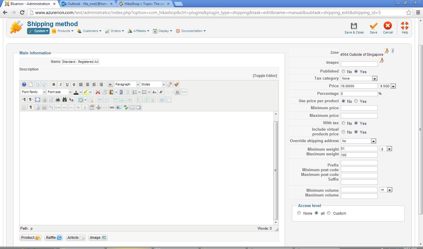

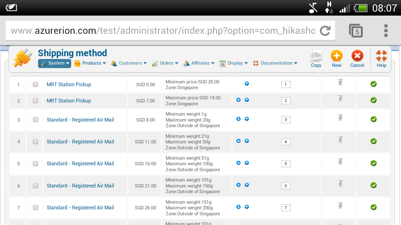

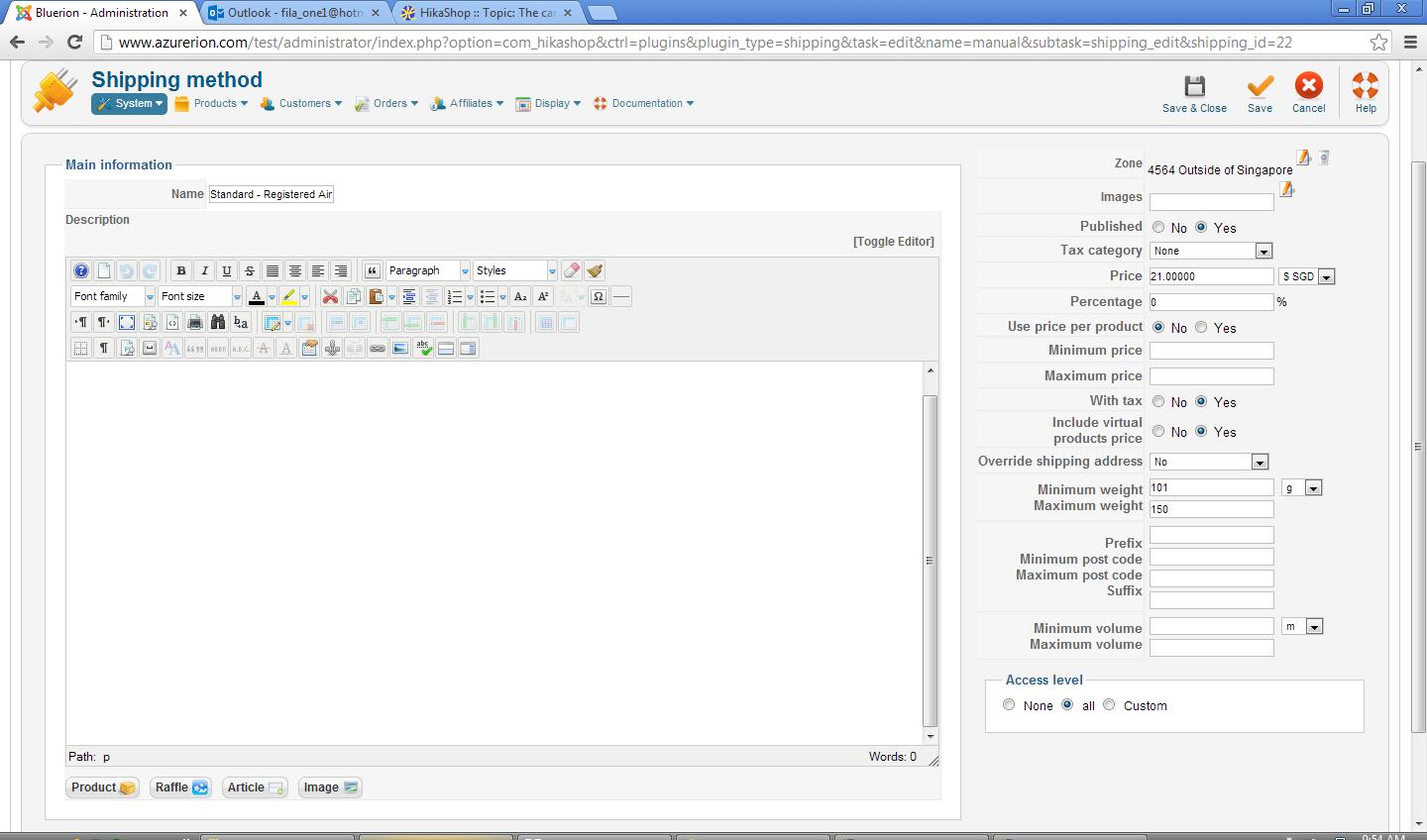

Can you give us the screenshot of this shipping method and of a working shipping method configuration ?
  • Posts: 29
13 years 7 months ago #85544
I have attached a working and non-working configuration screenshot

  • Posts: 29
13 years 7 months ago #85580
I have made changes to air mail - 1 (for 51g-100g)and air mail - 2 (for 101g-150g) respectively.
By the way, only certain products weight at 50g. Most products is at 1g or so (my business nature is selling of Trading Cards either individual or in decks) :)

  • Posts: 29
13 years 7 months ago #85604
- I have delete and create new shipping method- issue persist
- I have delete and copy an existing shipping method and re-configure the settings - issue persist
- I have change air mail -2 range to 101g - 151g - It works but did not show the other shipping range from 151g - 200g, only show air mail -2
