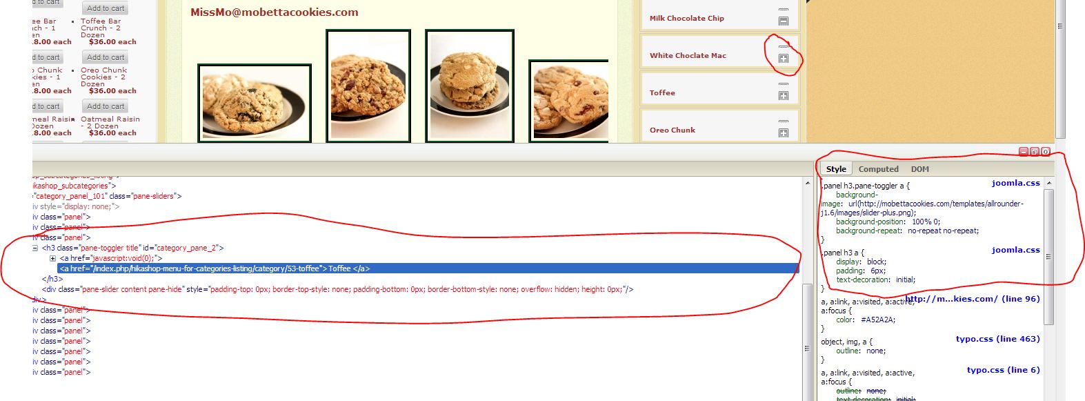

Slider-plus and slider-minus in a content display module.
I am trying to list products but no matter what the "plus" or "minus" sign seems to keep duplicating. (I have attached a file demonstrating what it looks like)
Using firebug I have tried to mess around with the margins and padding for the module but I have been unable to eliminate the duplication.
Thanks in advance.

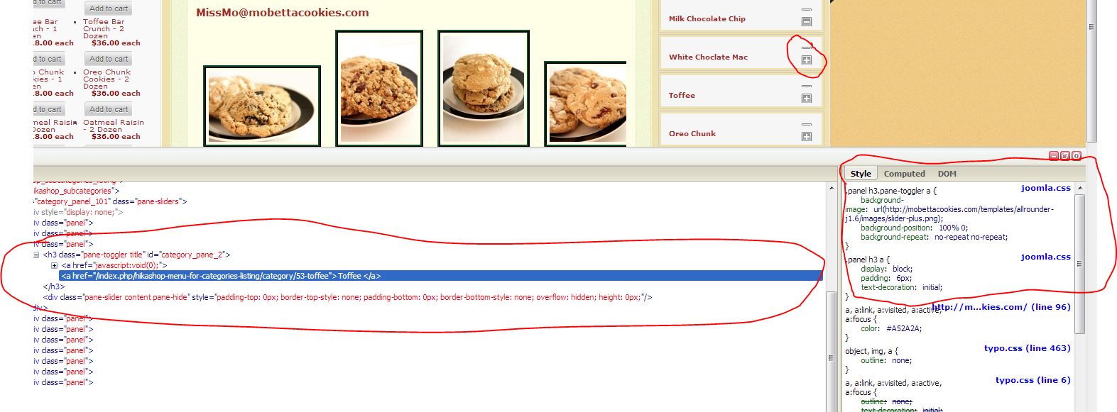

What do you need a link to? I'll post or give you what ever you need. The more I look at it the more I don't think it is a repeat issue. It looks like the bottom portion of the plus or minus sign is being cut off and placed on top of the original image.
I have tried to attach a better picture with the css code for that panel.

13 years 7 months ago #85291
You have to "a" link in your toggler. That's why you see two images.
The first one it on the top, the second one have the complete image at the right.
Look at your "<a href="javascript:void(0);">".

13 years 7 months ago #85402
Hi there,
I just looked at your code and as Jerome said, the problem come from a line which shouldn't be there (it's visible on your second screenshot).
the <a href="javascript:void(0);"> is the origin of the problem.
The point is that this line isn't generated by Hikashop but by Joomla.
I tried on our test website and it's working fine so I guess the problem doesn't come from our side.
Did you edited any view or anything which possibly affected the way Hikashop is functioning? It looks likes a link is given to the parent where there shouldn't be any link.
The result is an <a> tag in a <span> tag in another <a> tag. That's why you have an empty <a> tag which display the background and thus a part of your + button.

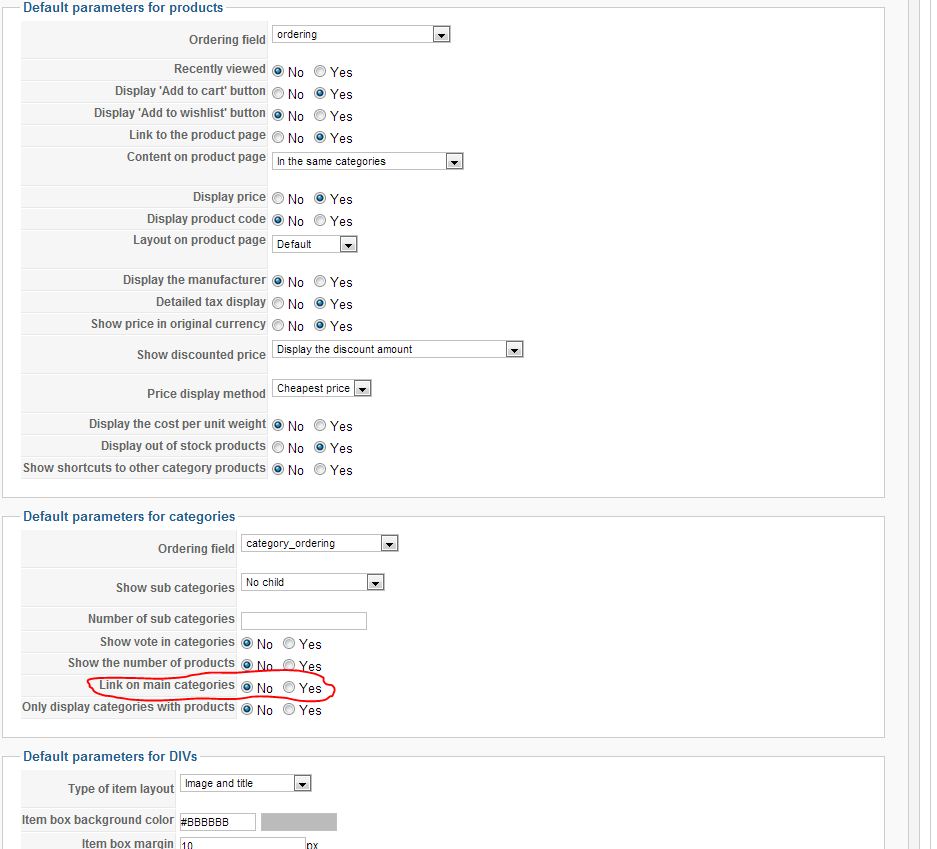

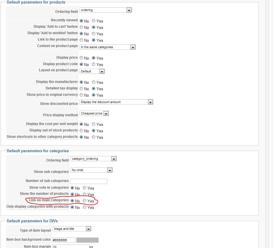

13 years 7 months ago #85578
Hi again,
After looking around the module options, it actually looks like the problem come from our end.
I guess you are using the "link on main categories" option and that's the source of your wrong display.
Just turn this option off and it will solve the problem, we will look forward to solve it on our end ;)
EDIT: Here is what you have to do to solve the problem without changing this option.
Just add this css code to your frontend css file in System>configuration>Display
.panel h3.pane-toggler > a:nth-child(1),
.panel h3.pane-toggler-down > a:nth-child(1) {
	padding:0px !important;
	margin:0px !important;
It should do the job ;)

13 years 7 months ago #85641
I never had it set to "link on main categories"
But I will add that css as you state...fingers are crossed on my end that i put it in the right place and in the right format.
