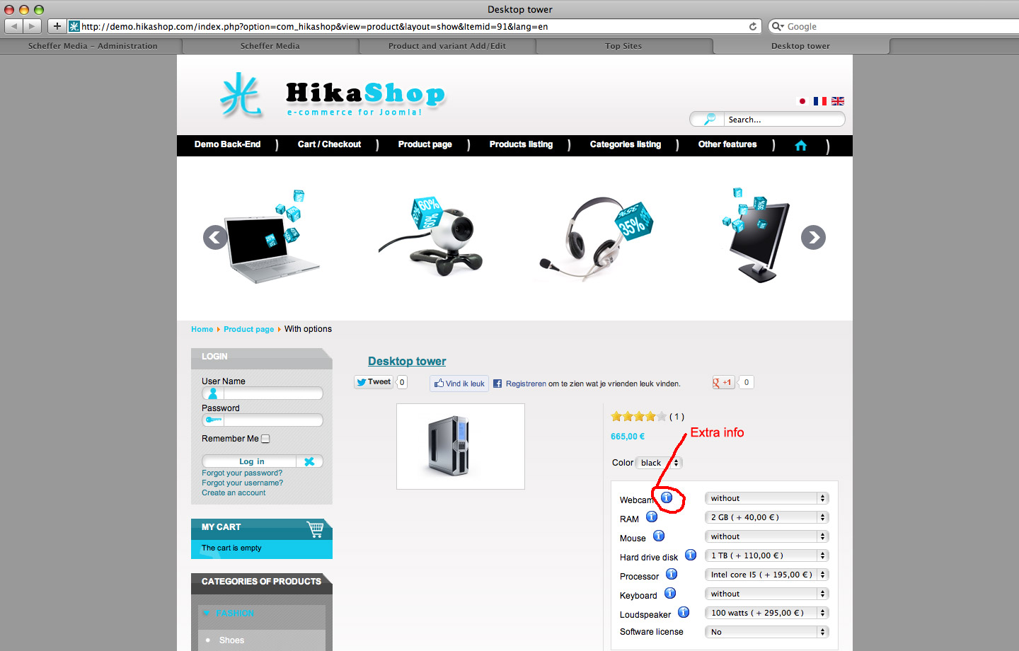

On the demosite (see attachment) the product shows a info sign for additional info. How can you add this to your options?
I searched for the answer in the demo but could not find it.
Who can help me?
Dizma

Hi there,
This icon automatically appears if you have a product with an option which already have characteristics.
I know can be unclear, so in this case you have a product (webcam) which have 2 characteristics (the characteristics displayed on the right).
And this webcam is added as an option to the main product.
And there you go, here is you icon!

If you got multiple characteristics the info illustration does not automaticallly appear. B)
To make the icon appear, you have to fill in the url field (first field beneath the product description) from your option product with a url link.
Et voila! :)
