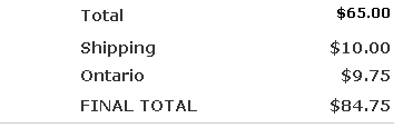

As per the attached pic, the calculation is correct but where it says "Ontario" it should say "Tax".
Why is it showing Ontario instead of the word Tax?

Hi there,
Ontario is the tax namekey, just change it to whatever you want to be displayed.

13 years 7 months ago #86553
Oh I was doing it wrong. I was adding the location name.

13 years 7 months ago #86561
It seems that I cannot have more than one Tax namekey with the same name. I need to have different tax rates set-up and I want to name them "Tax" but each time I create one it replaces the other.
How can I do this please?

My solution would be to name all your "Tax namekey" like this : "TAX + rate" .
Example : Tax(19.6%)
Hope this will help you :).

Oh boy... is that the only solution 'cause the client doesn't like that :( . She just wants them to say TAX.

Another solution is to edit the view "checkout / cart" and change the line displaying the tax to set a fixed name "Tax".
