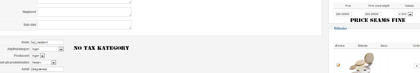

13 years 7 months ago #86854
Here you can see it

  • Posts: 23
13 years 7 months ago #87824
Hi.
Yes i tryed all that. If i select none tax category or unpublish it, the price shows up without tax in frontend. Still if the price in backend is 100 it shows up as 80 in frontend, becaurse the tax is 25%

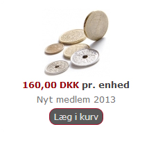

True, you can do that. But my whole problenm is that is NOT the right price that shows up on the front end.....here is how:
In back end price is 100 without tax, and 125 included tax (tax in 25%) BUT if i either show the price without tax, or unpublish the tax rate ect, the price in the frontend shows up at 80....not 100 as its state in the backend. This have been my problem since start.........

13 years 7 months ago #88371
I don't see how that's possible unless you have configured a 20% discount on the price of your products.
HikaShop cannot technically display a price lower than both the taxed and untaxed price from the backend.
I would recommend you to check your discounts.

  • Posts: 23
13 years 7 months ago #88385
THATS IT :-)
In the early beginnng of this shop i was playing around with cupons, but i didn´t realise i actually was setting up a discount. Thx alot :-)
