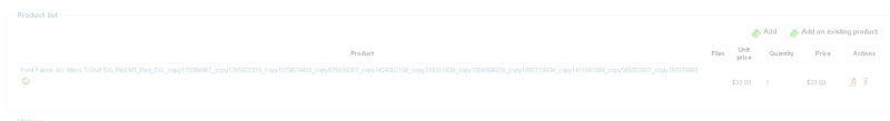

Just come across a major stumbling block for my website. I've gone to print out my first invoices and discovered that the product description is ridiculously long.
Because I have used the copy feature when adding new products (because I have so many characteristics) the invoice is showing all the copy functions.
Could you please tell me how to fix this? I need it only to show the item title, and each characteristic title. (eg. for the image attached it should show only "Ford Falcon AU: Mens T-Shirt 5XL Red")
It is also ESSENTIAL that the sku of the parent product is shown.
This is stopping any orders from being shipped so I really need this fixed urgently.

13 years 7 months ago #86719
I don't see anything on your screenshot.
To reduce the name, try to edit the view "order / invoice" and you can edit it too in the view "order / listing", views are in HikaShop > Display > Views.
