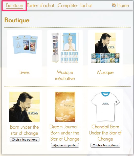

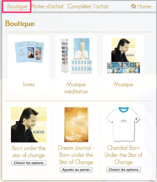

Thanks for your reply. My shop is accessed with one single joomla menu called boutique:

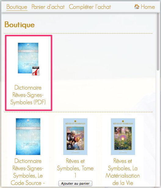

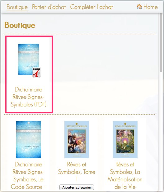

Then navigation goes from category to category. For exemple, I click on Livres (books), hikashop displays the book category and its products:

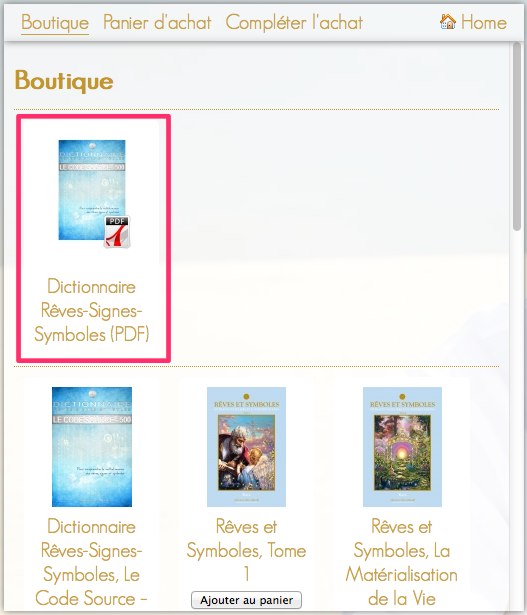

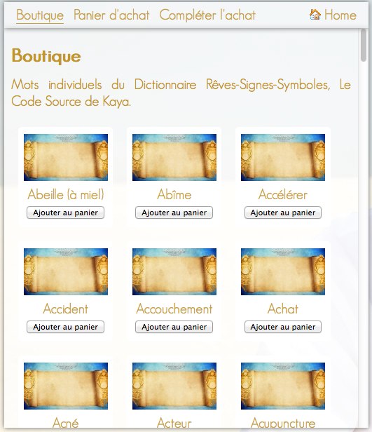

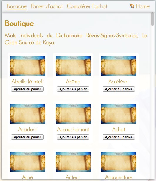

Then if I click on the Book subcategory called "Dictionnaire rêves-signes-symboles pdf", hikashop displays that category in the same manner as it displays the other categories:

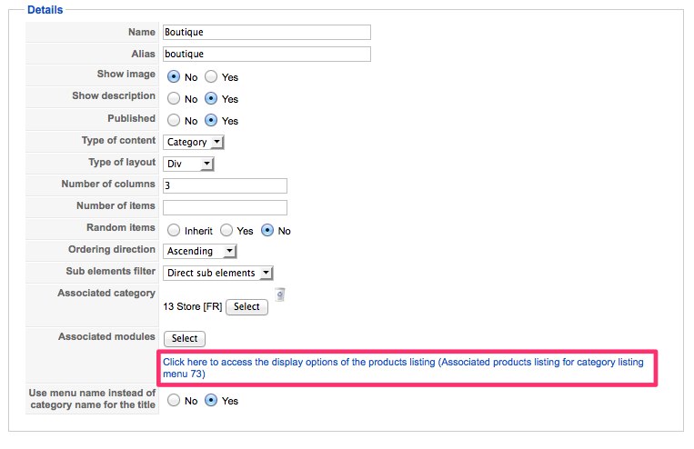

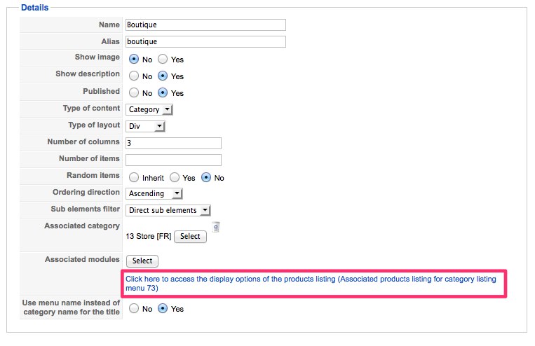

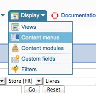

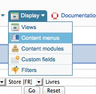

I can modify the display of all my shop categories by going to Views->Content menus->Click on Boutique menu->Click on the associated module:
This will affect the display of ALL my categories. What I want is to modify the display of JUST the above category, ""Dictionnaire rêves-signes-symboles pdf".

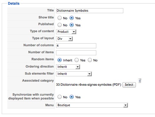

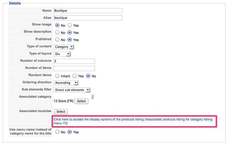

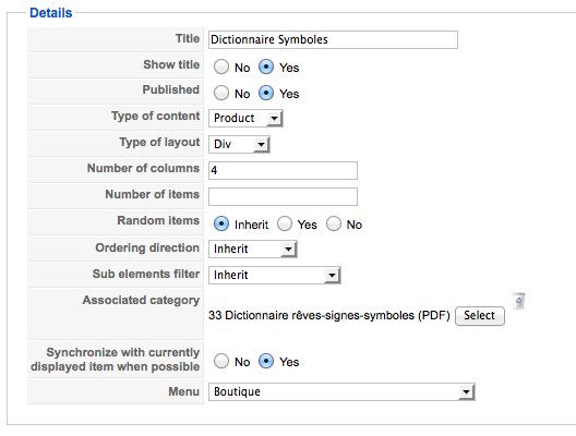

I tried to create a content module, change a few parameters (number of columns, add to cart button, etc) and associate it with this category like this:
But it doesn't work, the category is still displayed like the others.

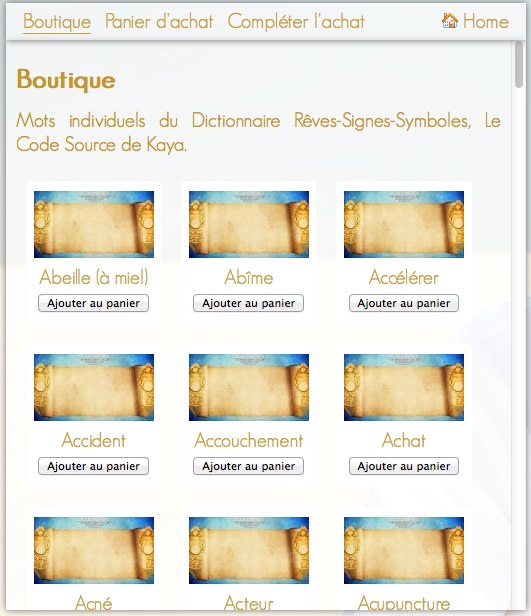

Thanks for your reply. Since that category contains 600 items, compared ~12 for the other categories, its display requirements are quite different. I want 1) to include pagination 2) include an add to cart in the category listing 3) display the title only 4) override the view so I can filter out by first letter (A B C D E F, etc)
