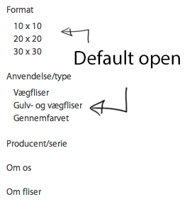

I made 2 different content module containing a listing of some specific categories, and it's being shown as an accordion menu.
My issue is the subcategories by default is shown. And I need to click on the "toggler-div" to hide/close it again.
How can I change the default setting, so the subcategories is by default hidden?
I've attached a screenshot of how the menu is by default.
