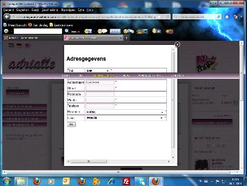

How to solve this problem?

Hi Vero,
The attached picture is too small to let us look at your issue.
Plus you should at least explain what's the problem or give us a link so we can observe it.

eliot wrote: Hi Vero,
Eliot,
The problem is that the menu is displaying over the popup, i'm not sure how to fix this personally though so sorry Vero.
I'm not an expert at this, if i post on your thread i'm doing so with the best of my knowledge and just trying to help :)

Hi Vero,
As I said, we can't do anything without a link to your site or at least a bigger screenshot.
From what I can see, I think it comes from your template and the menu which is using specific css rules.
In this case we can't do anything since it will be over every popup so the only solution is to edit your template css.
I think that´s something about z-index. In template horizonyal menu z-index=100000. But i didn't find popup z-index. If I do this on = 100100, than popup wil be up. That's right or no? But I am looking for popup in custom front-end CSS and don't know where is it...
13 years 7 months ago #87118
The popur CSS is not loaded in the HikaShop css files. Try to change it in your template file, or simply reduce the menu z-index.

Xavier wrote: Hi,
Is there impossible don't show popup, but normal tab on the page?

That's not possible. It has to be in a popup.
However, the popup is displayed by the joomla system (it's a standard thing) and we don't control the menu.
So it's not something we can fix in HikaShop.
That's something which should be fixed in the CSS of the "stuff" (a module ? your template ?) which displays that menu bar. As you say, it's probably just a matter of z-index. But I can't say exactly. We would need to be able to analyze the CSS of the menu bar for that but you didn't give a link to that page.

My website is not online. Template is with Artisteer software made. Early was no problems. I can give you the template or my inlog codes, but not in the forum.

You should try to post a message on the artisteer forum to know how reduce the menu z-index.
Or use something like "firebug" to find which css class is to edit, and change the z-index value in the template css file.

Z-index of pop up is 65000. My template hmenu z-index was 100000. I changed it to 65000 and now is okey! Thanks for reactions.
