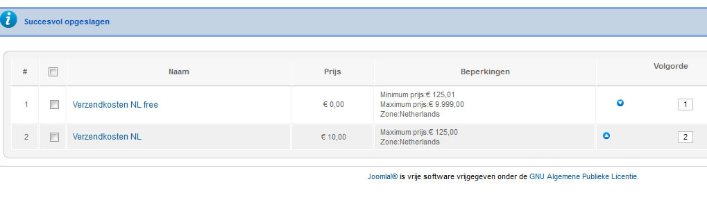

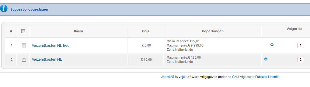

gasoline wrote: Yes, that's what I aim for. But it always charge 10,= euro. Even if the order amount is (way) above 125,=.
What are your settings?

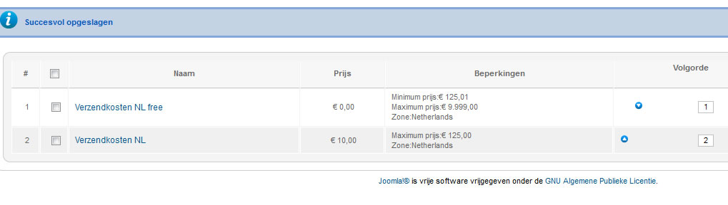

For a free delivery it should be something like:
ignoring the zone being United Kingdom part.
I'm not an expert at this, if i post on your thread i'm doing so with the best of my knowledge and just trying to help :)

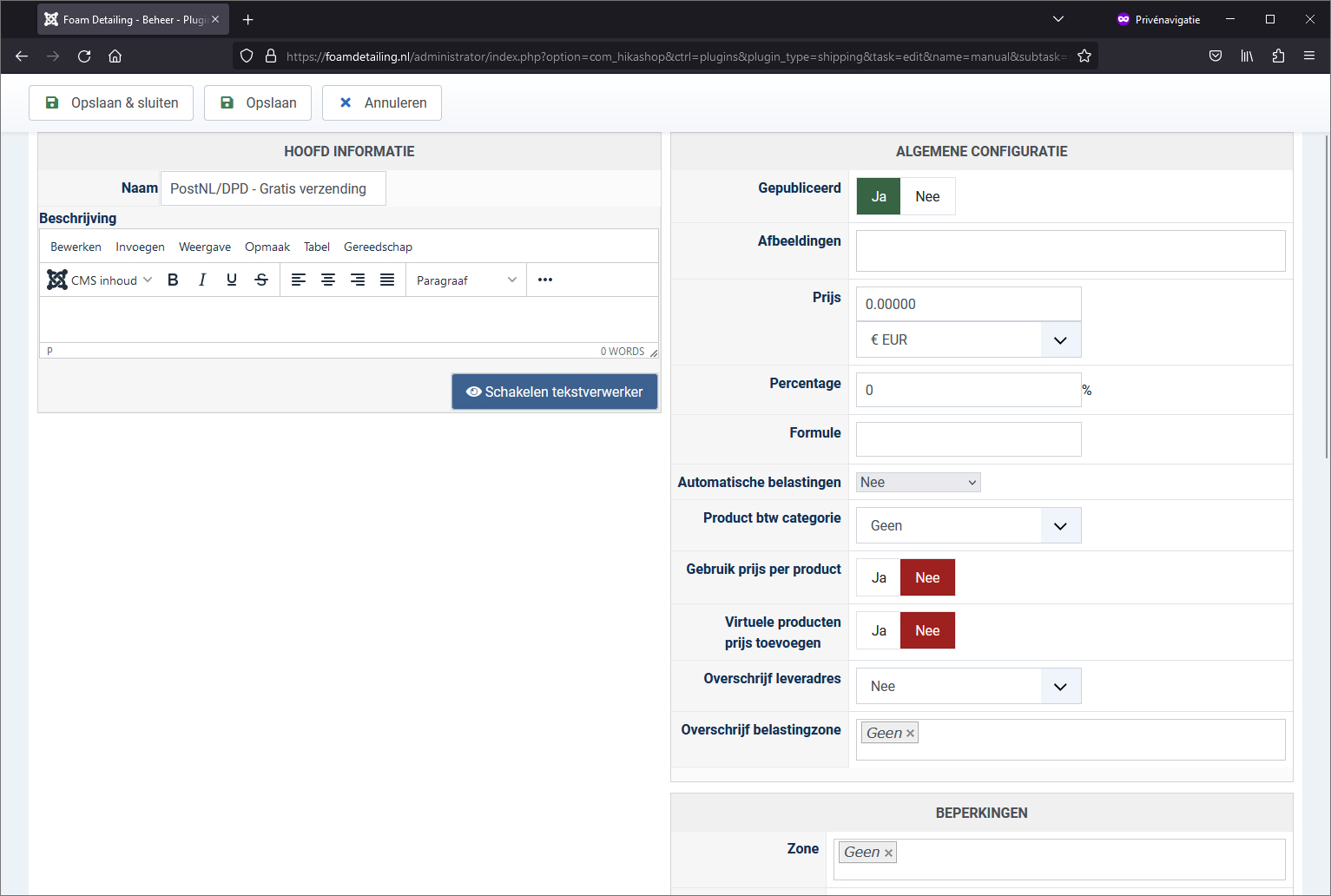

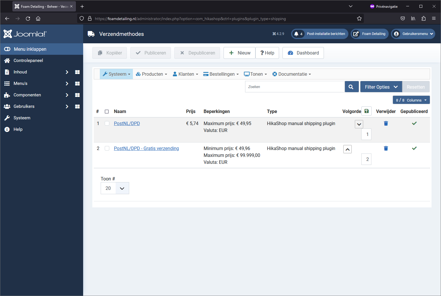

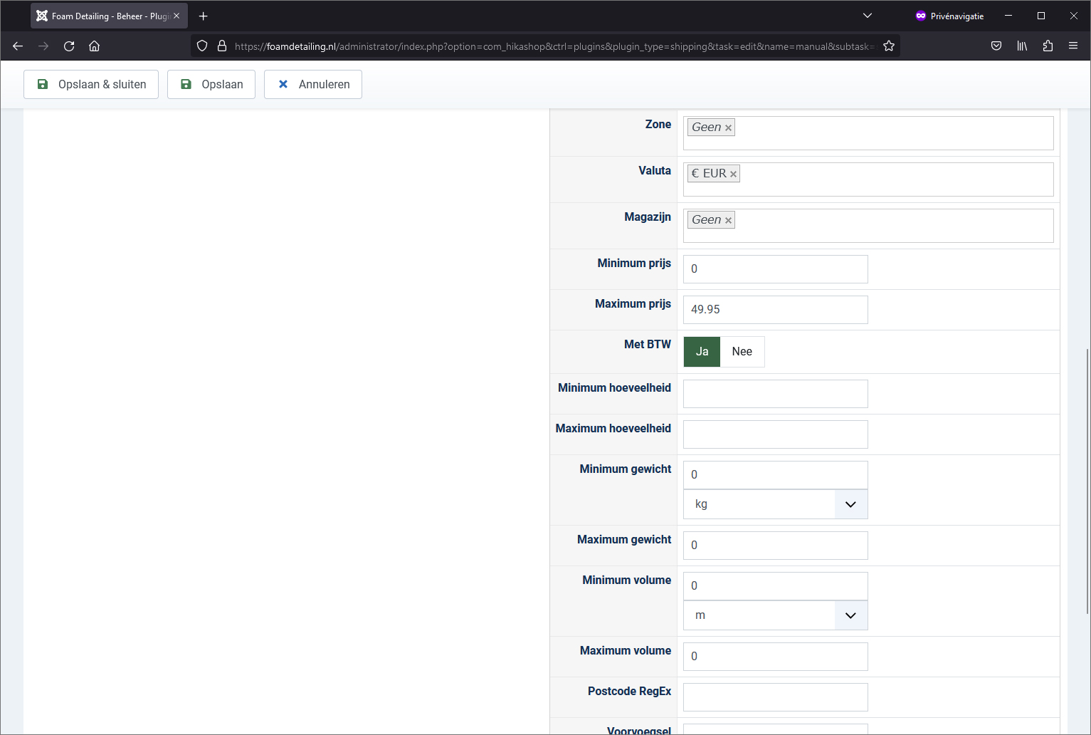

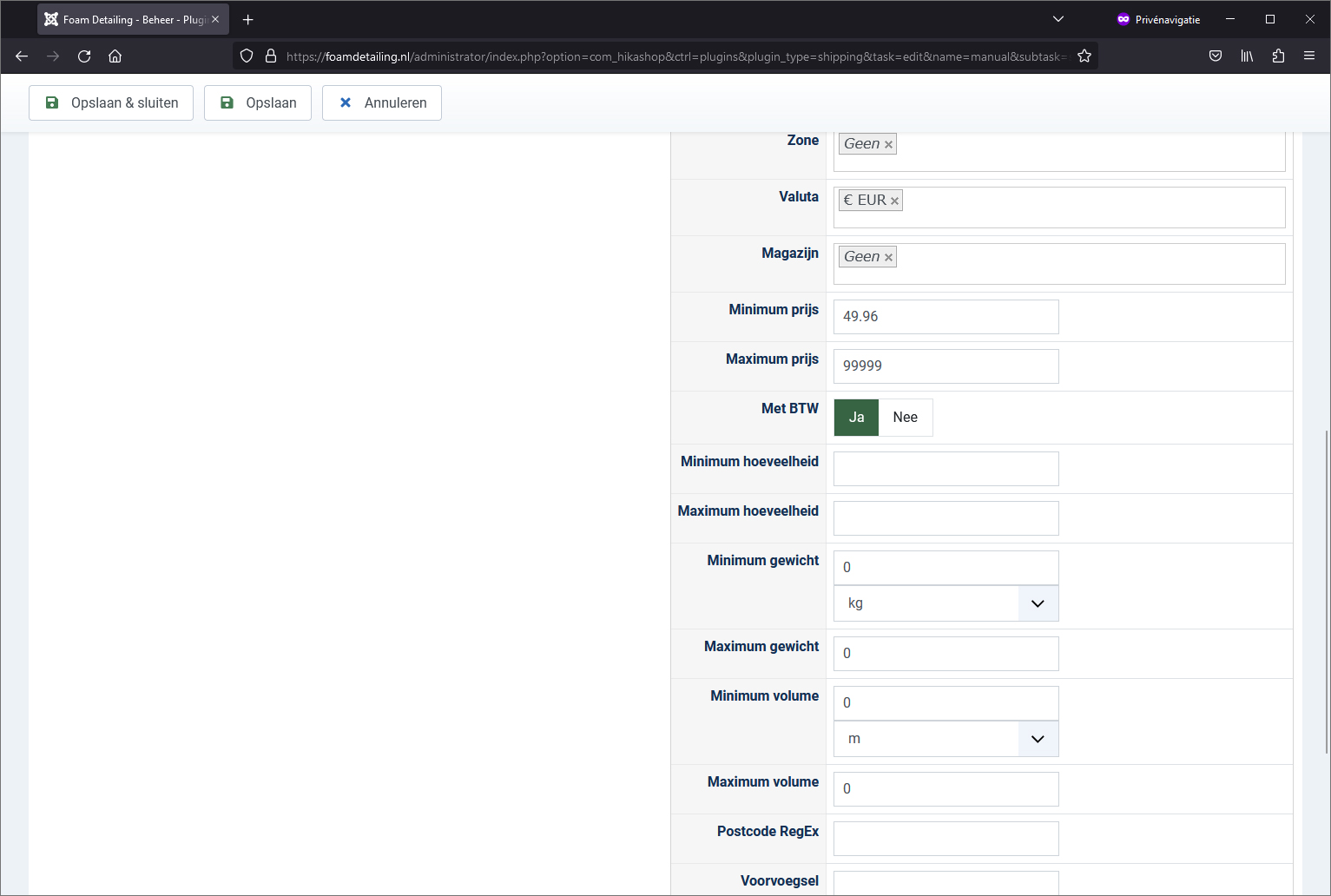

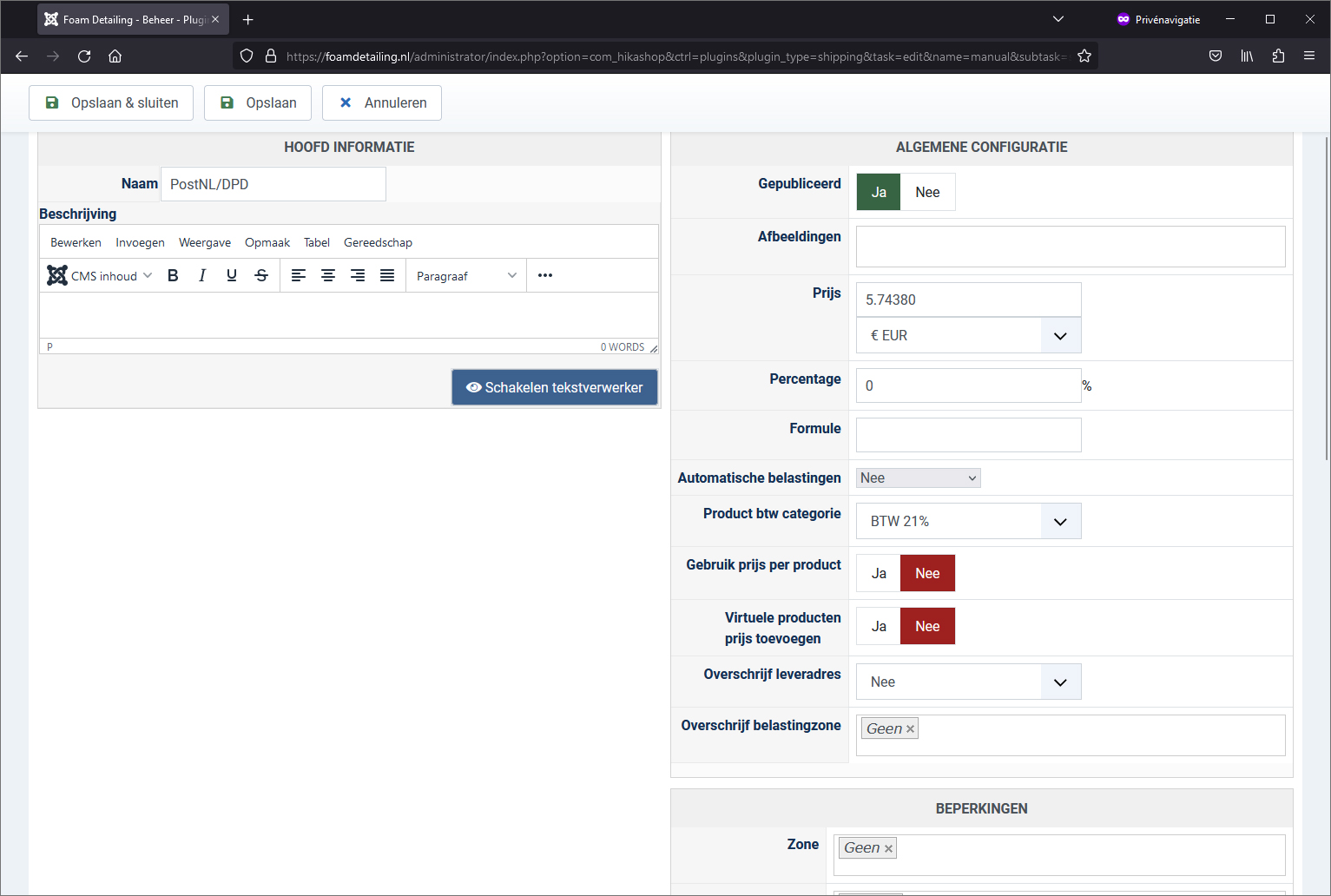

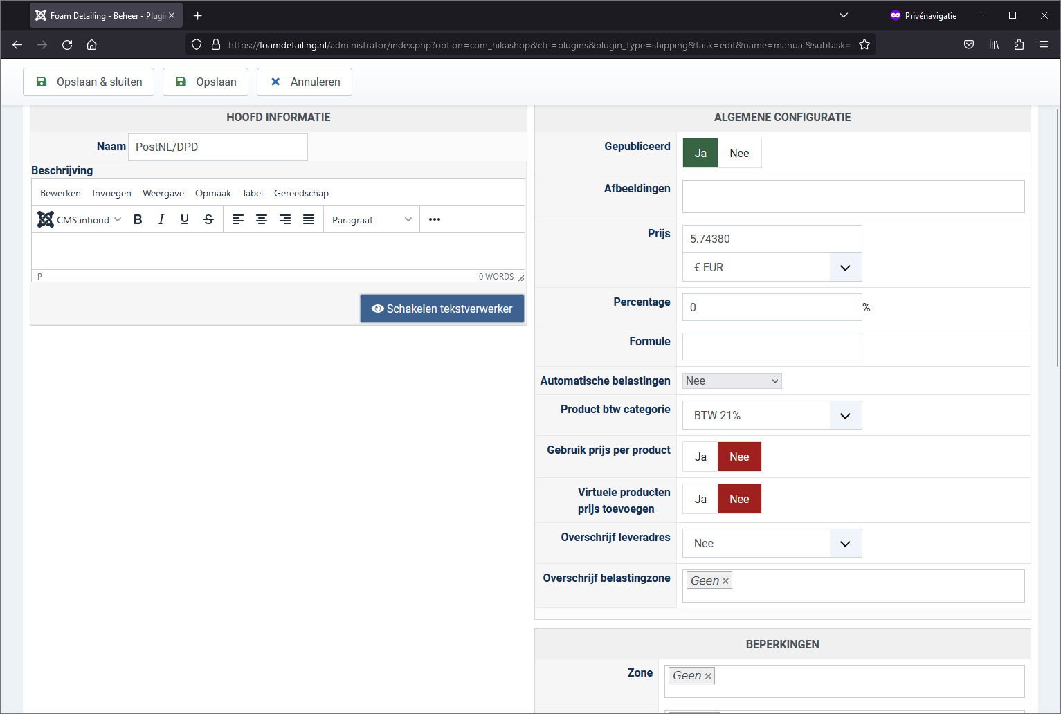

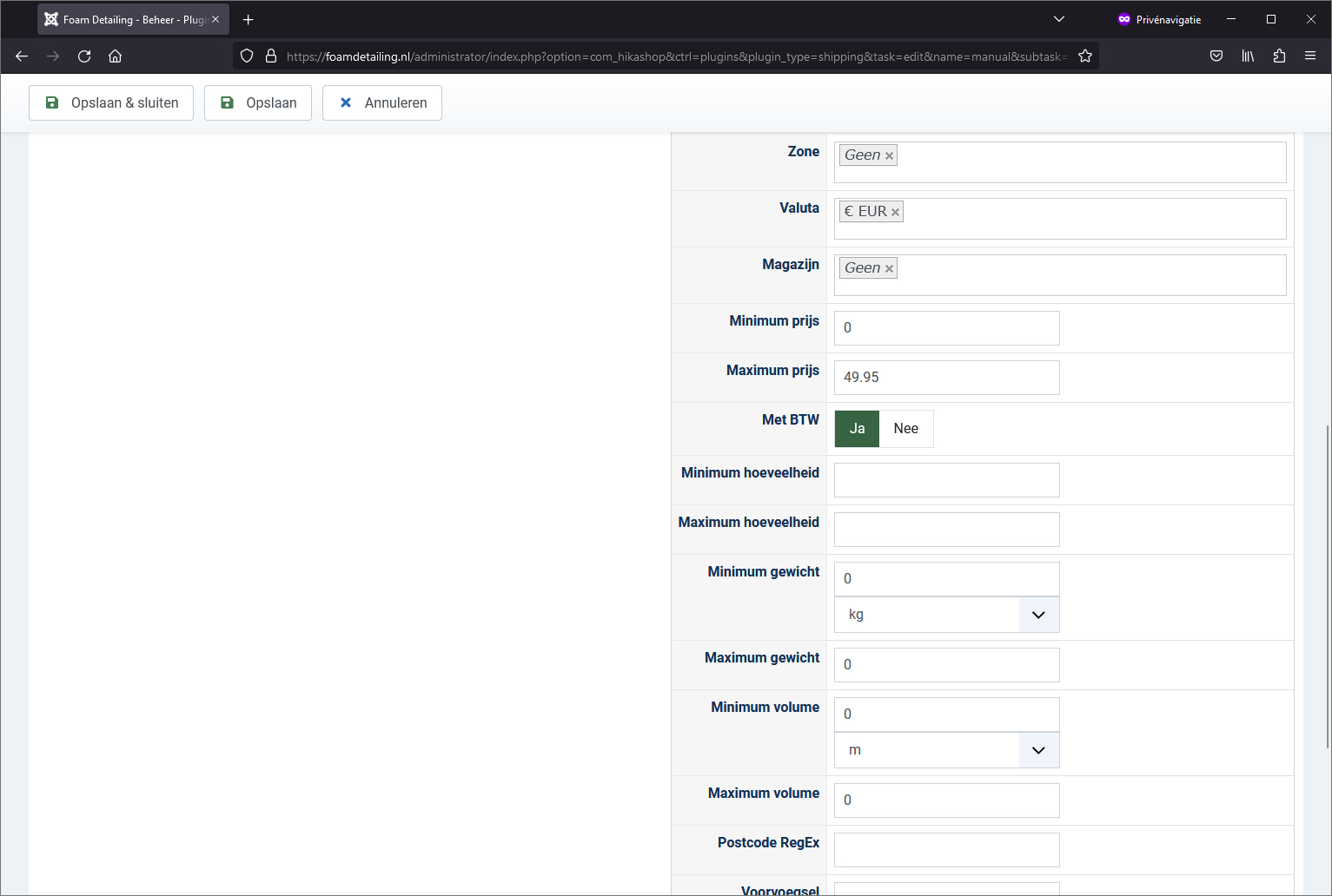

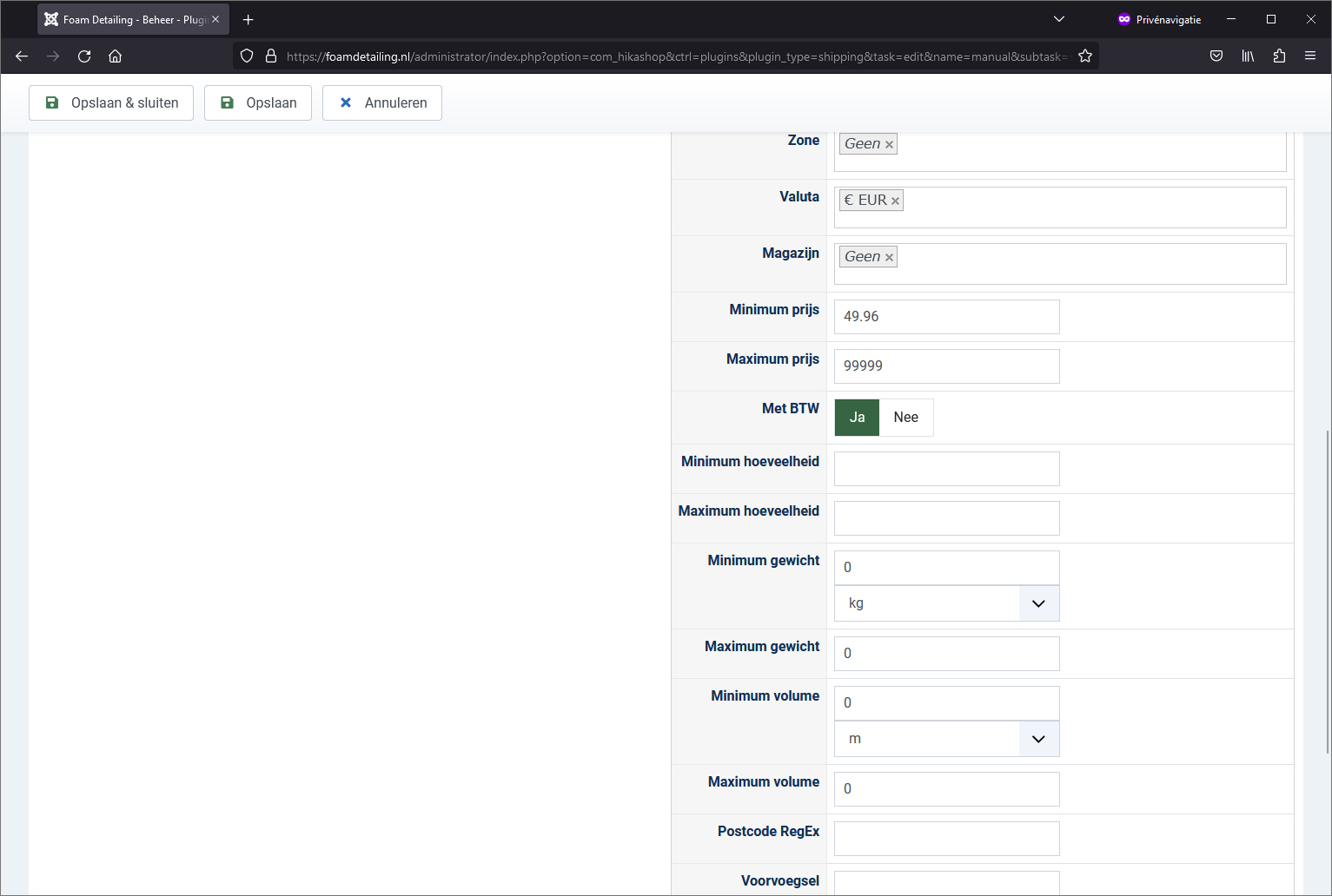

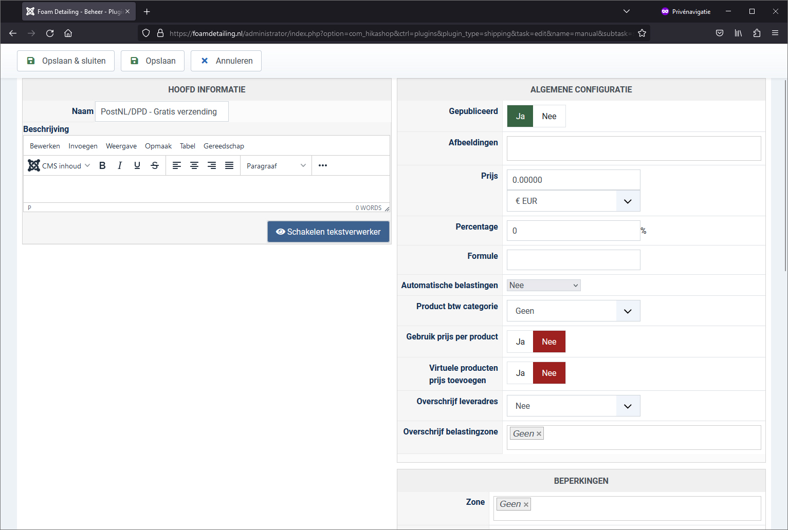

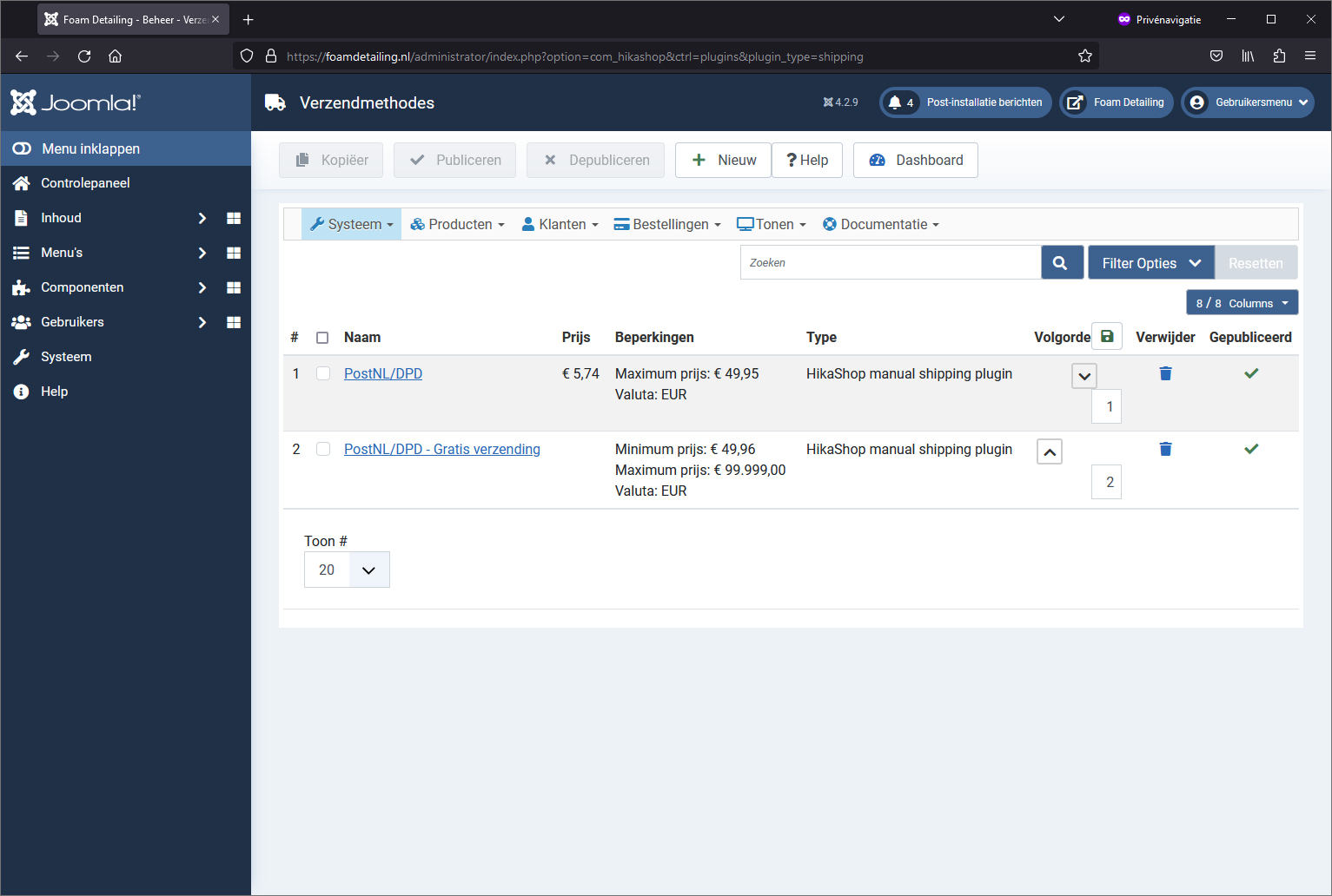

  • Posts: 4
3 years 5 months ago #350181
Hi Philip,

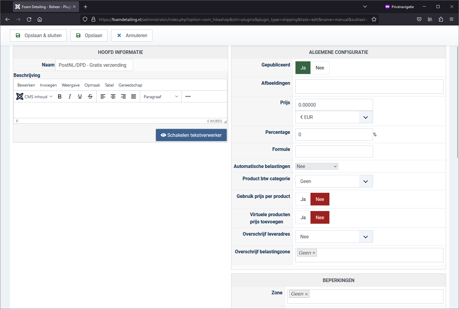

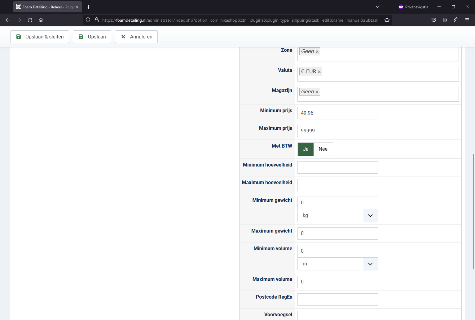

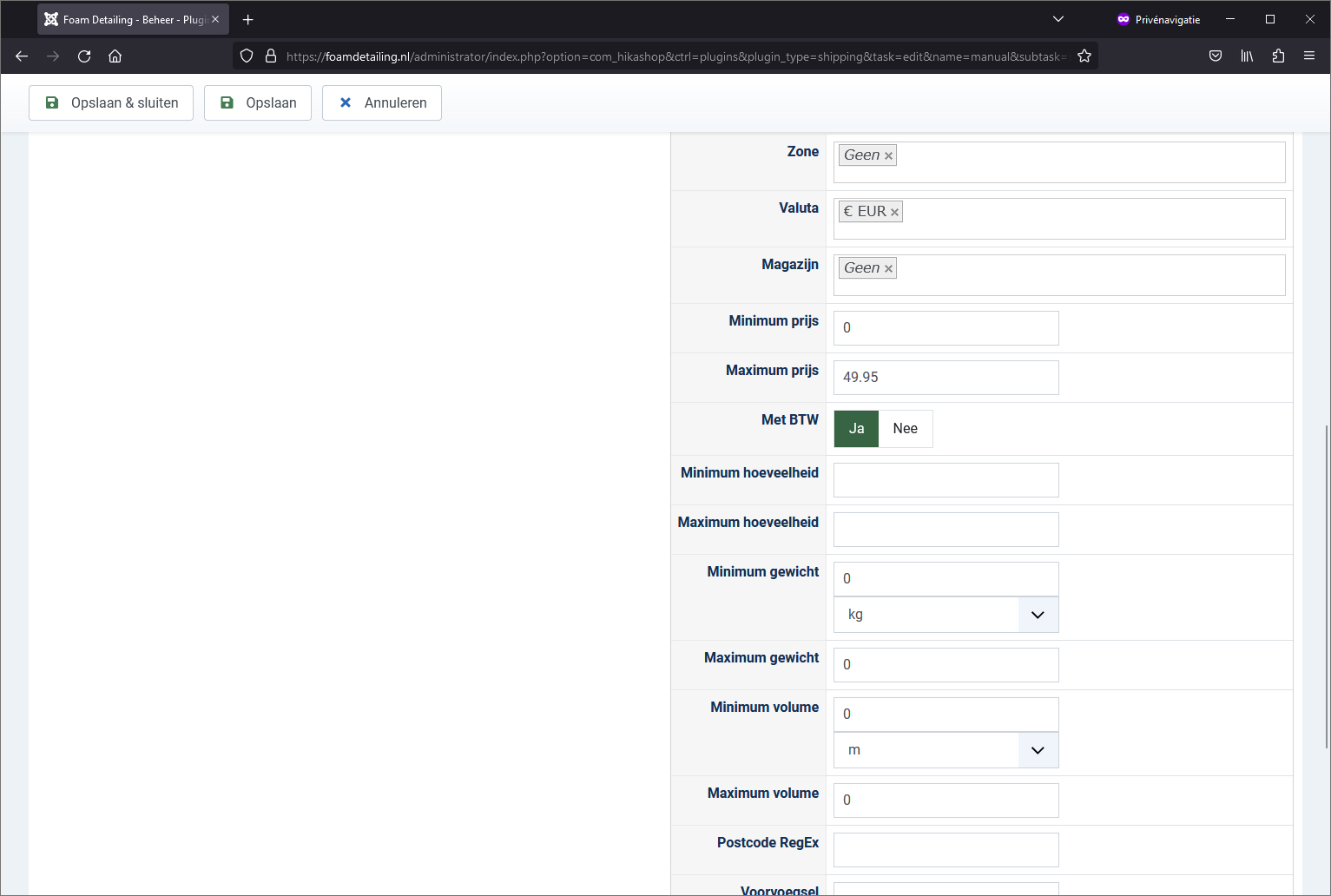

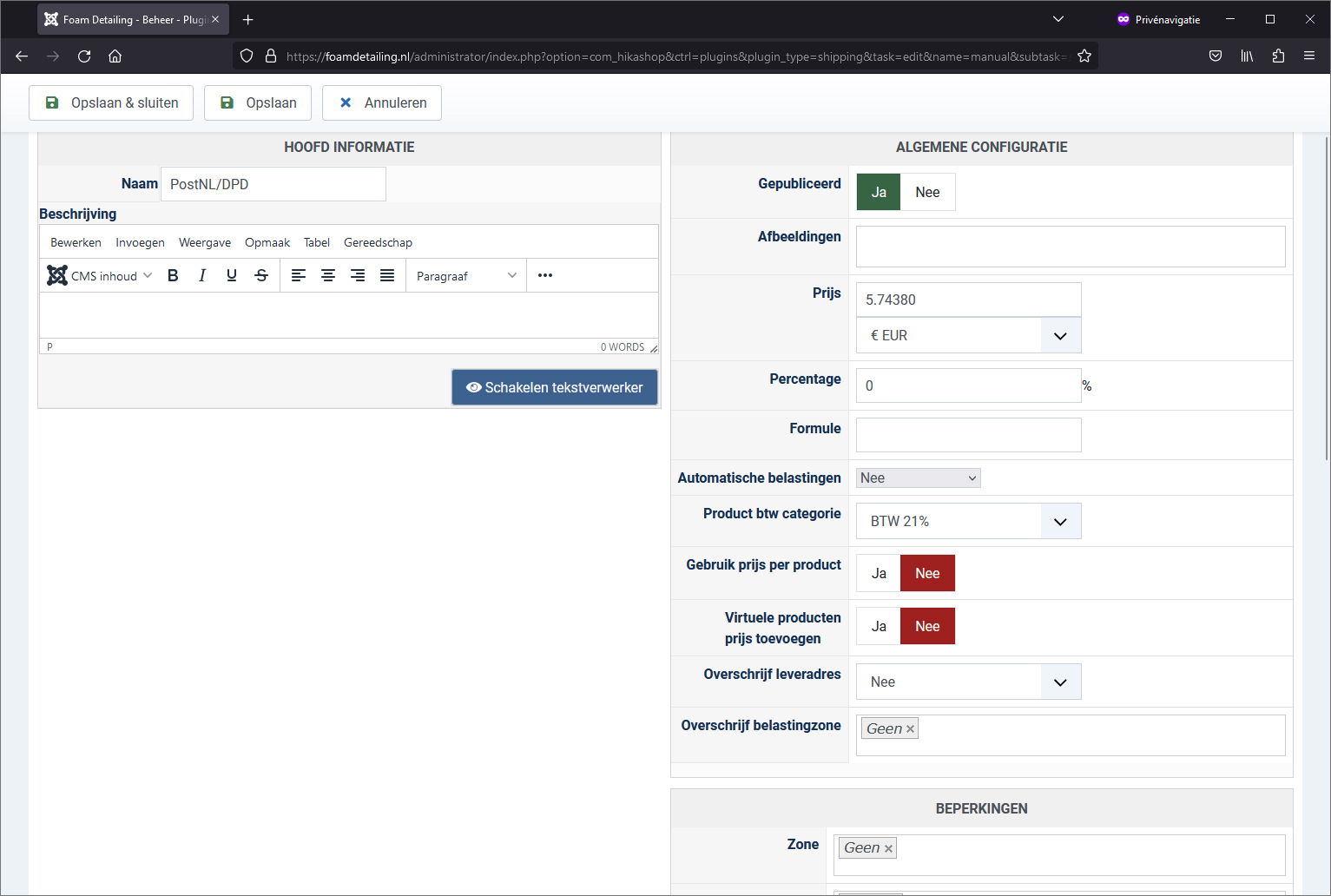

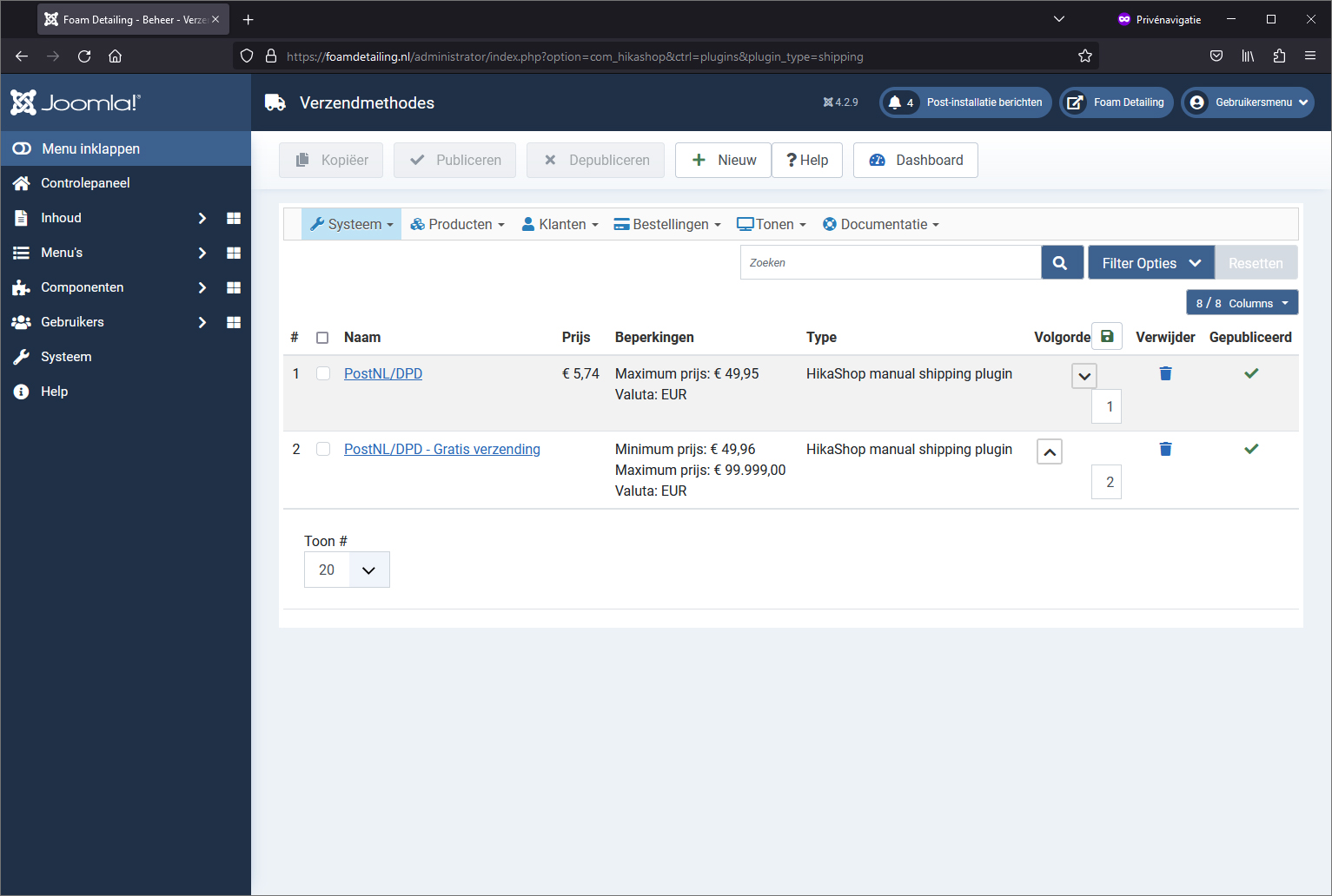

Hereby some printscreens from both shipping methods.
This is the url: foamdetailing.nl/onderhoudsproducten
You can put something in the cart (winkelwagen in Dutch) and see what happens.
Thanks!

  • Posts: 86052
  • Thank you received: 14180
3 years 5 months ago #350204
Your products have a weight of 0, which means they are considered as virtual goods. And in your shipping methods you have the "Include virtual products price" setting turned off, which means virtual goods are ignored for the min/max settings.
You want to turn on that setting in your shipping methods or set a weight in your products.
  • Posts: 4
3 years 5 months ago #350215
That is the solution! Now it works fine.
I didn’t know about the goods being considered as virtual when weight is 0.
Thanks again!
