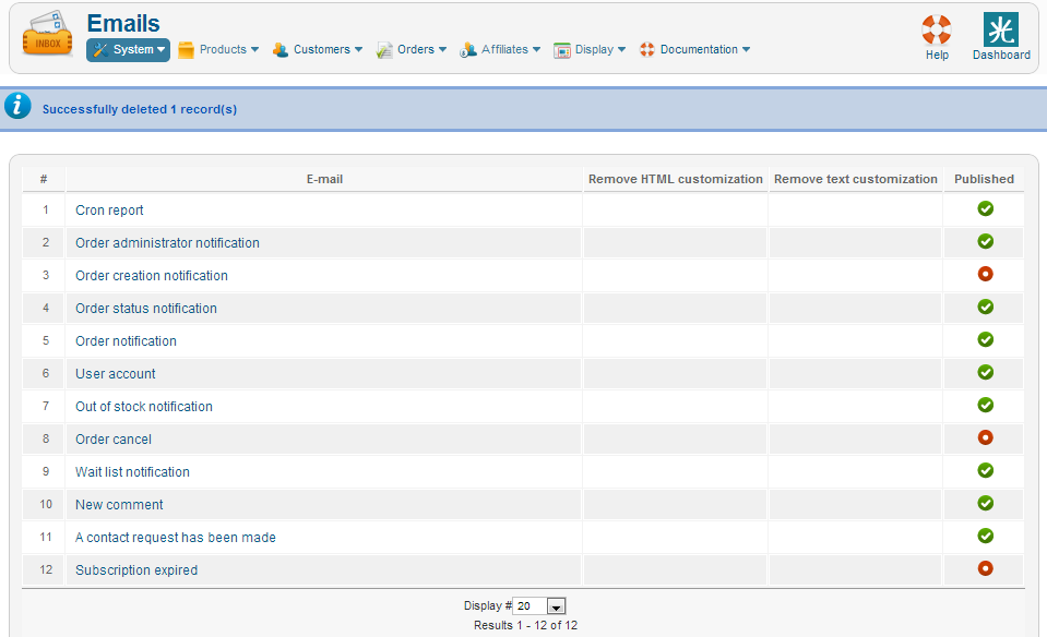

Thank you Jerome. I think I have it set the way I want the emails handled. Here is a screen shot showing that order creation and order status notifications are not published, however I am still getting the order creation email and the order complete email from the site. What am I missing in my configuration?
My goal is to only have an email sent to the administrator when the order status is confirmed and not when it is created.

So you have to unpublish the mail "order administrator notification".
The payment confirmation email is sent by the payment plugin itself.

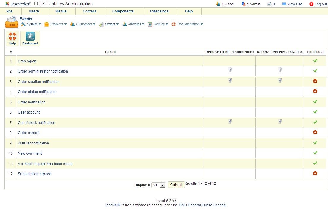

However, the customer doesn't receive any mails (the 2nd you mention), when the payment is accepted and the call-back sets the order in status Confirmed. All silence... And, yes, the Order status notification mail is enabled (see attachment).
If I then manually change the order status (e.g. to Shipped), then the status change email is sent out.
