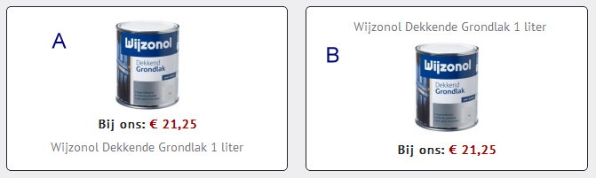

Hi there!
I'm trying without luck to change the layout from the productlisting.
I'm using DIV as the default method to show the products, but I can't seem to change the layout, I would like the following:
- The DIV box hás to be a set height. Now, if the productname gets longer the box resizes and I want continuity in this.
- The name of the product has to be first, then the picture and then add to cart button
- I want to change the text that appears before the price, I added something in the languagefile but that shows everywhere and I only want that on the productpage itselve.
Any help in what file to edit would be great, I'v been searchin in view/product/listing_div, listing and in view/category/listing_div and listing.
Can't find it :(

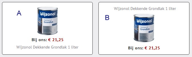

Now, I would really like to know how to make example A into example B...
Proud of my website www.hetcomputerwinkeltje.nl
Currently just running catalog mode, but hope to go live soon again :)
13 years 7 months ago #87778
You have to edit the view "product / listing_img_title" and move the name part before the image part.

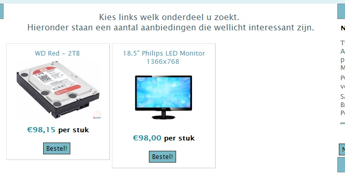

12 years 8 months ago #136225
Great thanx!!
You have an idea for how to get all the containers thesame height? A longer product_name gives 2 lines that makes the container higher than the rest.
Any way I can set it to be 400px standard height?
Thanx!

12 years 8 months ago #136256
You have to set a height on the title part of the divs.
By this way the divs will have the same size.

12 years 8 months ago #137120
Thanx! For me it worked just fine.
I edited the file style_blue.css because I use styles.
Added the code:
height: 265px !important;
to the
.hikashop_subcontainer.
