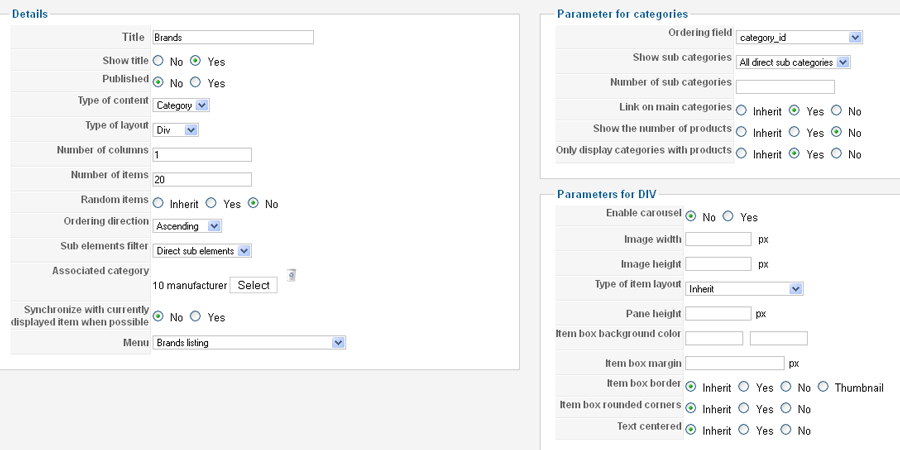

13 years 7 months ago #87650
Please see the attached pic to ensure that the settings are correct because I am still getting the error.
