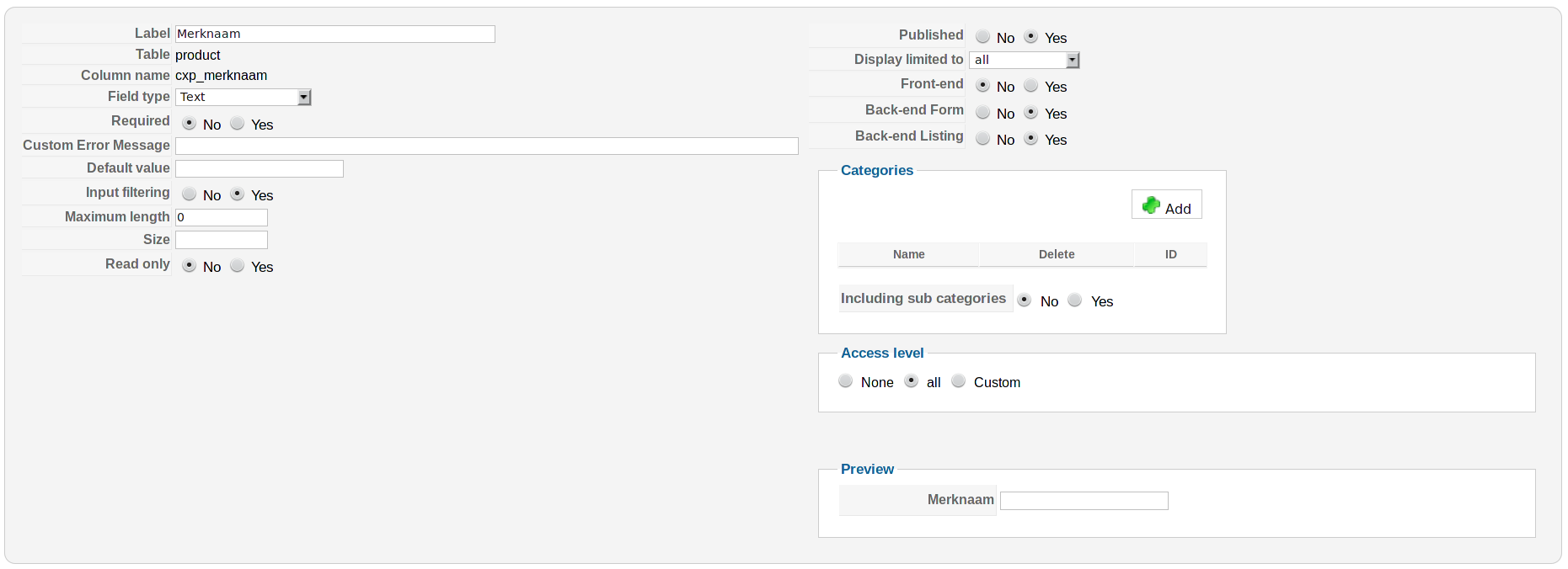

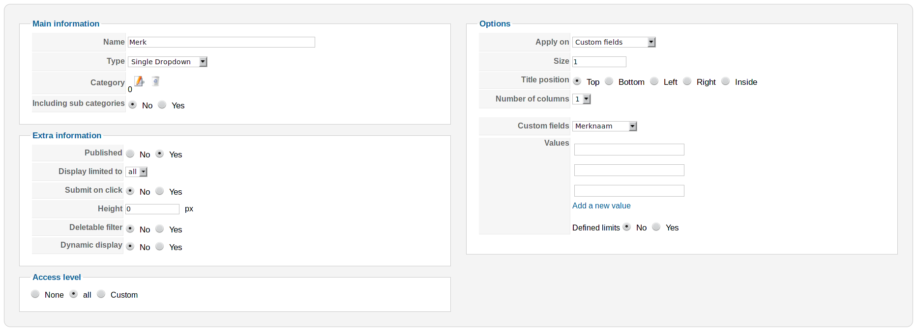

I noticed that the only way I can get the filters to work is when I set the filter type to 'Text'. When I do so, and I put a name in the filter field, the result actually shows only the products with the value I set. But when I choose Single Dropdown, there's no values in the filter. Just 'All'...
The attachments show how I set up the filter(s) and the field(s)
And here's a link to a category on the site: www.cyclexperience.nl/categorie/250-binnenbanden
Thanks!
  • Posts: 86112
  • Thank you received: 14210
13 years 6 months ago #91011
You need to use a custom field of the type "dropdown" or "checkbox" or "radio" or "multiple dropdown".
The filter directly takes its values from the field values. If you don't have any values in the field, which is the case for a field of the type text, you won't get any value in the filter.
  • Posts: 55
13 years 6 months ago #91016
So if I understand correctly, you are saying that the values have to be defined in the field settings and that these settings are used to fill the filters? I actually thought that the filter would be able to read the values we put in the database using a CSV import and show them as options in the filter list. Kind of like the autofilter function in Excel...
Well, if that's not the way it works... Now at least I know what to change to make it work. We'll have to change the script that generates the import csv and I need to create the values I want to look for using the parameters in the fields setup screen... :)
Thanks for explaining! I had no idea...
